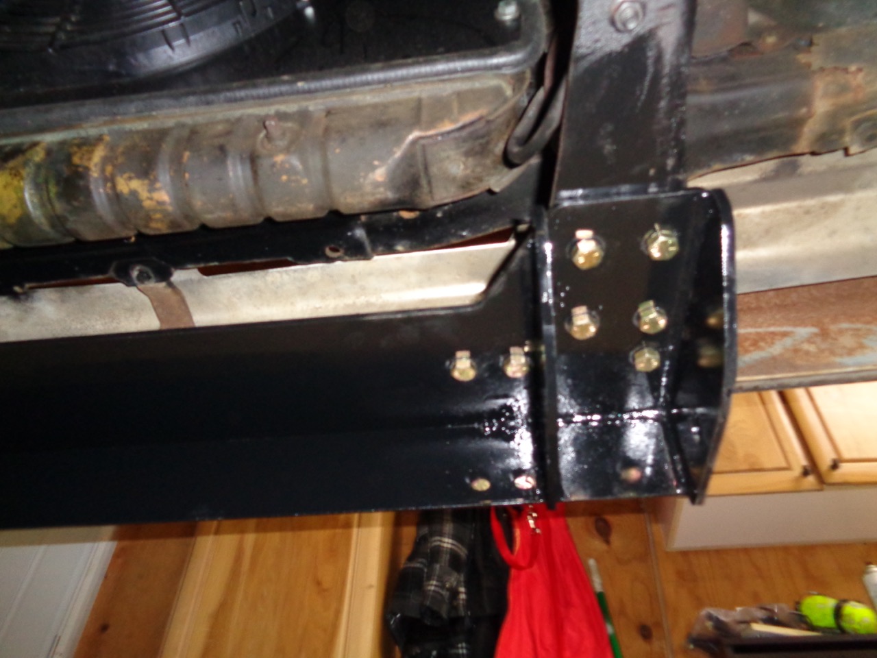

I can fab you up one of these. they are the exact width for dana 44 front axles (at least off of an F250). you would figure out how to attach to frame. I have been wanting to try this out for a 4x4 conversion
Attachment 282032
Attachment 282033
That's interesting. Front leaf spring perches right? Got anymore pictures?

This has a few pictures:
https://www.ebay.com/itm/Ford-Highbo...QAAOSwaSheN3tC
