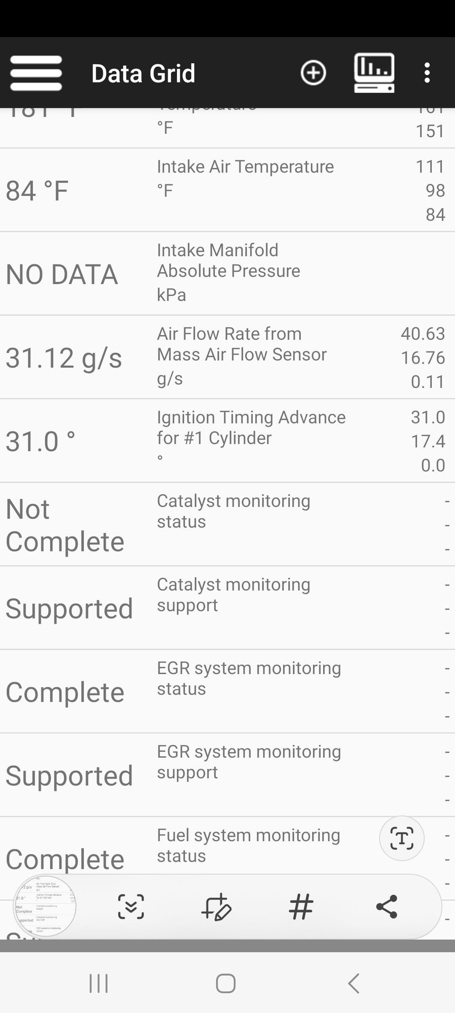

Well, I thought I had this thing fixed...apparently not. I have the P0401 code, I have replaced the EGR valve, EGR vac solenoid, DPFE, EGR tube/hoses from the tube to the DPFE. I am still getting the P0401 code, as well as high negative fuel trims (photo attached). Anyone have any ideas? Thanks in advance.

Well, I switched out the DPFE with a brand new one from Oreillys, all it did was take the code out of "pending". Could the MAF be bad? It's reading around 7+ at idle...that's a little high isn't it? I'm grasping at straws now lol. LT fuel trims are barely better than before, they went from -14 to - 9

7 volts is high for the MAF
With that kind of high MAF number, the processor thinks you are barreling down the road and will open the EGR valve
I was wondering about that, ive cleaned it with MAF cleaner a few times with no change to the number. I have had codes in the past for O2 sensors, so all 4 of those are new as well and operating as they should...switching voltage. The cats are also brand new as of a few weeks ago. The intake manifold is new, EGR valve, EGR vac solenoid, EGR tube, and DPFE are new...and I have replaced the EVAP solenoid (had a code for it), the vaccum lines are new, and PCV valve is new. About the only thing I haven't changed is the MAF sensor.

That MAF reading is at 1500 RPM...i assume thats not good?

Not sure about that MAF reading. Did you open the egr valve while idling to see if the engine responds? What is the DPFE voltage with key on engine off? Does it change with the valve opened while engine is running? Are you sure the hoses are installed on the correct ports? Whats the fuel trims on both banks at idle and 2500 rpm?

The P0401 code is gone, it's not even pending anymore...all I have now is negative fuel trims at idle. They get better when throttle is applied, always a new problem. 🤬
