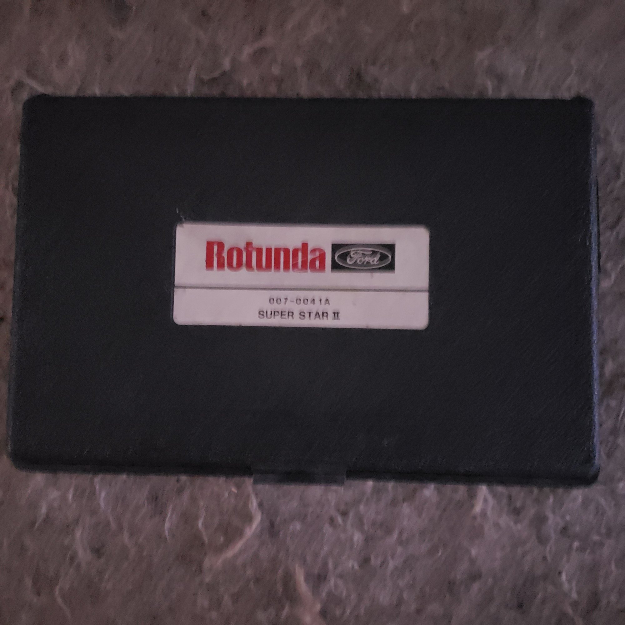

You can still find Super Star II's on ebay
Hell, I will sell mine someday
This is what you want
That thing looks pretty slick!

Well, it's plug and play
And it's Fords way of pulling codes
Follow the instructions and away you go
Good luck
Your reader is going to work (most likely) and the trouble comes (even for me) (after all these years)(is operator error)
You have to have the clutch depressed on the manuals and other parameters sometimes must be met, or codes for your mistakes will follow
The goose test is sometimes hard to did with the aftermarket obd1 scanners

I looked on Ebay and I only saw one Star II that was for sale and it was 320.00 used. The INNOVA for the ford is about 33.00. What does the Star II do for that price that the Innova doesn't do. I'm all for better tools but the difference is significant and I don't know if is justified. Clue me in on the benefits over the Innova. Thanks

Just keep looking, that guy must think his is gold or something
Not sure what all the superstar does that yours does not
I got mine exclusively for Lincoln air ride systems and my NGS does all my powertrain stuff
I bought mine from a fellow ford tech for 40 bucks
Keep looking and at yard sales etc.
