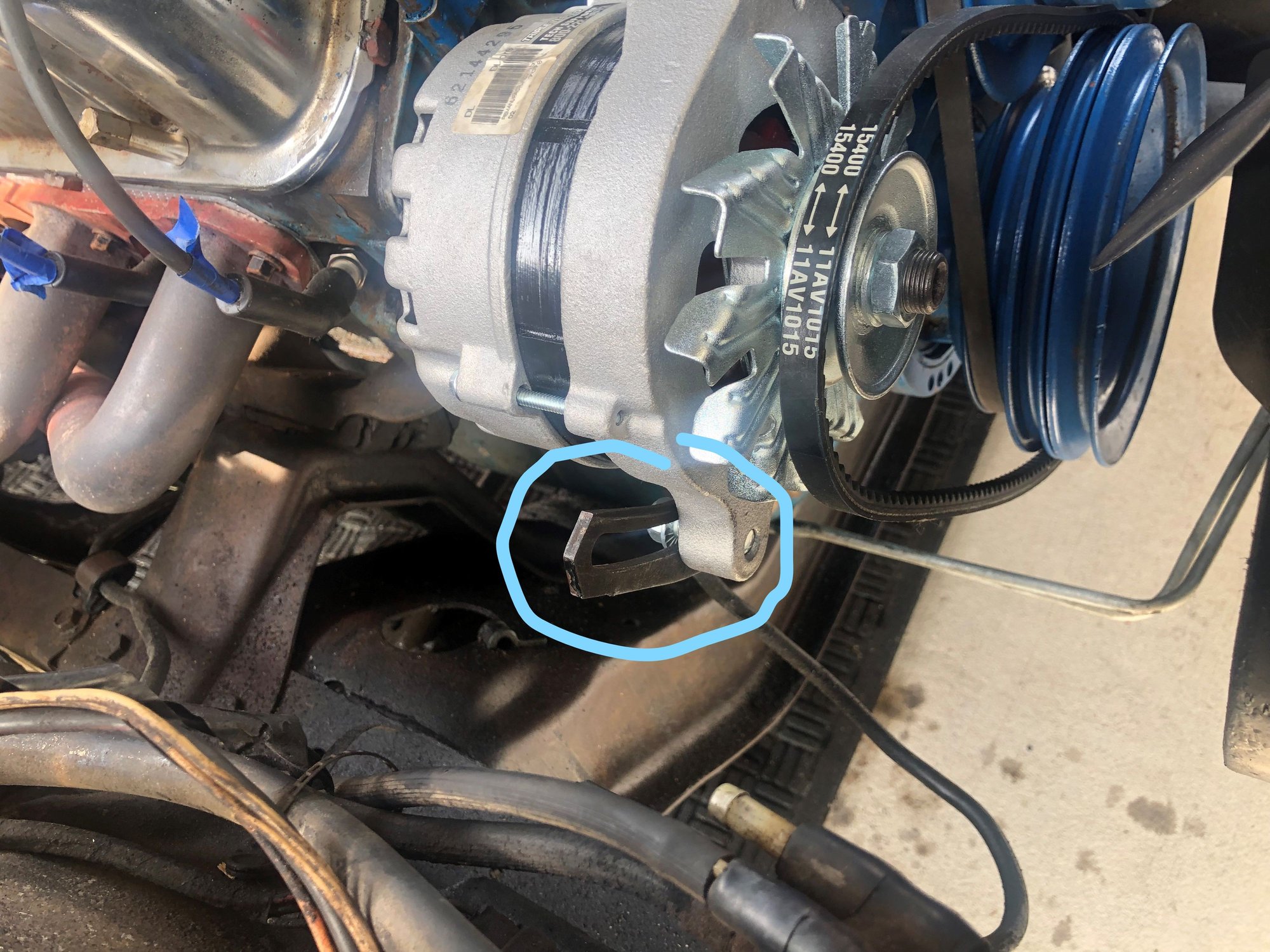

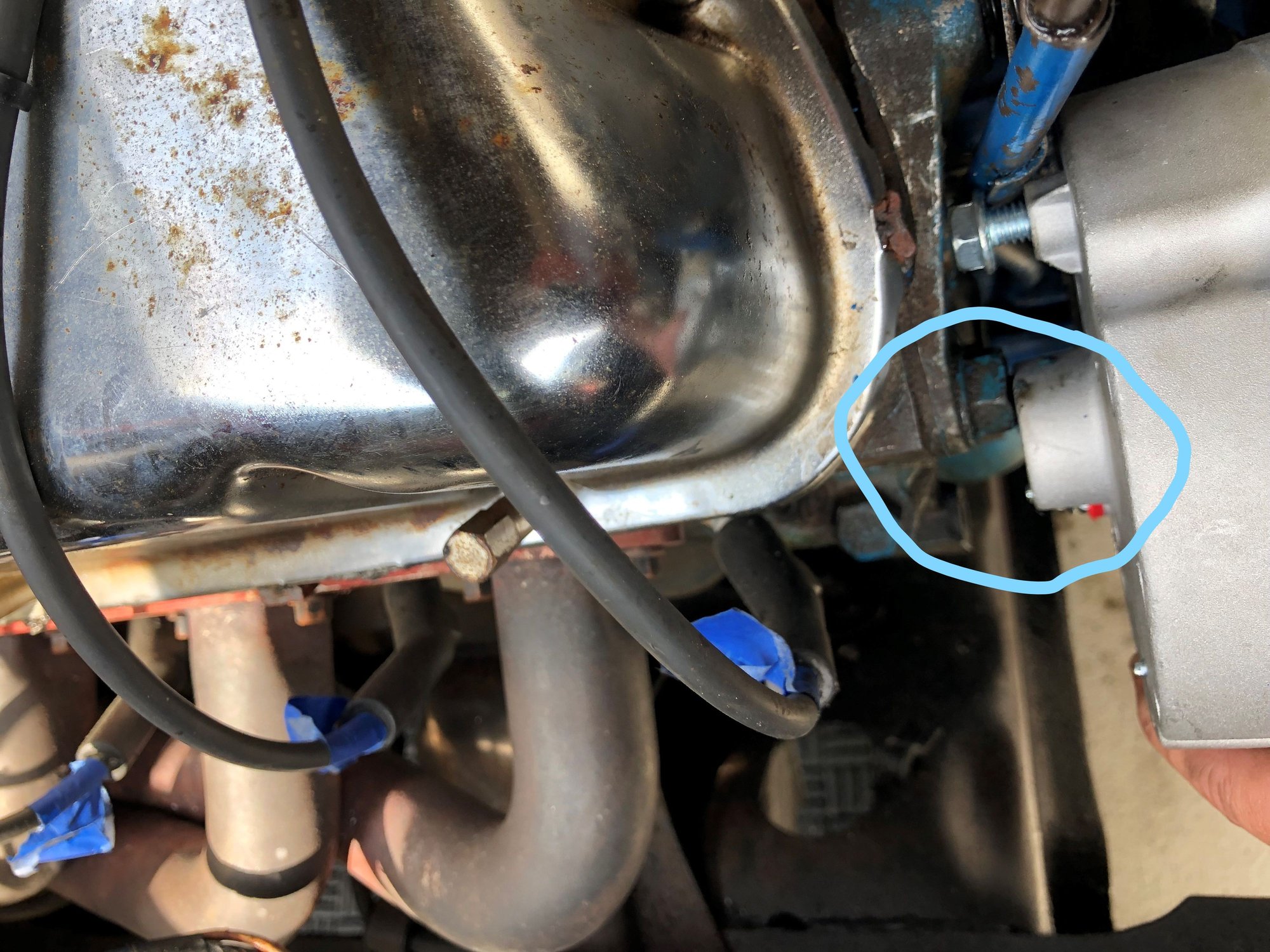

So I ordered a 1 wire alternator from jegs and went to install it and ran into these 2 fitment problems
1--the oil dipstick tube hitting the ground bolt keeps the bolt from lining up properly with the block
2--Even if that was not an issue the back of the alternator actually hits the bolt on th ehead behind it.
Is there a way around these issues, or is there a specific 1 wire alternator that has better dimensions?..Pics attached

Where is your spacer for top bolt. Any reason for 1 wire? Not a fan of them myself, but each to his own.

I left the spacer out of the picture to better see the issue.
I have been having some charging issues and wanted to run a higher amp alternator because I have an amp and just seemed cleaner.
I went a got a new voltage regulator today to see if that helps my chargning problem wiht the regular alternator

When I put one on one if my FEs i had to buy a bracket to relocate it to under the head, I don’t remember where I got it but shouldn’t be hard to find. Some vehicles had it there from the factory. I have a 76 truck that had the alternator mounted on the underside also.
i personally like the one wire, easy way to up the amperage from like 45 or whatever the 1g was, and you really don’t even need to rewire anything. I think I just hooked the stock battery wire that normally goes to the external regulator to the terminal on the one wire alternator’s

Put in new regulator and reinstalled the alternator I got from Autozone a month ago(I still have the original Motorcraft that died also) and not even getting 12v to the battery when lights and/or stereo is on..only 12.2 without anything running right off the positive terminal from alternator.
On a related note does this bottom bracket look right? I would expect it go in front of the alternator not behind it.

If belts lined up and nothing twisted should be ok.

The belt lines up about 90%...100% depending on the angle you look at it. LOL

it will start smoking if it’s not, I had this similar issue. The 1 wire I bought had two different size spacers for it I think

This alternator pictured isn't the 1 wire...it is the older model
