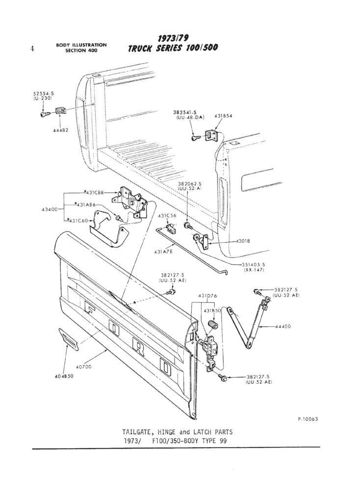

My question is a simple one. Pivot points. On the newer trucks they have plastic or nylon inserts. Did the older trucks use them. I have not seen any with them and don’t see them offered in diagrams. Guess they didn’t use them but trying to verify.

No, originals did not use inserts, just smooth round surfaces, and grease didn't hurt.

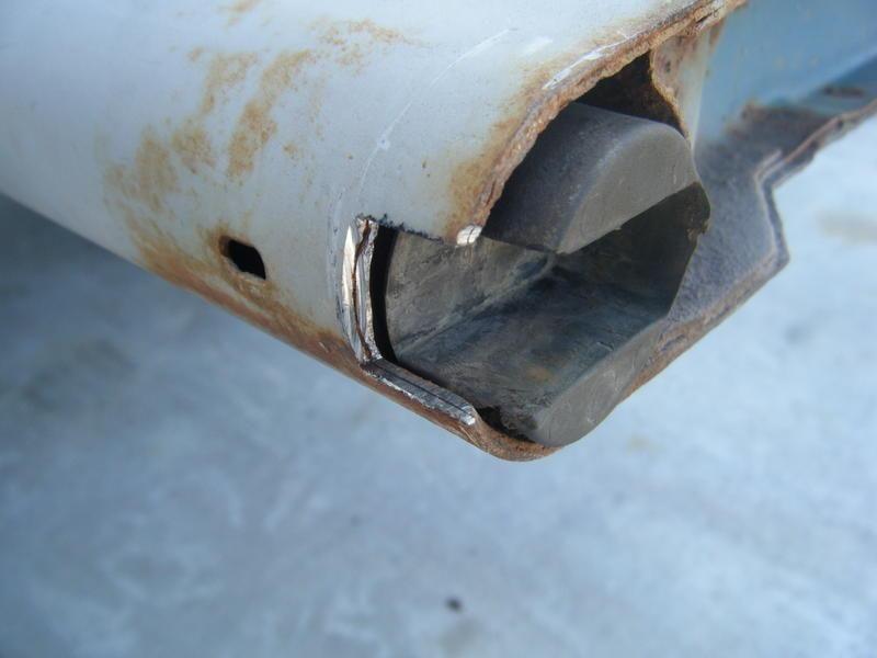

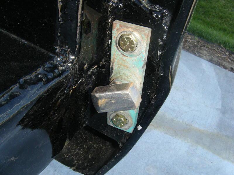

No plastic from the factory, just steel on steel. You also notice you DO NOT have a alignment slot to quick remove a TG.
Here is a way to use a plastic insert. If you modify your TG to be a quick removal item.

If memory serves... The tailgate pivots from 1980-1996 have the quick removal option and would bolt in place of the 1973-1979 pivots, and you would only need the one pivot side for removal.

To further this tailgate info dump: There was an aftermarket tailgate helper "spring" that you could add to your 1973-1979 tailgate to make closing it feel lighter and less heavy, it would "install" inside the tailgate and IIRC under the bed or in the bed tailgate post?
