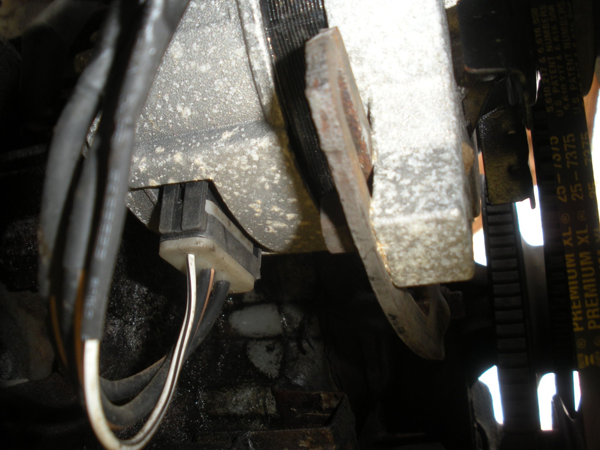

FWIW, recently I had to replace the Alt on my 86' 302EFI. The newer replacement has a different connector that eliminates the issue. That was easy. The old guys at the local auto parts store, changed over the pulley from the old to the new ALT.
Here's the new one.
Here's the old one.

Don't forget to get a 3 wire connector for the voltage regulator. Feel free to try the original 2 wire connector, I did and it didn't charge. Just trying to save you a trip back to the auto parts store.

Thanks for replying. Do you remember the brand? I had a new one in the garage but ended up selling it to a guy at work because it was the same as my original. I can definitely see the difference at the connector on the one you have.

I looked on line to the local auto parts stores around me. Napa didn't have any. Advance could test mine, but told me to go to the Carquest down the street to get the one I needed. That Carquest is now a NAPA. I do know that Carquest store had been in that spot for decades, going back to the 1970's.
