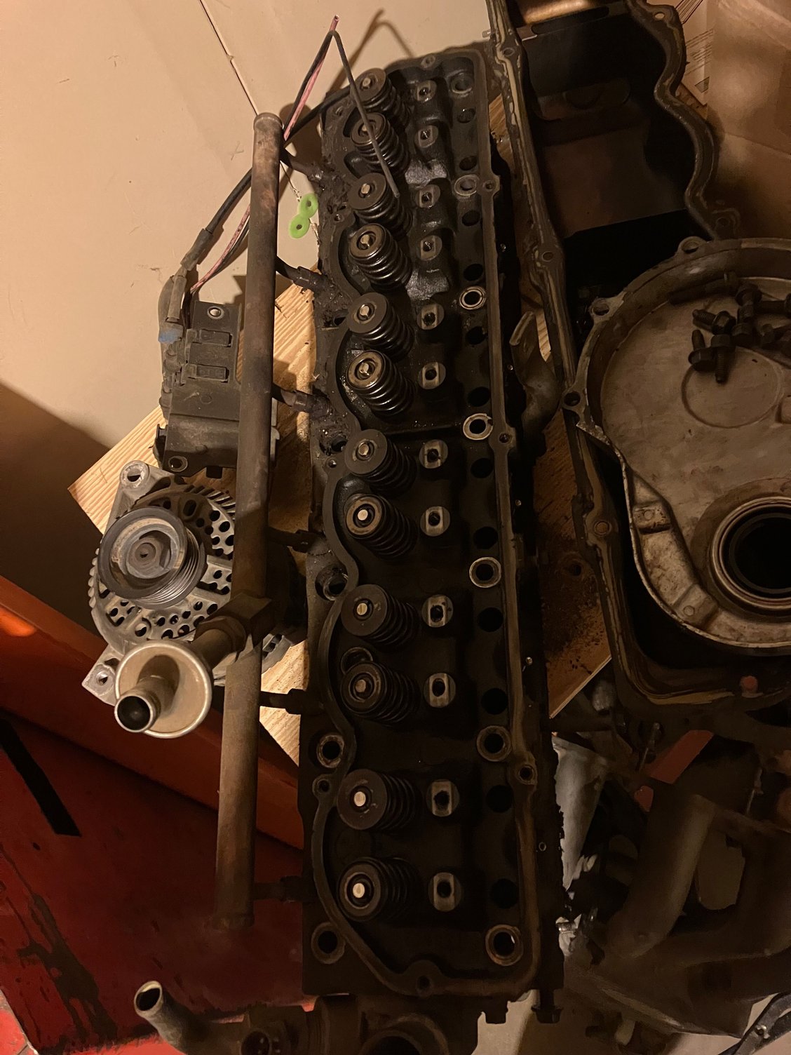

hi Im working on a 95 300 I6. i've got it pulled out and pulled apart, theres a rail attached to the head, its not the fuel rail, i don't think, almost every port where it threads onto the head is cracked. I'll try and upload a picture but you never know.

I believe that's the rail for the air pump. Do you mean the head is cracked, or the rail is cracked? The small tubes are pressed into the larger tube, one of them fell out when I removed that assembly from my head.

the fittings where it threads into the head are cracked, i believe its the rail not the head.

They make fancy plugs with the proper threads on them but if you already have the head off you can just drill and tap and run NPT plugs since the hole is already nearly the right size.

so i dont need the rail to be on there when it goes back in?

Does your state have visual emissions inspections?
If not you don't need the air injection system.

no, im in wyoming, we dont have anything like that. thank god. what else goes into deleting this or is this it?

Remove rail. plug holes. Buy a shorter serpentine belt and skip the air pump when you route it.
The new belt is part number 800k6 or equivalent.
