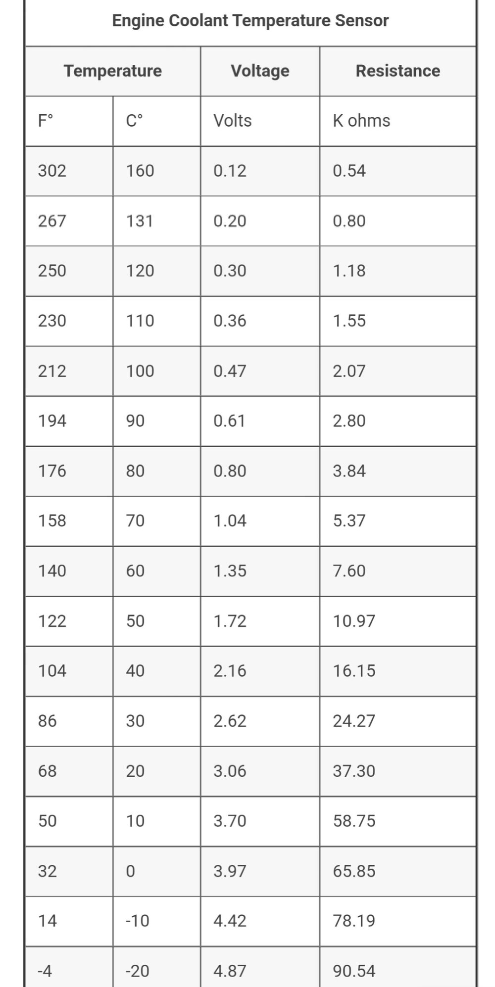

Next thing you should do is check your ECT sensor with a multimeter and see if it falls in the resistance range for the engine temperature. I like to check it when the engine is cold and when it's hot or causing problems. Here is the resistance table. If you need more help with testing the ECT sensor, just ask.

I've got an obd1 reader but im getting the all pass code from it. I can check that sensor but im not sure why that sensor would cause the truck to shut itself off while I'm driving down the road. It's shut itself off and then fired back up almost instantly. Could those symptoms still be that sensor. Also this has been a gradual problem sometimes taking hours to happen but now it's about 10 minutes at an idle
