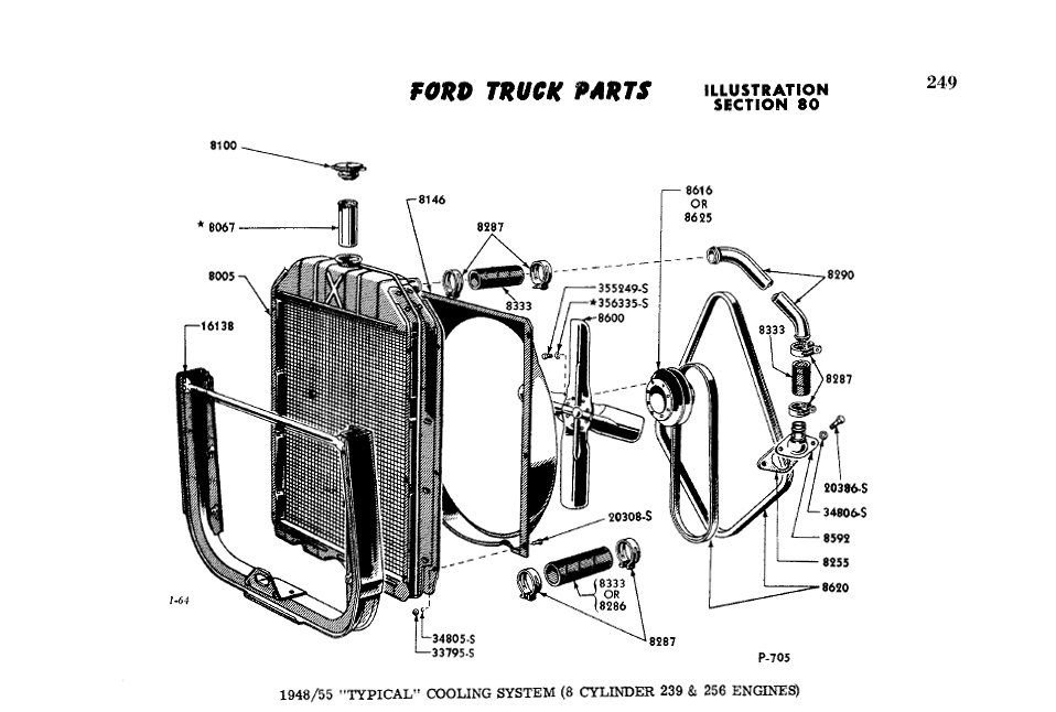

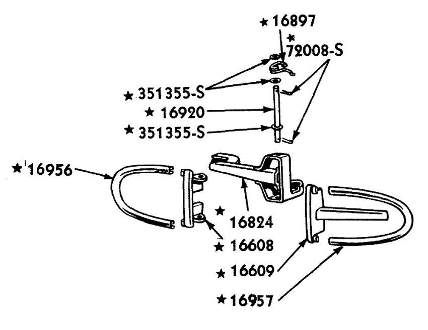

You may want to reference the first two PDFs on this site for exploded diagrams and parts: https://charpindustries.com/diagrams/

It's worth it to order every free parts catalog that you can; LMC, etc. Most of them have decent parts diagrams in them
This might help a bit
