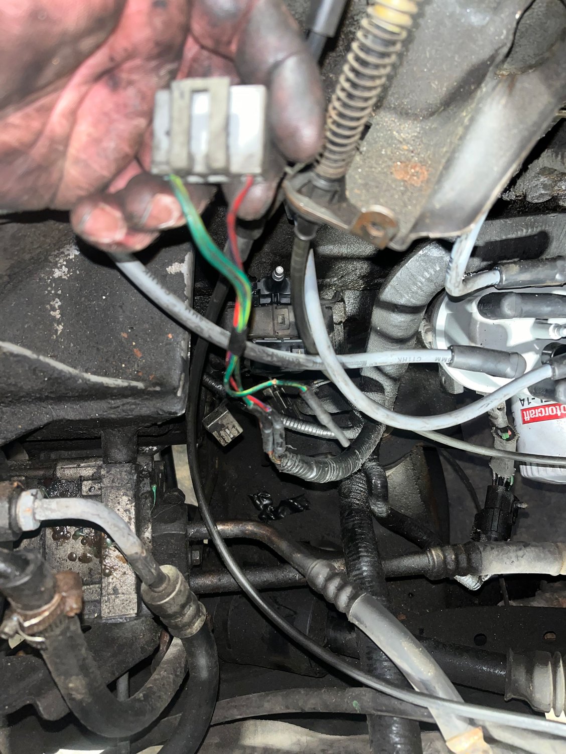

There are 3 wires that connect to the coil plug, but only 2 seem to go anywhere. One of the green wires is just sitting there. Where is this supposed to go? If that wire has a purpose this could be the root of my problems, or atleast most of them

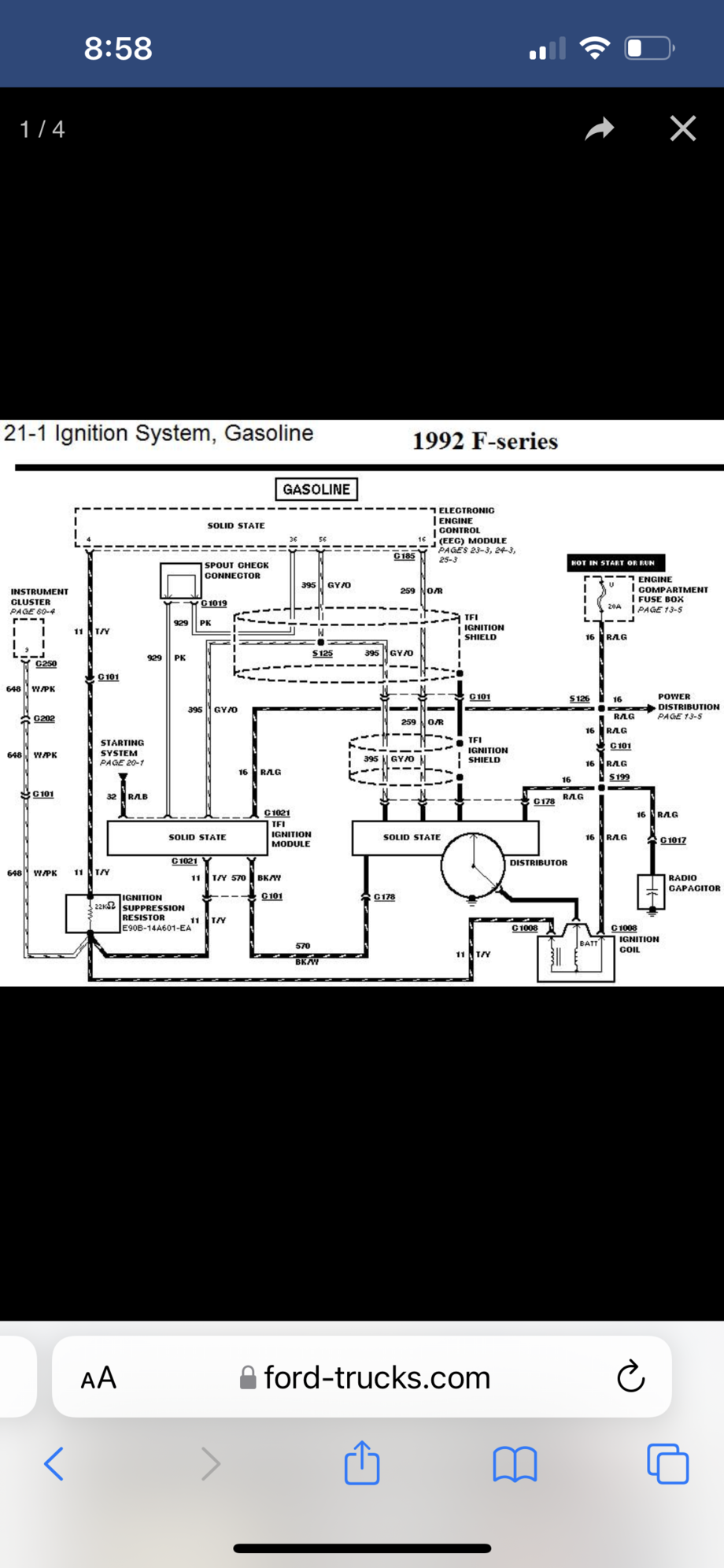

This diagram only shows 2 wires leaving the coil plug/harness. I guess that extra wire i see doesnt do anything? Seems kind of silly. It sure looks like it used to be connected to something. Theres also alot of these replacement harnesses out there so i guess these plastic plugs break sometimes.

I think that is supposed to go to a noise suppressor.

For the radio. It's in the schematic you posted.
