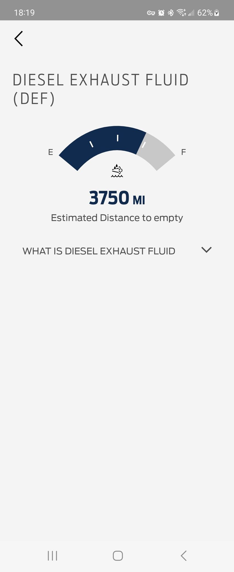

So I've noticed the DEF gauge over the last couple thousand miles is all over the place. I have had no errors or codes, no performance issues I'm aware of. Only thing that has changes is extended idle time (cold weather wamups) but my DEF gauge has been reading as low as 2,500 miles, and as high as 7,500. Previously it would top out at 6,500 and fall consistently with each DPF cycle, roughly 500 miles every 500 miles. Just this week it went from 3,000 to now 7,500 while reading just over a quarter tank. I had it filled roughly 2,000 miles ago on the las toil change and it should be at or just below the 3/4 mark of DEF.
Is this a precursor to something going bad in the DEF system? If anything the truck is working harder right now, between towing my enclosed trailer, plowing, and higher idle times. It should be using more DEF, not less, right???

You are over thinking this. Just drive and when it gets low fill it. Or if you know you are going to tow for a distance. Top it off before you go.
DEF is used to reduce NOx. NOx is produced by High EFT temps. You putt putt around town empty, and your EGTs will be 500° and no DEF will be consumed. You tow 13,000ls up a 7% grade and your EGTs will be 900° and you will consume DEF.
Add in Cold winter weather where you DEF might Freeze. It basically shuts off the DEF system until you reductant heater thaws it out and your distance per tank can be increased. Doesn't mean it stopped working. It is doing exactly what it was designed to do in the cold.
On my 2020 truck. 70 mph on the freeway, my EGTS are 490-520° You just are not getting hot enough EGTs to make NOx and won't be consuming DEF.
If you don't have gauges to show your EGT's. Think of it this way. Unless you've got substantial turbo boost, you don't have NOx

Get an iDash and set it up and never worry about it again. Just watch the DEF level and fill when it gets low.

Way over thinking this def stuff. Run it down to <200 to empty. Fill it full and drive on.
Newer trucks consume more than older trucks. So when I tow I switch gauges from boost to def. and then monitor it.

Another couple hundred miles and another warm day. This thing really is all over the place.

The gauge level barely moved, only the estimated distance to empty has adapted to your current driving/towing habits. Makes sense if you are towing heavy enclosed trailer + plow work.

Literally only a couple hundred miles, and no plowing or towing in that range. Normal (non-interstate) highway driving to/from work.

Are you in a cold climate? DEF freezes at 12 degrees F. Mine has been doing the same thing when it gets cold. I know there is a DEF heater on the truck but I am not sure if it is on when the truck is sitting. I know that I took a 350 mile trip in the cold and when I started the trip DEF was at 1/4 tank and when I ended it read almost full. (I filled the DEF before I left). Truck is at the dealer right now and they are looking into it. I am not sure that they know how the system heater works.
