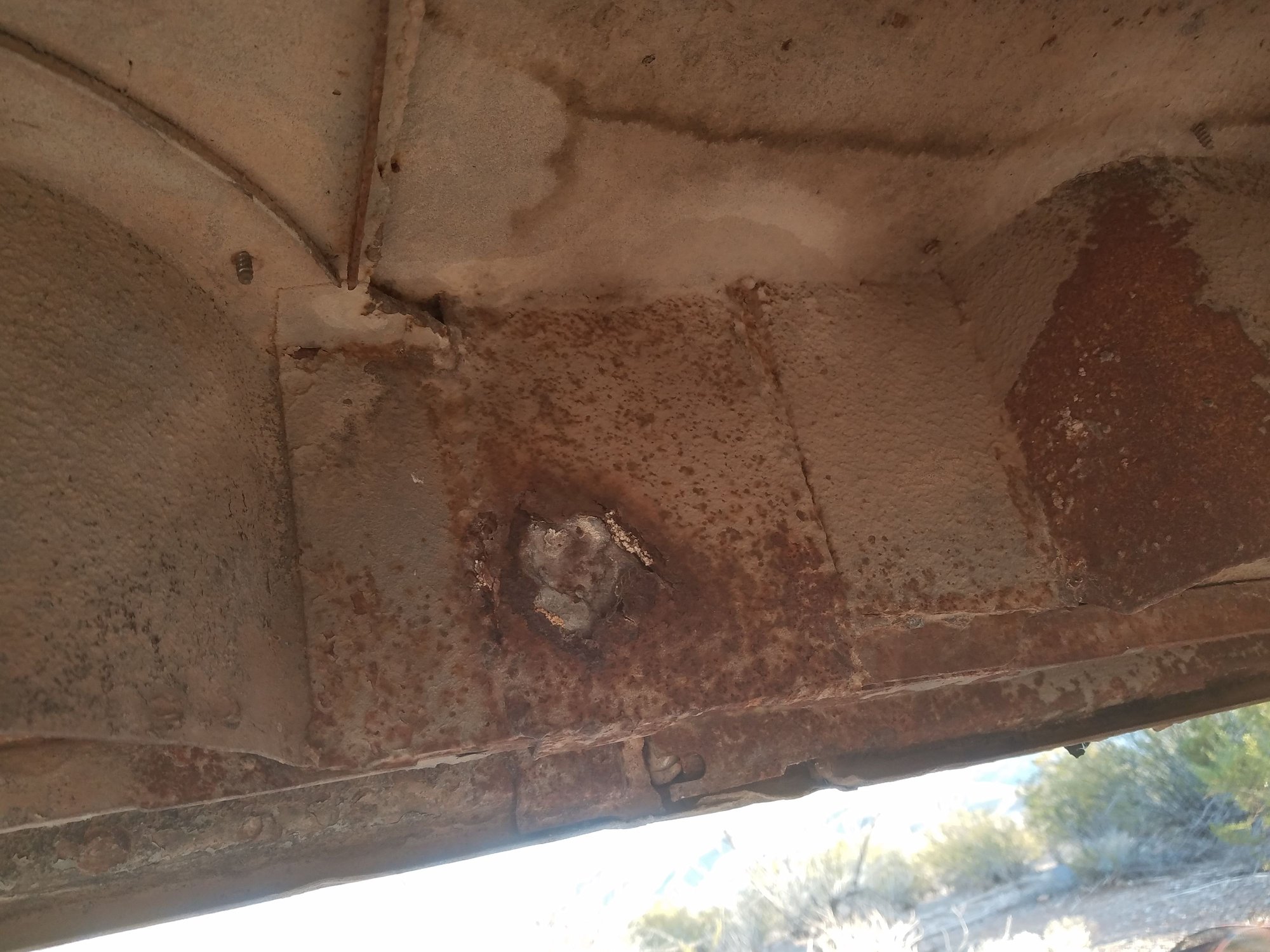

Rear Leaf Springs are bolted to the frame, not riveted, plus extra holes in frame in front of rear leaf springs.
Middle cab mount. 53-56 F100 cab mount used, also used on rer cab mount.
Here is the double steel plate covering the welded line between the frame, just aft of the front wheel door well and the start of the 2nd door well area.
Just crawled under the truck, the frame is 7 inches high under the cabs, 6 inches in the front bumper section and after looking closer, i can see where they added a doubler plate to the frame where the 2 cabs are joined and i can see a thin welded line in that area, it is covered under the doubler plate. So look like the stock frame was stretched, but some weird items, the axles are 5x5 not the heavier 8 bolt, and the center & rear cab mounts are from the 53-56 cab mounts.and the rear leaf springs are bolted on vice a round head rivet like the front springs.
