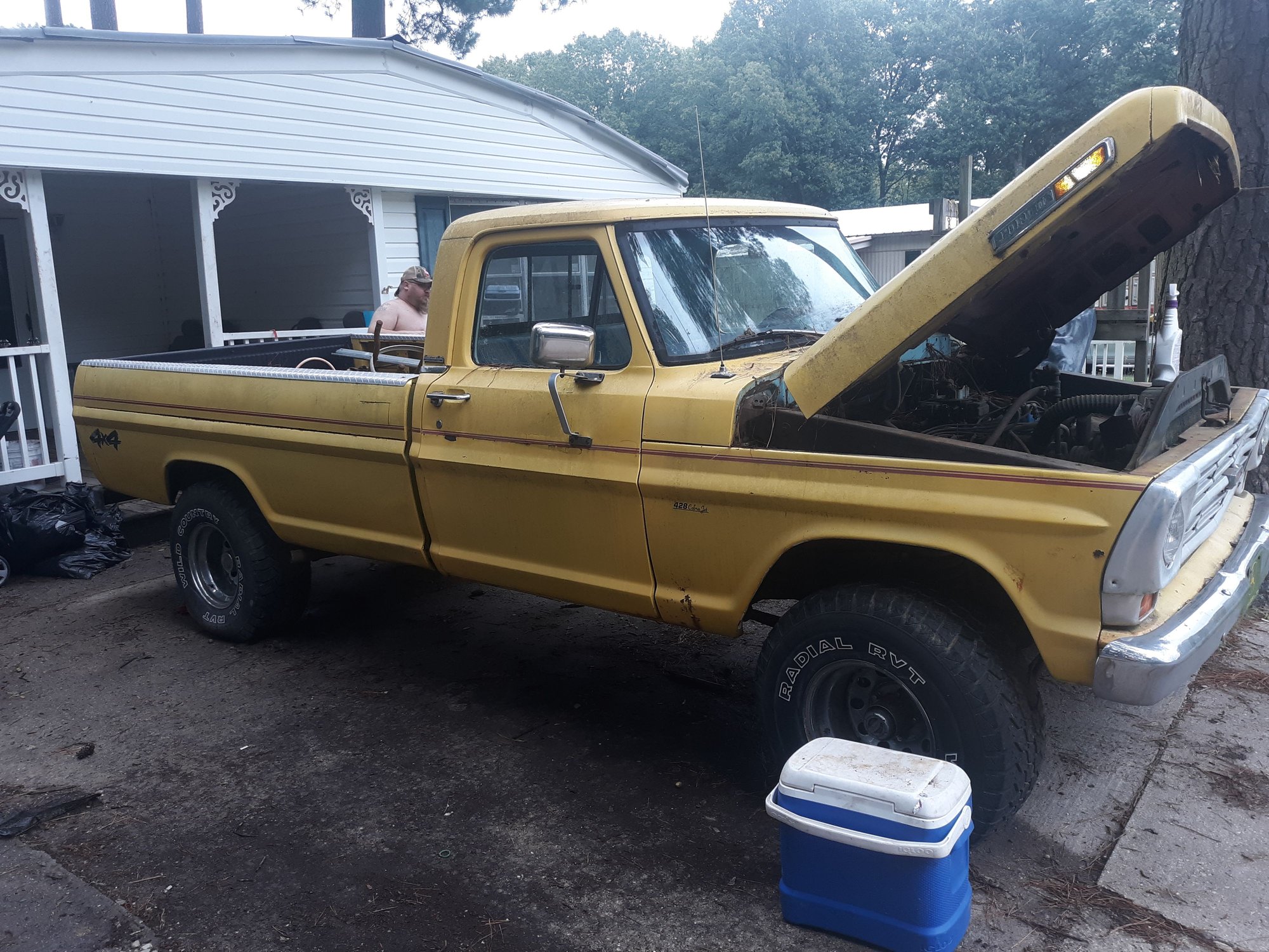

I bought this truck recently and am having an issue locating the vin the truck has the warranty tag but I have checked a lot of forums and they seem to be misinforming me on where the vin # is if anyone could help it would be much appreciated

Vin # is on the driver side door. Also a sticker on the driver door jamb. The Vin is also stamped on the frame in 2 places. One is in the engine compartment passenger side near the spring tower the other is under the cab.
