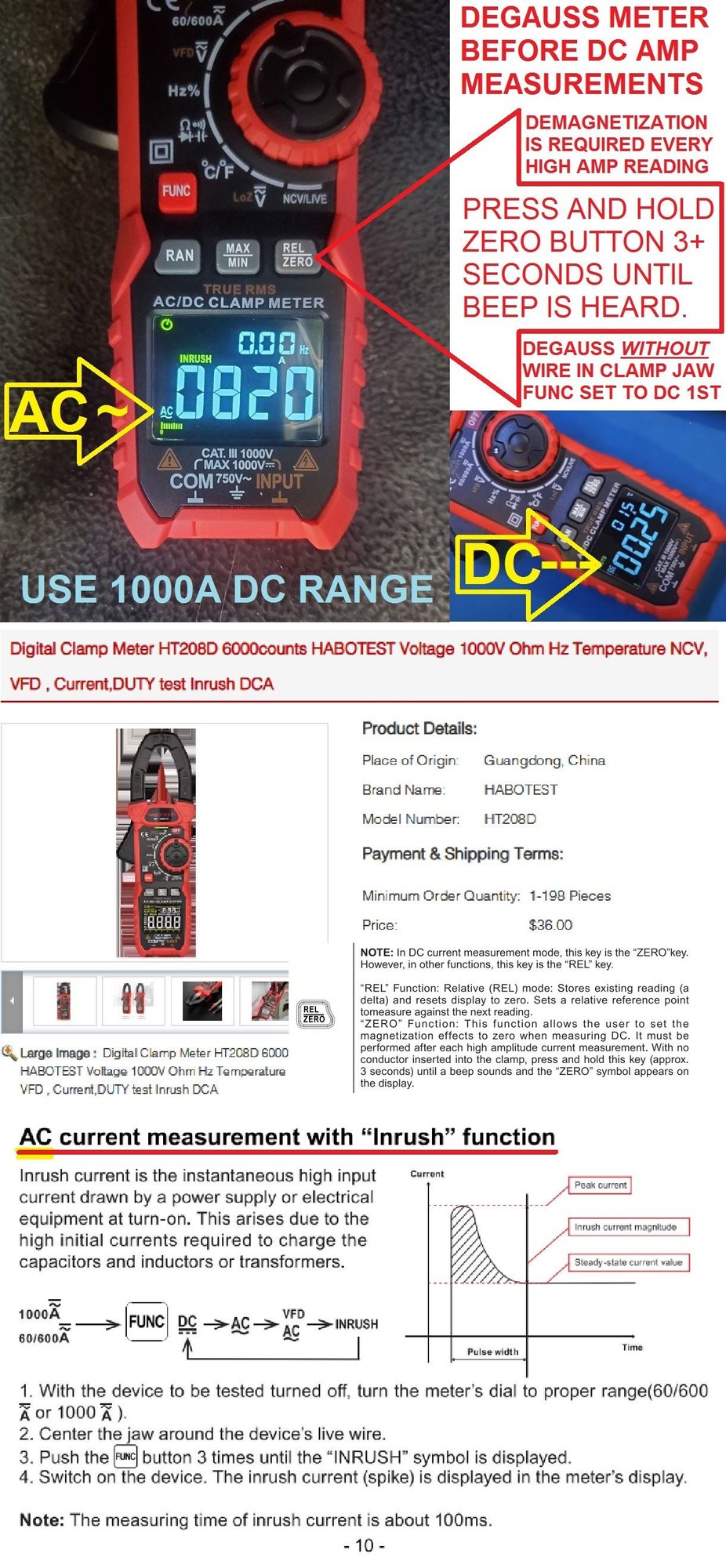

Originally Posted by John in OkieLand
The DC reading may show even higher momentary amps. You'll have to watch the meter though, as it will read continuously, not just for a tenth of a second as in the AC Inrush setting.

I remember pressing buttons to Zero it, and I hit that button a couple of times, don't recall how long I held it down though.
that Inrush reading, is the very 1st time that I used the meter...
I do recall that I pressed that on every scale when in the house, trying to see what effect it had on things.
tmw is going to be nice, I will repeat the exercise and see if today's was accurate.

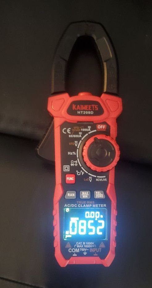

Well,
I tried to make it show DC twice,
the options are:
1) select 1000 A and it shows DC
2) press Function once and it shows AC
3) press Function again and it shows AC + VFD
4) press Function again and it shows INRUSH
5) press Function again and it returns to Step 1)
Took two samples,
1st was 860A at 38*F and it cranked longer than normal, then WTS came back ON, it cranks a bit more and started. ( no picture )
2nd try about 3 minutes later
shows 852A
and WTS again, came on before it started.
and yes, I pressed the Zero button and heard the Beep

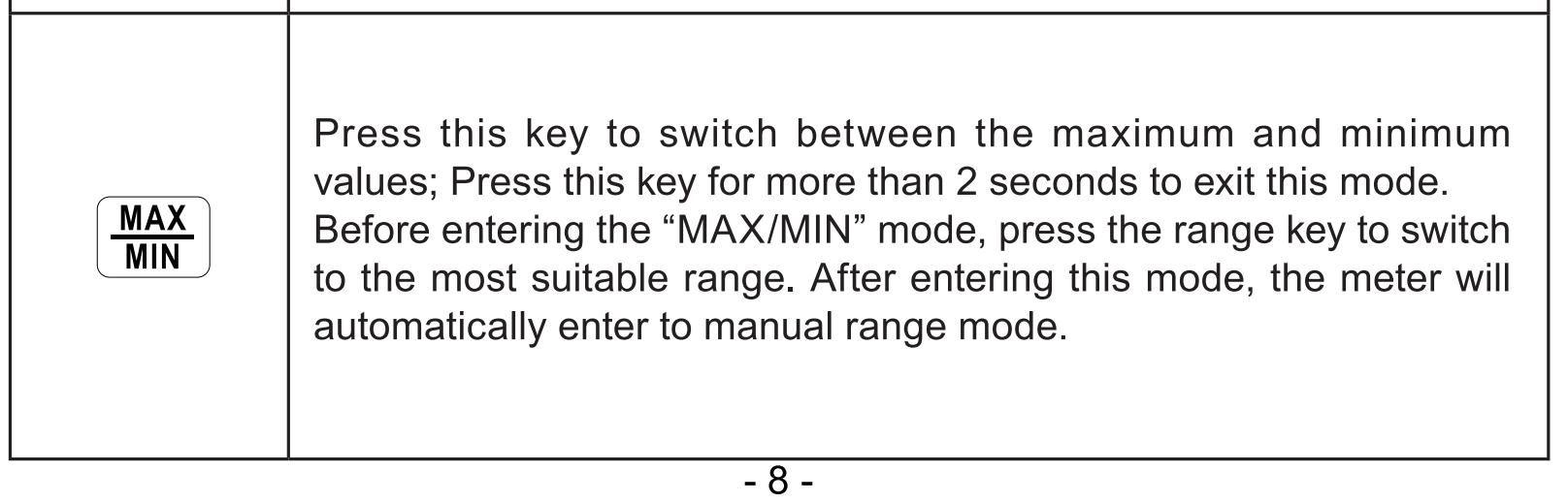

Try it with Option 1 and see what it says (the reading will not be static, unless the meter will remember the transitory max peak for recall with the middle button).

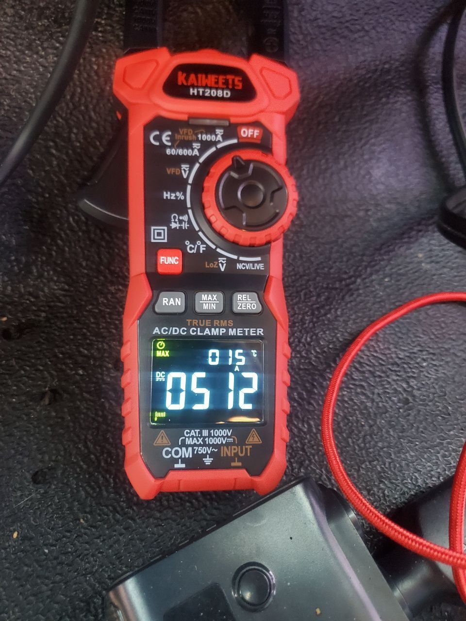

Wondered about that, haven't wanted to work the starter over too much in a short period of time.
Reading the PDF, I took note of this:
so, a couple hours have passed, temp is now 41* and set the meter up for DC, Pressed Zero, then MAX
to me, INRUSH is pretty much the "Truth" and closer to what I believe the batteries are Subjected to.
MAX on DC, this is my only attempt to use it this way, will need to do a lot more reading to decide which value is the "Truth" as to Starter draw at 0.000 seconds to 0.005 seconds.
