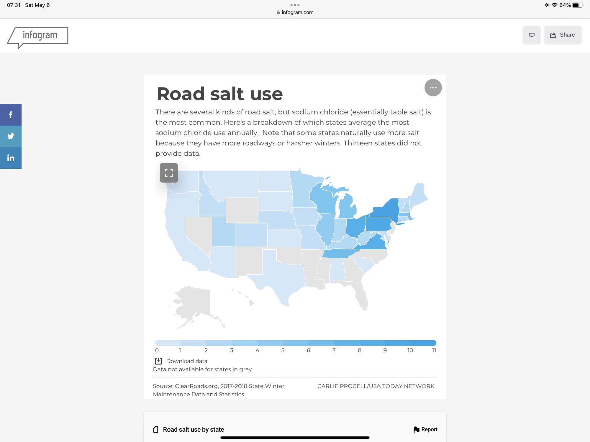

Old May 6, 2023 | 08:31 AM
  #40
NM76F150's Avatar
NM76F150
Joined: Aug 2016
Posts: 855
Likes: 466
From: Albuquerque and Colorado
Old May 6, 2023 | 08:39 AM
  #41
NM76F150's Avatar
NM76F150
Joined: Aug 2016
Posts: 855
Likes: 466
As far as a “rule” the desert SW is generally best. AZ. NM. West Texas, CO. and UT. But the inland Northwest (East of the Cascades) also has some very well preserved vehicles. It’s quite dry there.
In the end it always comes down to the individual truck. My 48 spent its life in southern Colorado and has no rust through. One of my 95s also came from Colorado and has a few rust spots already.
Im always looking at trucks even though I don’t need anymore. If I see a clean one in Southern Colorado or Northern N.M. I could message you.
