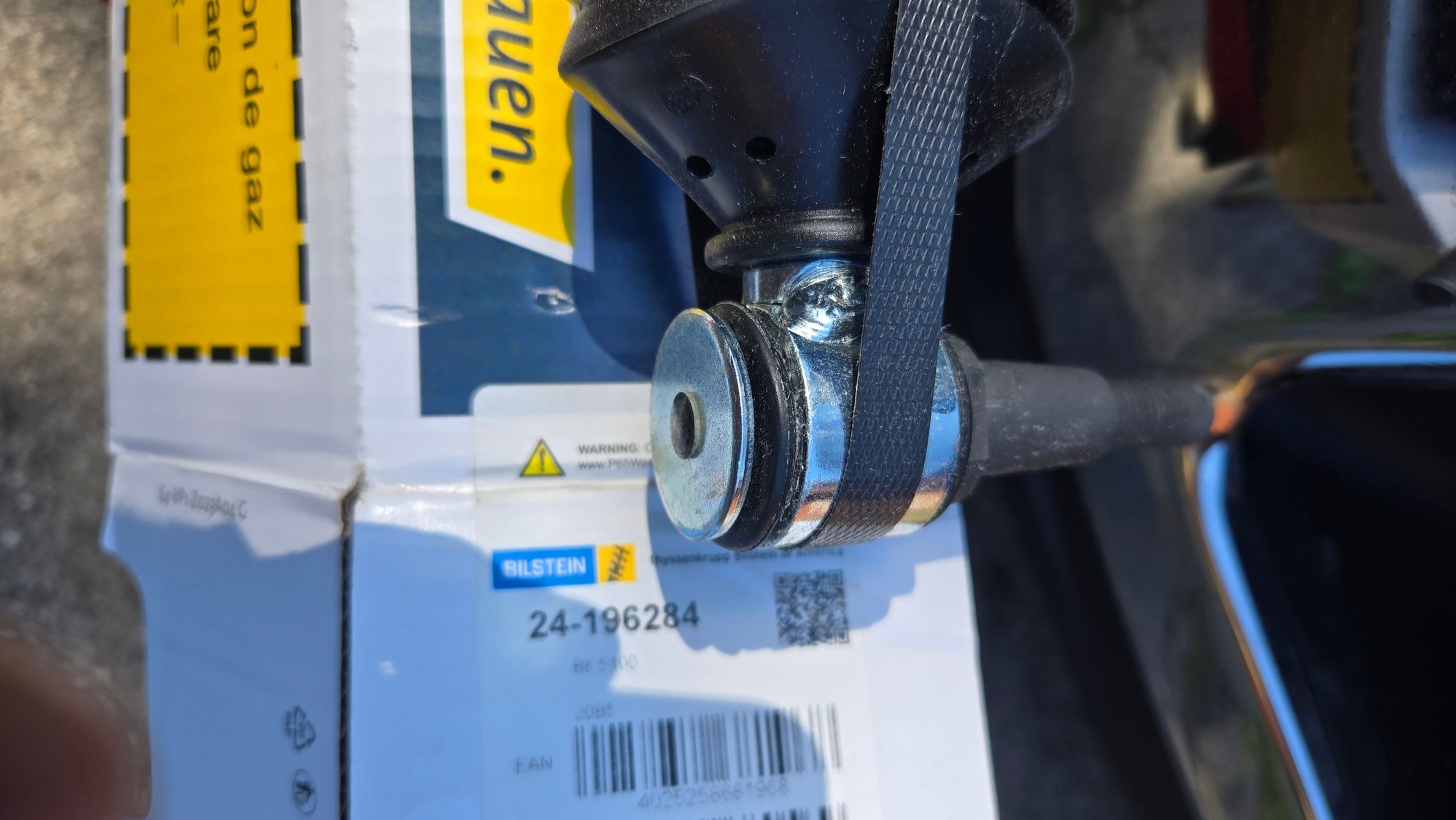

I don't believe a steering damper should have any rebound / spring back, only a damping effect in both directions.
The Bilstein had a strap on it when I pulled it out of the box and when it fell off before install, it began to push out. The factory dampner was harder to push than the Bilstein, but the truck felt way better once the Bilstein was installed.

My rear shocks had a band on them also. Must be natural thing that they push out some when it's taken off.
Yes, steering dampers are not supposed to extend when released. If they do, they will always be pushing the steering rather than helping to hold it in place. It doesn’t take much steering effort to overcome the push but it might lead some to think there’s an alignment problem when it doesn’t track straight.
But then again if it’s a slight push it might just help take the slop out of the system. Like the spring on the governor arm of a small engine.
It was a slight push... all I know is that the front end feels much better now and I feel I have better control over the steering than with that original 141k mile Motorcraft steering dampner.
