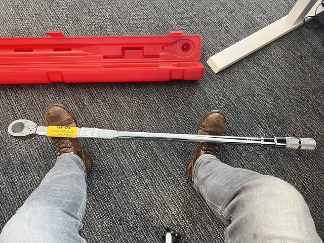

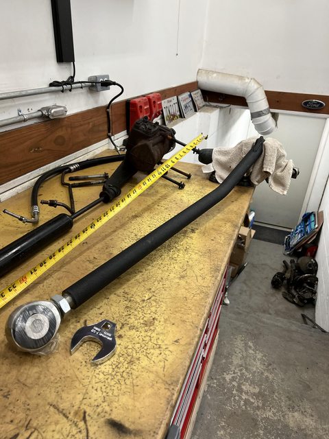

I used the crow foot to get the correct torque on the jam nut for the track bar (in addition to red loctite per PMF instructions):
Attachment 277507

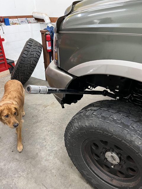

I also used that same big torque wrench to install it to the vehicle:
Attachment 277508
Attachment 277509
