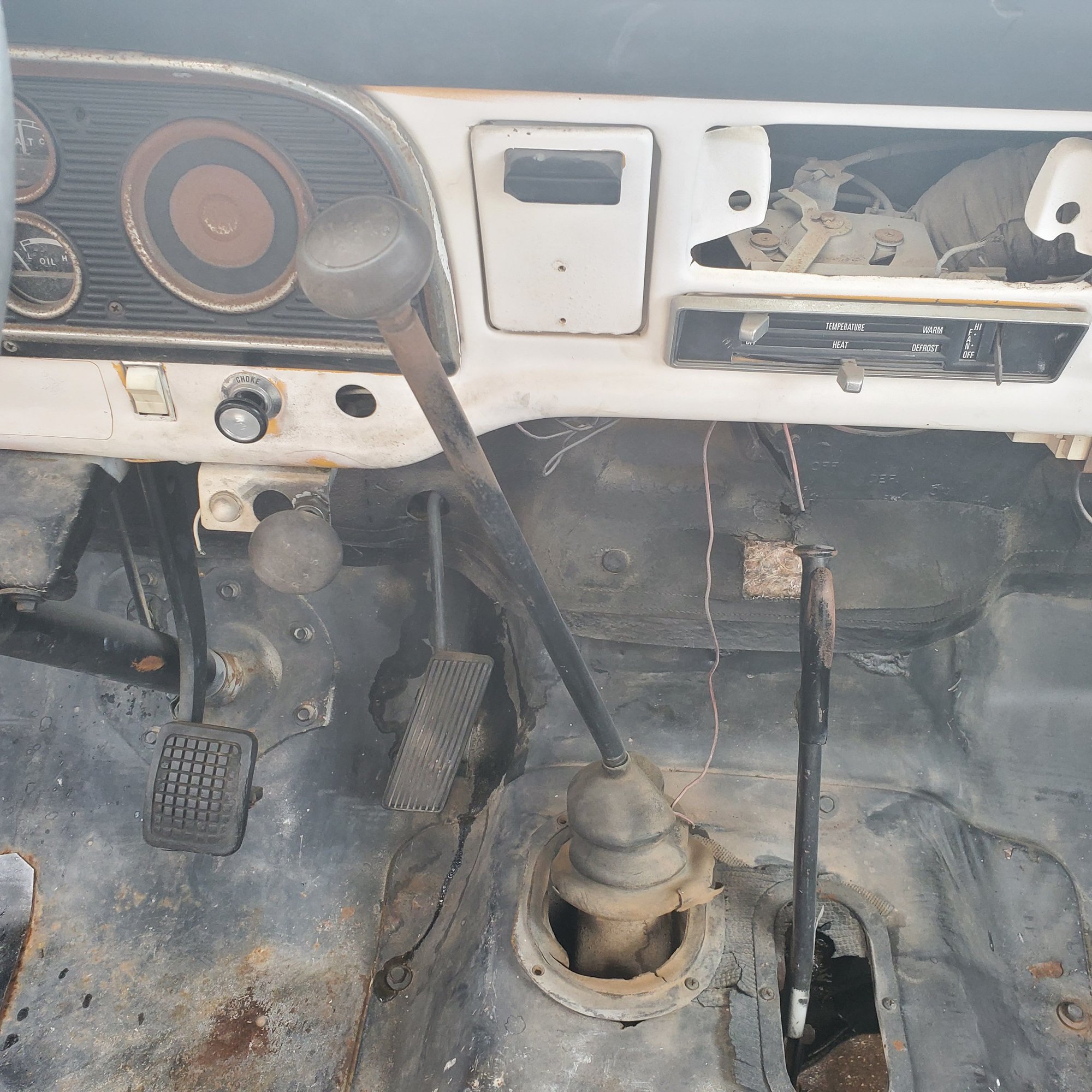

3 = Dana (Spicer) model 7231-D Auxiliary Transmission with PTO. This is unusual in an F600. Does your truck actually have an auxiliary transmission? A 2nd 3 speed shifter?
EDIT: see pics in post 3. No aux. transmission. This code must have simply indicated a PTO as OEM.

Thank you so much for the decode! I posted some pictures of what the truck has. It has a PTO shaft that comes out of the side of the transmission to power a fuel pump. The **** in the cab has 5 speeds and a reverse so maybe it controls the speed of the PTO?

OK there is clearly no auxiliary transmission. So the PTO was probably an OEM item. Your floor shifter with the 4 speeds shown is the main transmission, which matches the description and other pictures of an NP435. The "3" code is in a postion that usually indicates an auxiliary transmission. Some of these indicate other things including fan clutch, sound packages, California emissions, French labels.... I don't know why they would use the same code for two different things on the same line. Usually the different engines or transmissions on are separate lines in the MPC.
The 5 speed **** is simply screwed on to the PTO control because that was what was in hand. The speed of the PTO is controlled by engine speed. The PTO is in or out, no "speeds" like a transmission. Once it's in, if you rev the engine, you'll get a faster PTO speed.

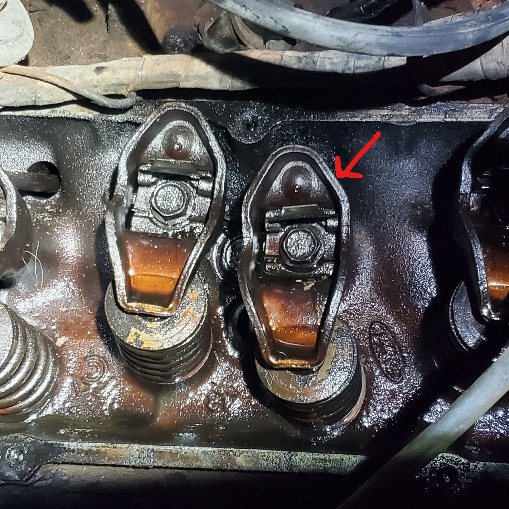

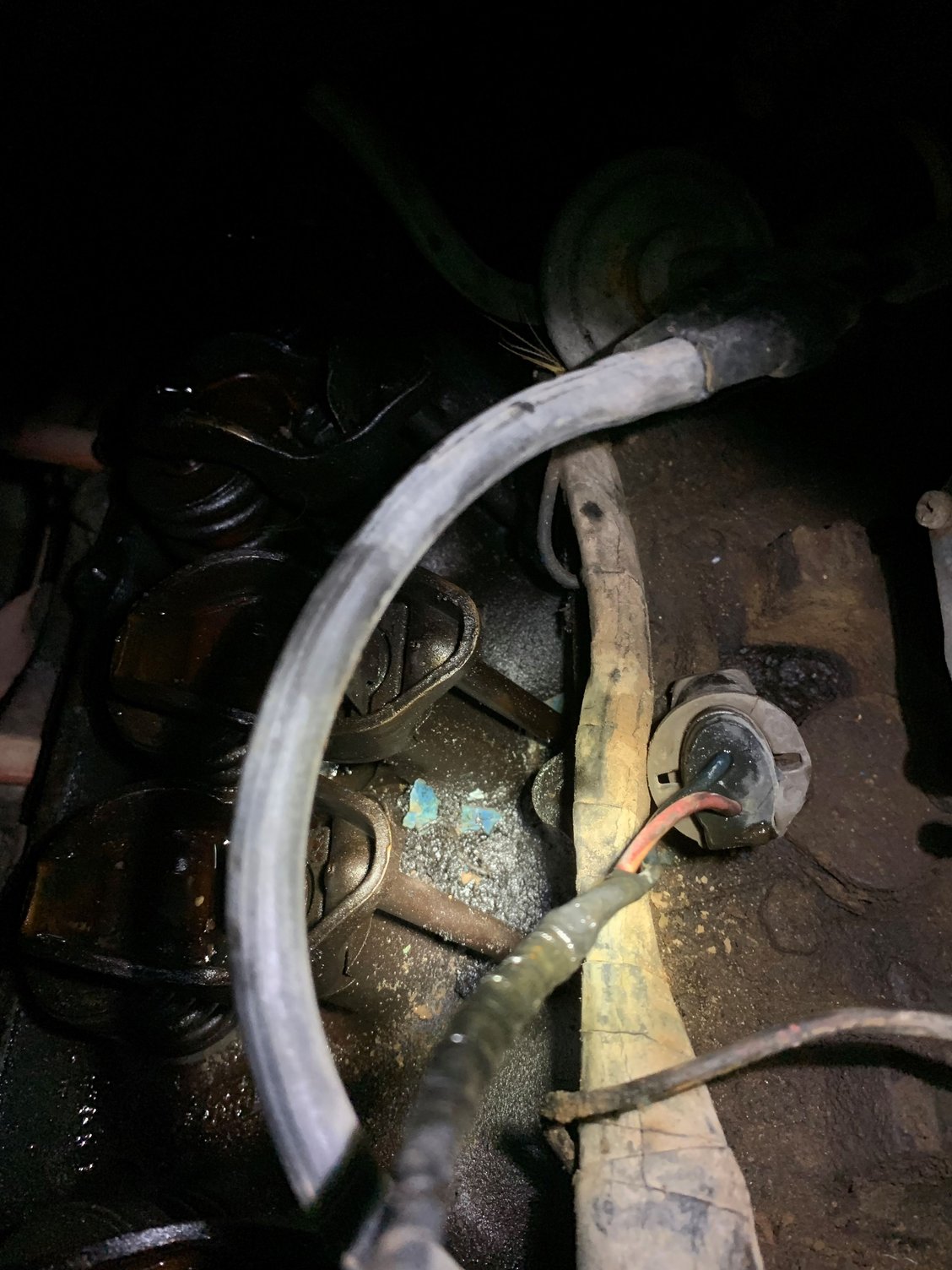

In regard to future plans, I would like to fix it up to make it a useful fuel truck, but I am running into a few obstacles. The inside of the tank is all rusted out, so I am going to see how much it would cost to have the rust removed. The more present issue that I found when I took off the valve covers today is that there is a buildup of metal shavings around one of the push rods on the passenger side. There was also a quarter size ball of metal shavings there that I removed. The two blue pieces in the picture fell in as I was removing the covers. Do you have any idea where this could be coming from?

As to your engine, metallic debris points to some misalignment, bent push rod, lack of oiling or some other calamity that must be searched out.
Did this engine run?
