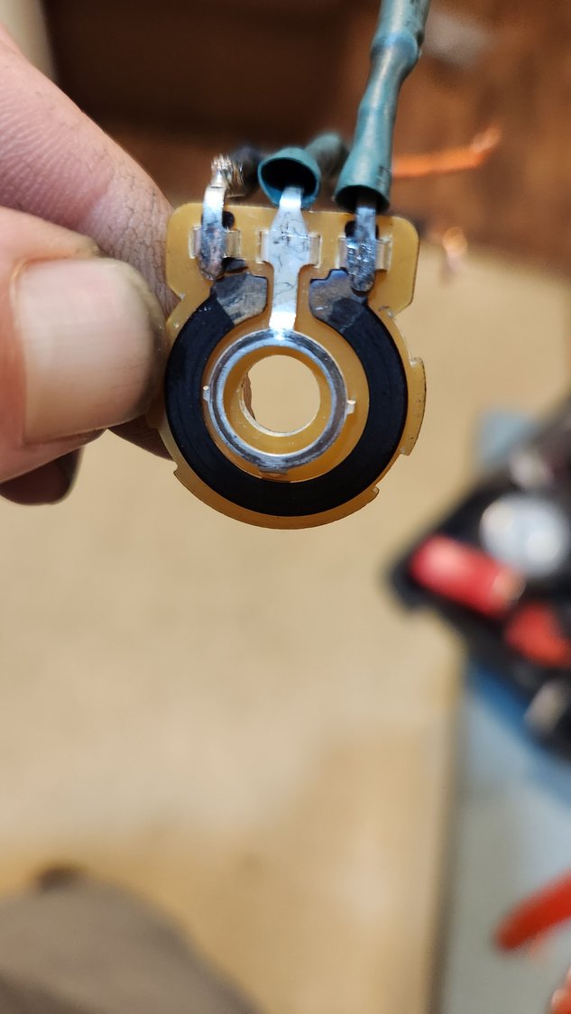

Got my iss pro guages installed 😎. Using isspro dimmer wired into the brown wire on the headlight switch. I'm having trouble getting the dimmer to work. When I ohm it I see it working, but the lights stay constant. Swapped to volts and as expected the were staying the same. Played with it a bit gave it a good squeeze and got it to function a little. It starts to dim then goes completely dark in about an 1/8 of a turn any idea? Bad dimmer?

I saw people talking about using the software to fix their issue but my gauges don't flicker when I adjust them. When I first wired them up I put the lights on the factory dimmer switch. I had 0 adjustment from the isspro dimmer. Basically seemed like I wired them straight to the factory dimmer. Out comes the volt meter leaving me scratching my head even more because it appears to be functioning. Thinking I may have made a mistake, I rewired everything. Noticed in the process if I manipulated the leads leaving the isspro dimmer it would function for a second then cut back out. Leaning toward it being defective think I'll give them a call.

Yes I got the ev2s. Dimmer part number is R72022. So here is what confused me. If I wire straight into my stock dimmer switch the r72022 has no function. Ex if I turn the dial nothing happens, but my stock dimmer will run through the full range of brightness for the dash and the guages. If I ome the isspro potentiometer aka the dimmer I see the variance as I adjust the dial, but if I swap to voltage I see no variance. My stock dimmer shows a voltage variance and it functions properly with the guages. If I physically manipulate the leads or the housing of the R72022 I can get it to briefly function properly. I guess im not understanding how without moving my leads when I ome it I see the variance when moving the dial, but swap to voltage and it remains constant. Like I said previously I'm leaning toward just a bad part. Honestly I could just deal with the brightness. It doesn't bother me that much. I'm just more along the angle of trying to source the problem for future knowledge and lack of quit in me lol.

Well I broke down and found my issue dimmer was bad. Temporarily rewired till I get it warrantied out.
