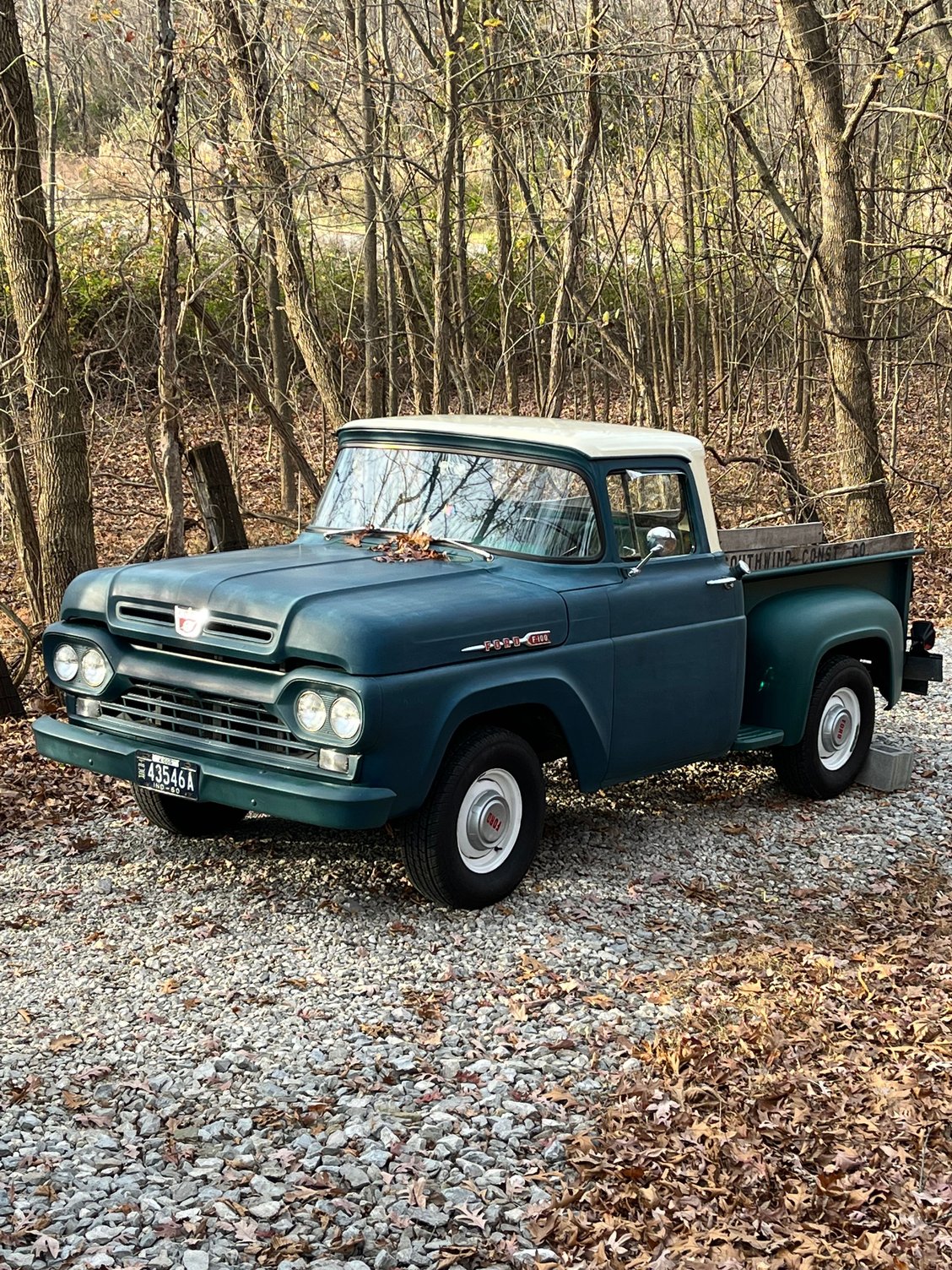

Very nice truck!
If it is a 6 cylinder you can put the positive cable directly on the starter from underneath the hood without taking the starter off. You can do that with a V8 but it is harder to get at.

Nice looking truck. Check all ground connections while at it. Six cylinder engine is easy with socket with extension.

Oh yeah, nice looking truck by the way! I have been looking for those ventshades that go above the windows for my truck but they are not being made now and haven't seen any around. I like the original wheels and tires as well.
