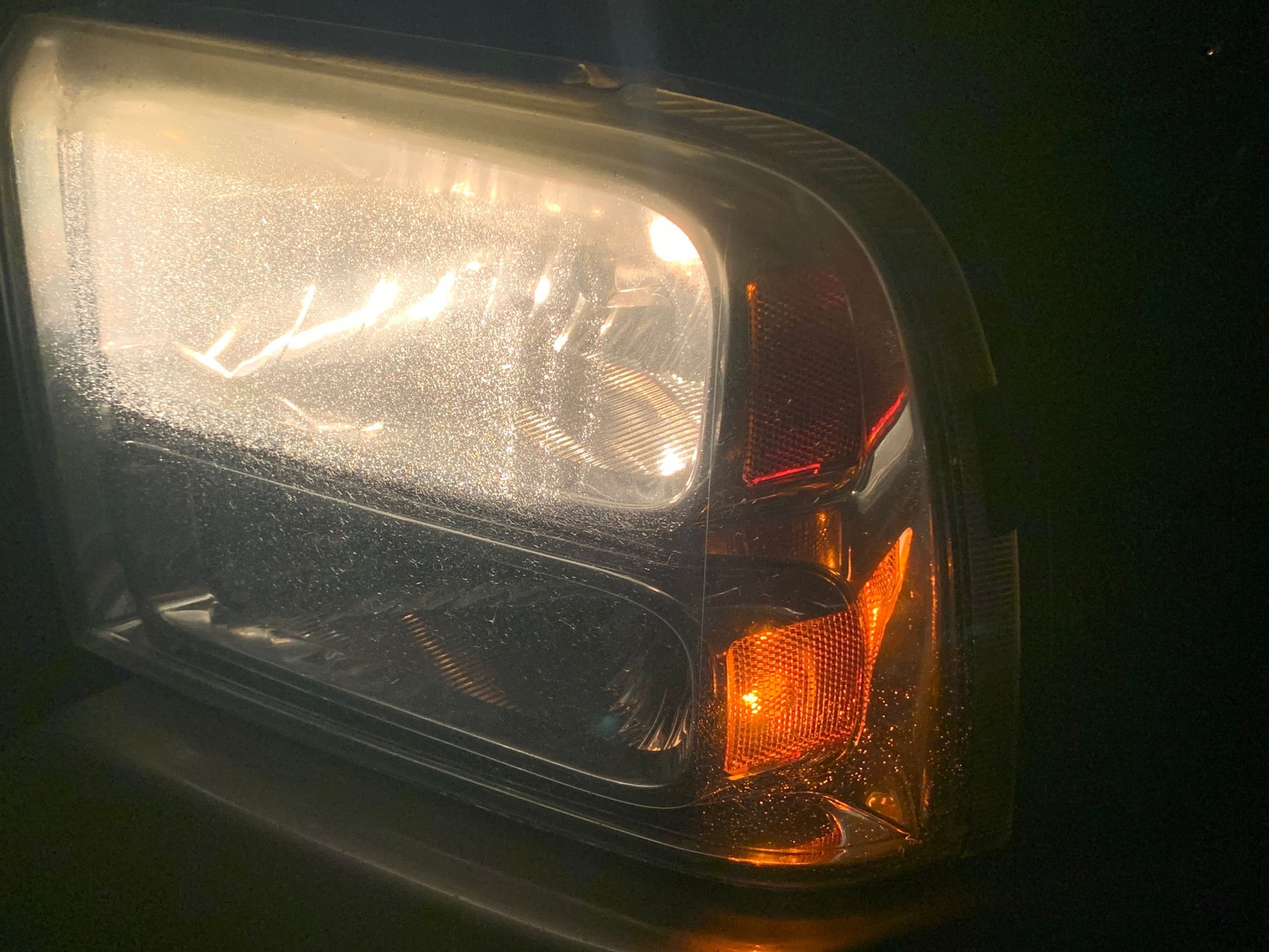

See pictures. 2005 Excursion V10 Eddie Bauer 4x4.

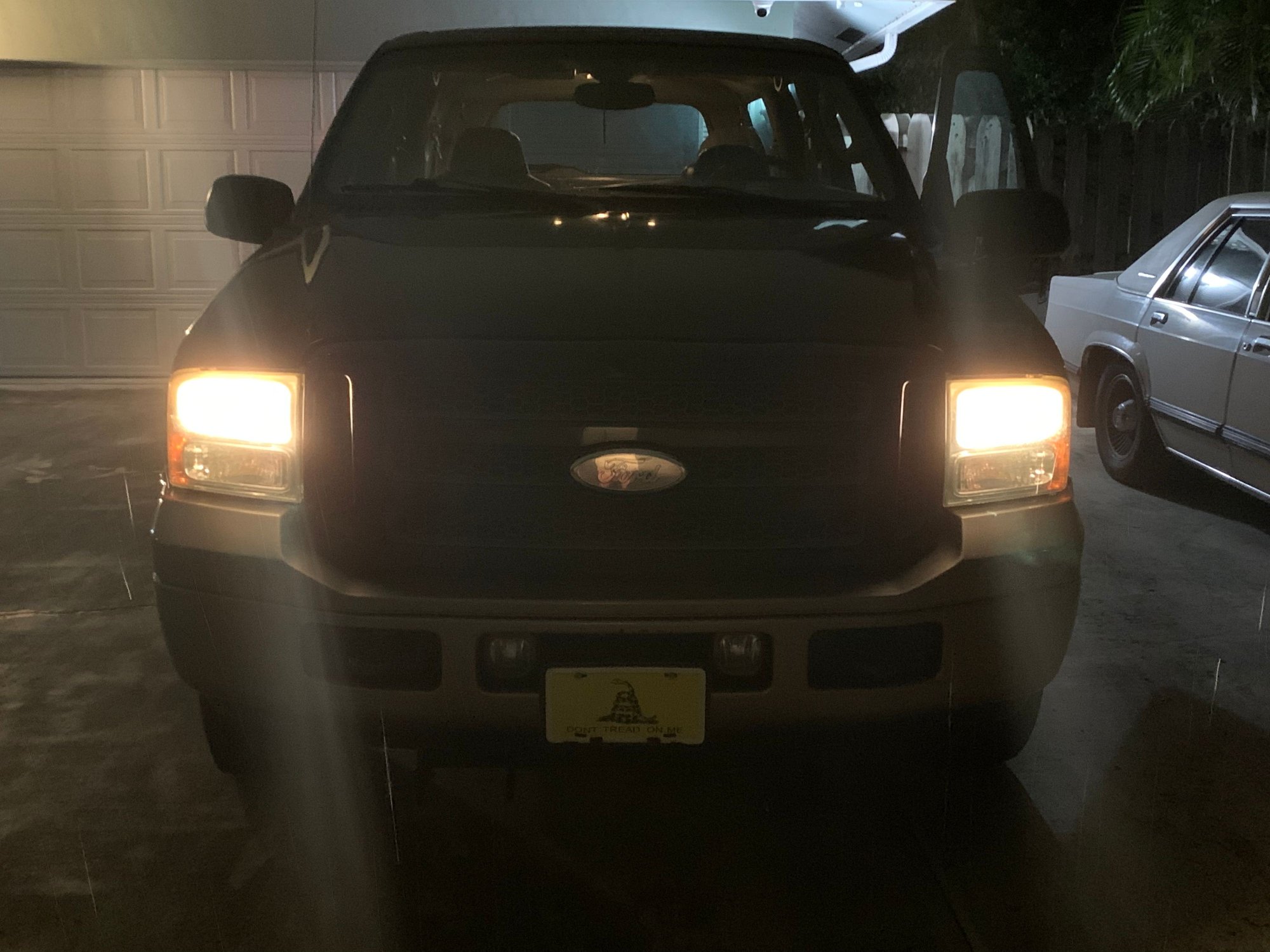

For the picture of the front (head-on), the top (white) lamps are on but there’s apparently nothing I can do to get the bottom white lamps to light up, despite being able to see that there are bulbs inside the housing. What do they do if anything?
Second picture of the side, the bottom amber light turns on but never the upper red one. Is the red one just a reflector? If not then what does it do and when should it light up?
Thanks in advance to anyone who can help.
-sgc2c
Bottom white lights never light up no matter what I select from the controls.
Is that upper red lamp on the side ever supposed to light up?

The lower fo/driving lights should turn on when the headlight rotary **** is pulled out if I recall correctly, my EX is a low option XLT and didn’t have factory fog/driving lights, I added mine but didn’t use the factory option headlight switch.
The upper AMBER section on the side of the headlight housing is just a reflector, no light in it. It has to be amber because font mounted red lights or reflectors is a DOT no-no.

Sorry, by “bottom white lights” I made the mistake of assuming you were referring to the unlit fogs in the picture. Now that I understand correctly (I hope….) that you are talking about the lower clear section of the headlight housings just below the headlights, they should be your turn signals. Do they now blink when the stalk is switched to turn? What does flash up front for turns if they aren’t lighting?

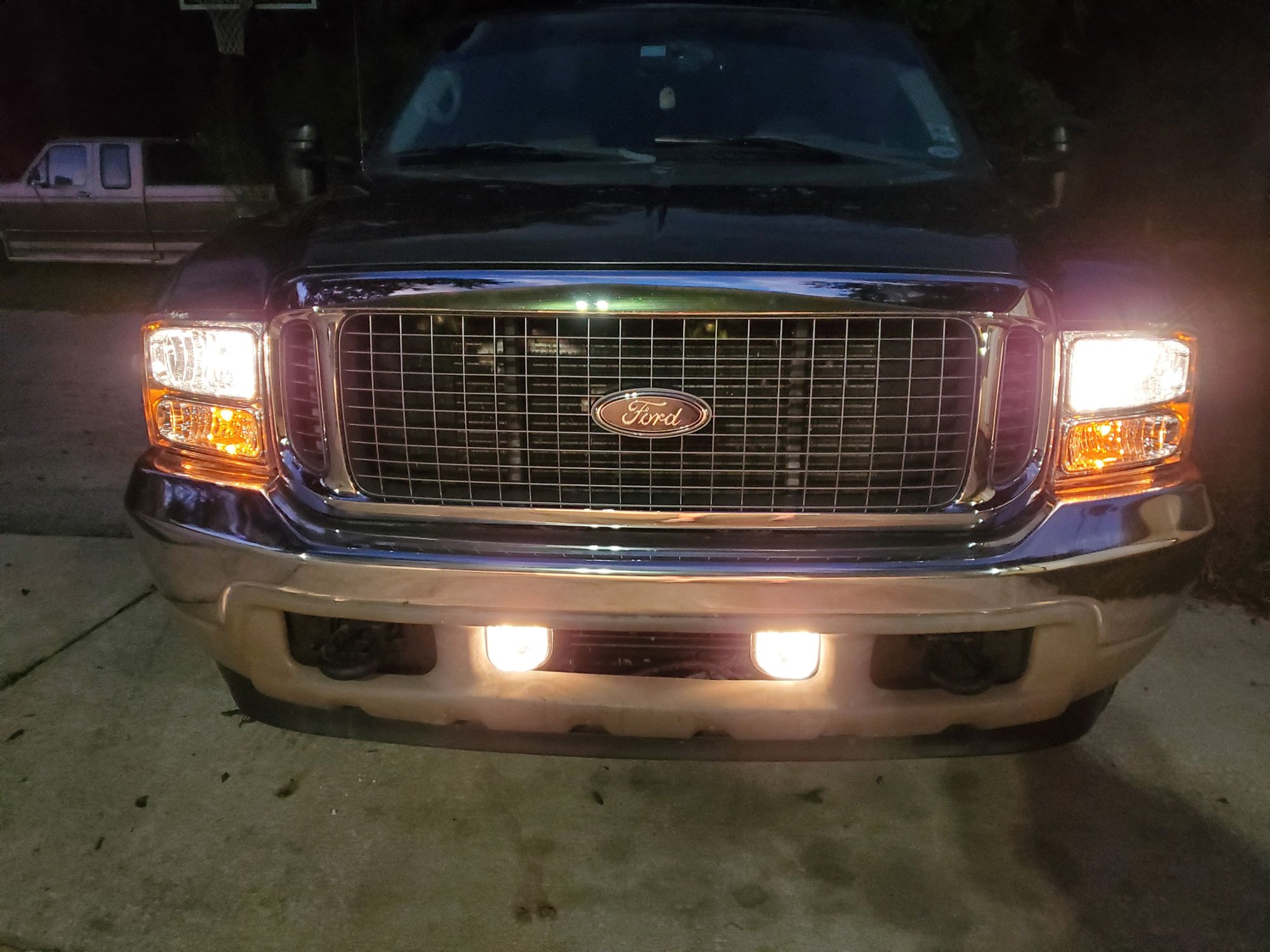

This is what it should look like with the lights and fog lights on.

If the signals are working but tha lights are not lighting then either the bulbs have one filament burned out or the PO has the wrong bulbs in there. They should also be amber

Thanks all.
Took care of it.
And just look at it now …

Bad bulbs?

the upper is just a reflector and by USA motor vehicle code MUST be amber.
red designates the Rear of a vehicle.

WE3ZS:
yes the bulbs just needed replacement.
