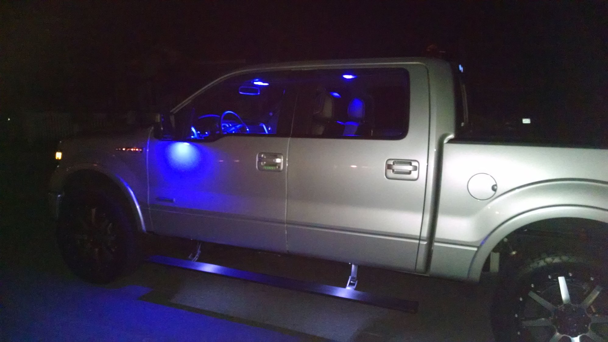

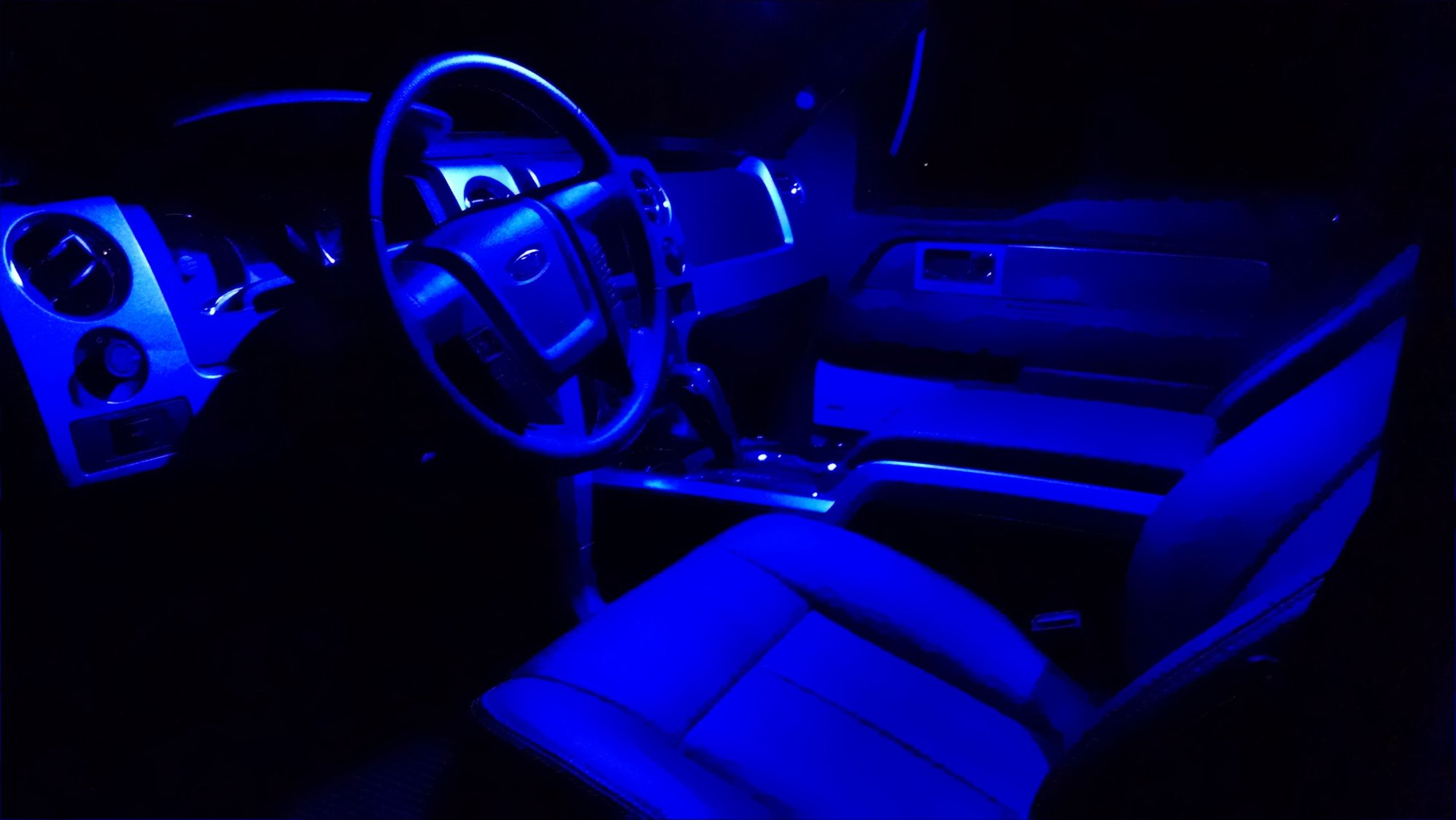

LED
Mine dim down also. I can read fine with these as your eyes adjust to the light. However...if you happen to look at some bright headlights coming your way or I guess any bright/intense light outside the truck then it will take a minute for your eyes to re-adjust. Blue LEDs also wash out certain colors..mainly reds so if your trying to read a map it might be a chore to see any red writing.
Try to get the highest wattage with the most smd's that will fit. I recently swapped out my map lights (Ford-W5W) that had 5 smd 5050 T10 led's, to 9 smd 5050 T10's that just barely fit because of the extra length but are substantially brighter so I'm going to keep them in.
Prices seem to be relatively cheaper now so don't be afraid to experiment.
Only bulbs on my 2014 that aren't LED are the fogs, stoplight/blinkers and headlights...everything else has been changed. Only reason I haven't changed the lower stop/blinkers is you need to wire up Hyper-flash bypass resistors to make them blink correctly and I didn't feel like messing with the extra work.
Hope this helps....

Hey Sundowner. I'm with you on the LED's. Love the look but need decent light for aging eyes. I have installed a fair bit of LED's on my truck but need to add the interiors like Spectech7248 has done. Nice looking rig dude! I'm going to have to find a install video on the LED puddle lamps!
