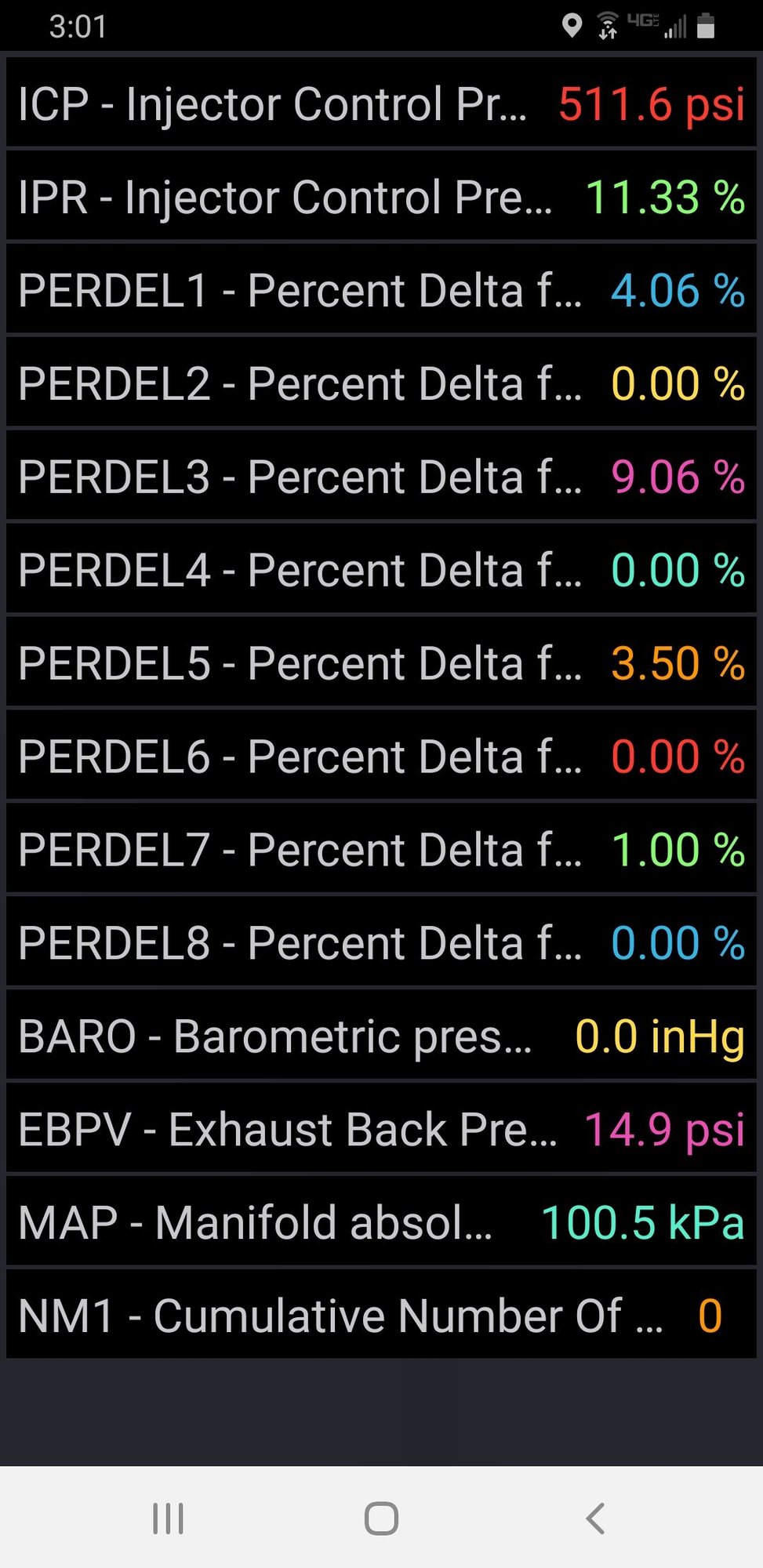

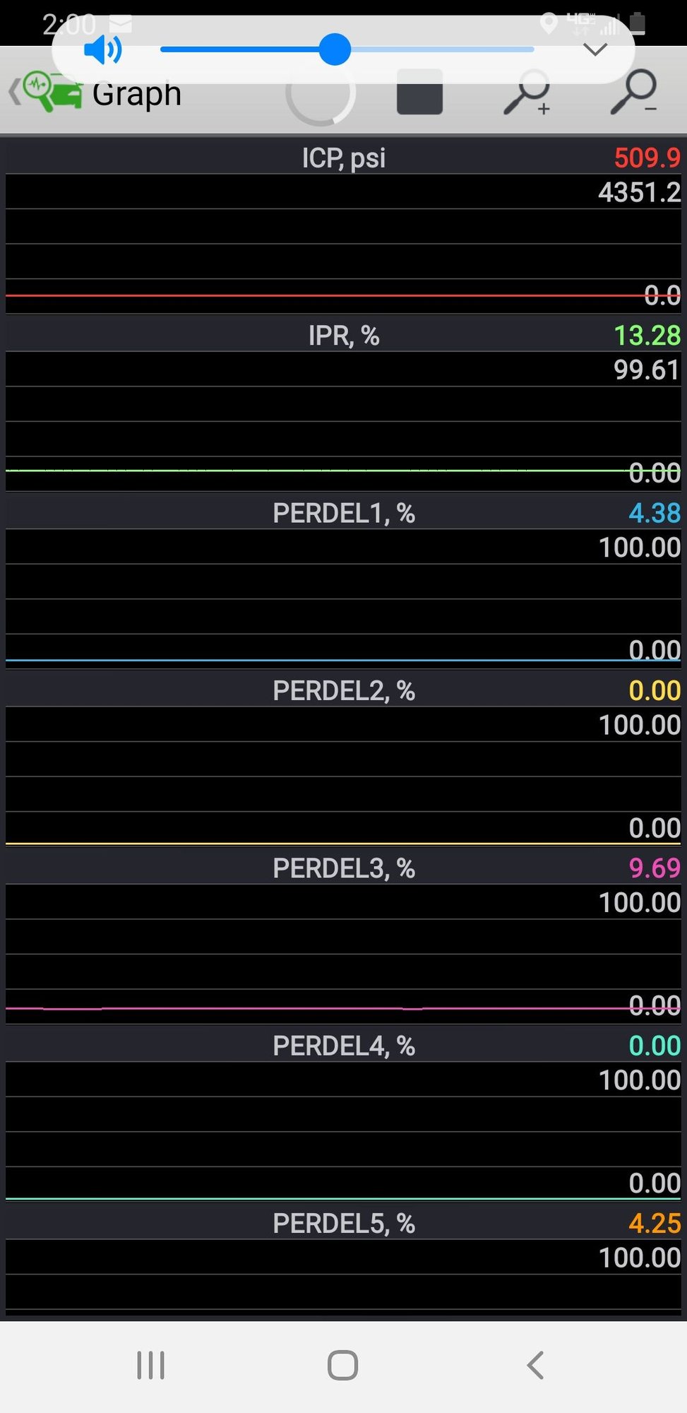

Old Dec 17, 2022 | 03:19 PM
bstarz65's Avatar
bstarz65
Joined: Apr 2021
Posts: 60
SCREEN
Old Dec 17, 2022 | 03:21 PM
bstarz65's Avatar
bstarz65
Joined: Apr 2021
Posts: 60
some screen shots of when it starts running bad. this is at idle.
Old Dec 17, 2022 | 08:57 PM
Jimmy's Pilot Service's Avatar
Veteran: Navy
Joined: Nov 2020
Posts: 994
Likes: 367
From: Republic of Texas
See below. Remove the 42 pin connector block and check these values.
https://www.ford-trucks.com/forums/a...9&d=1392748502
Do the checks on this link as well. It may show a wiring issue.
