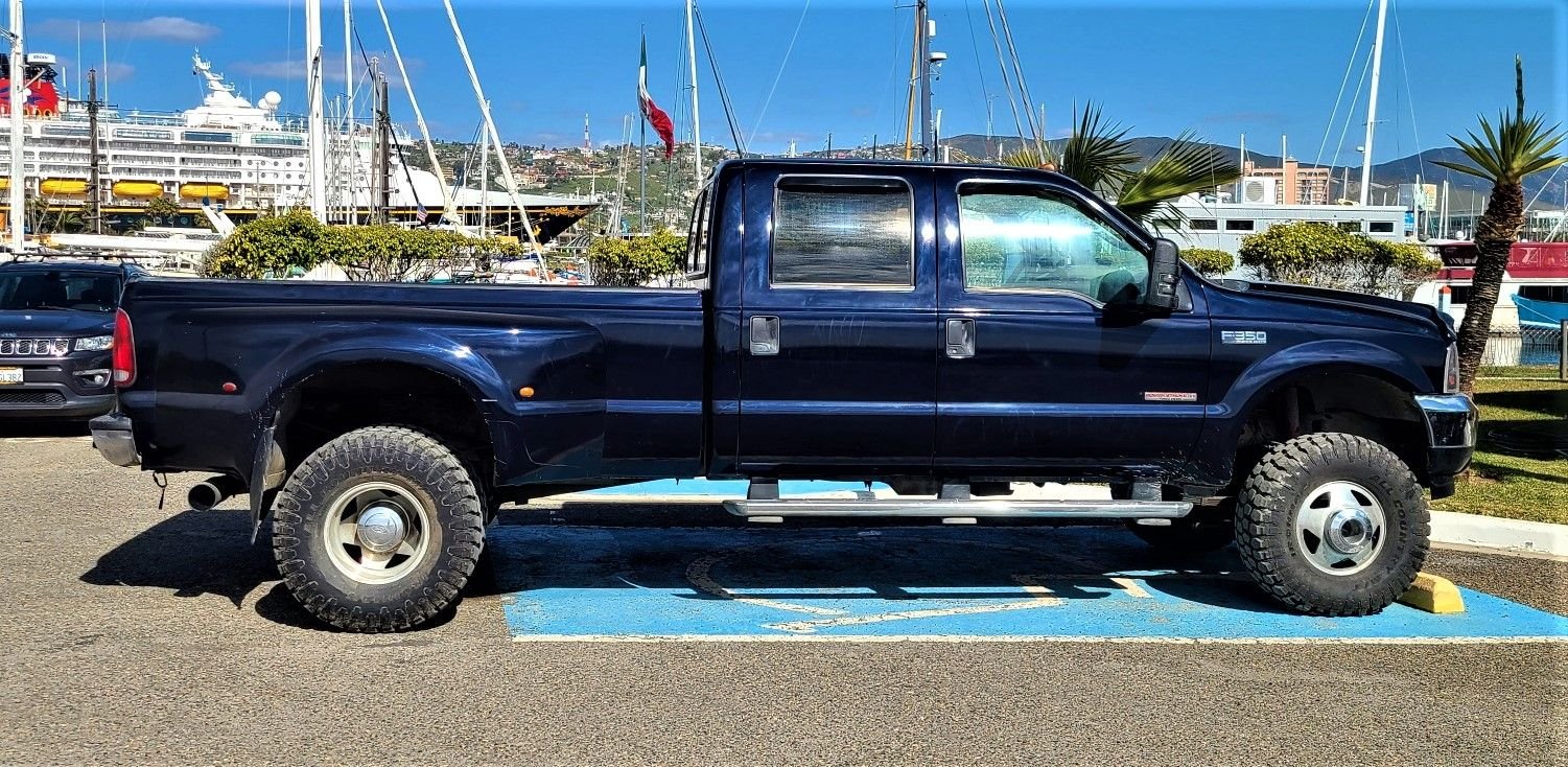

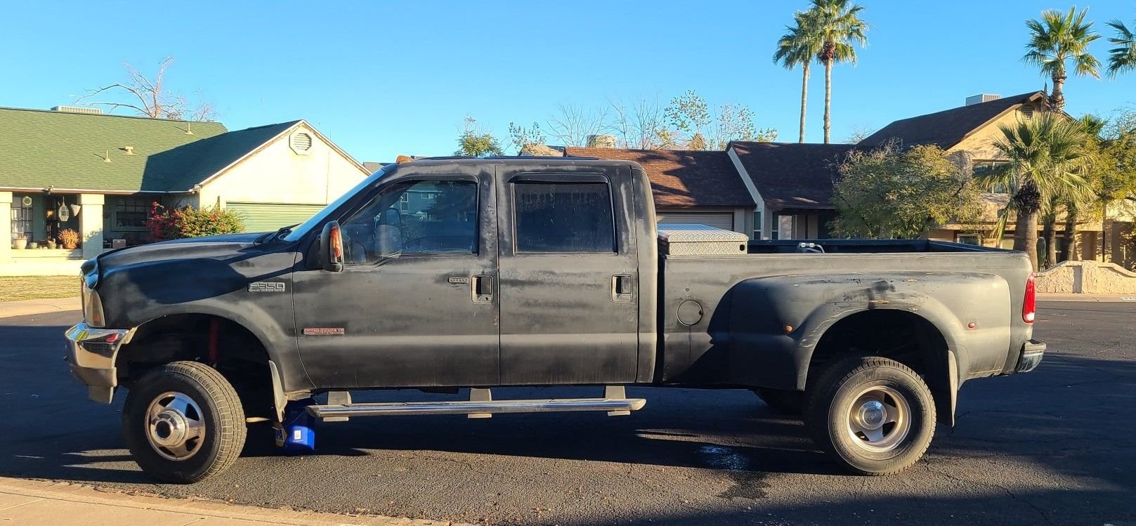

I know the question was not directed at me but I replaced 265's on my Dually. It had 1" spacer. The truck has a 6" lift but that is irrelevant to spacer size. Picture in Primer is with the 265's with 1" and In Blue is with 315"s and 2 inch Bora Aluminum spacer.
265's
265's
315's
265's

Man, Your truck looks really good with the 315s and the lift. Thanks for sharing!
I don't want to do a lift; I just want a little taller tire. I'm not sure the 265s are the right option but they are a little taller than the 245s.

.I don't want to do a lift; I just want a little taller tire. I'm not sure the 265s are the right option but they are a little taller than the 245s.
Well thank you. I'm happy with how it turned out. The 265's are suggested as the largest tire for stock height trucks. The lift was on the truck when I bought it. Not something I would have done otherwise.
