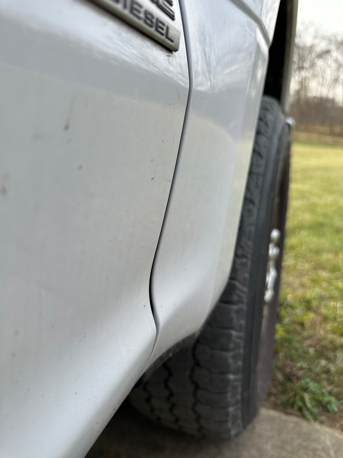

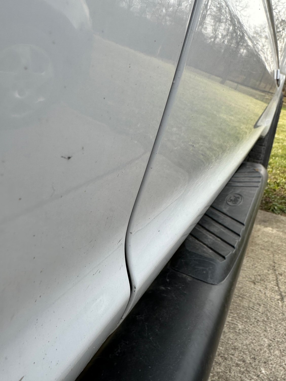

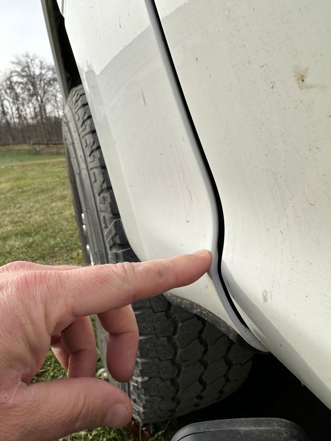

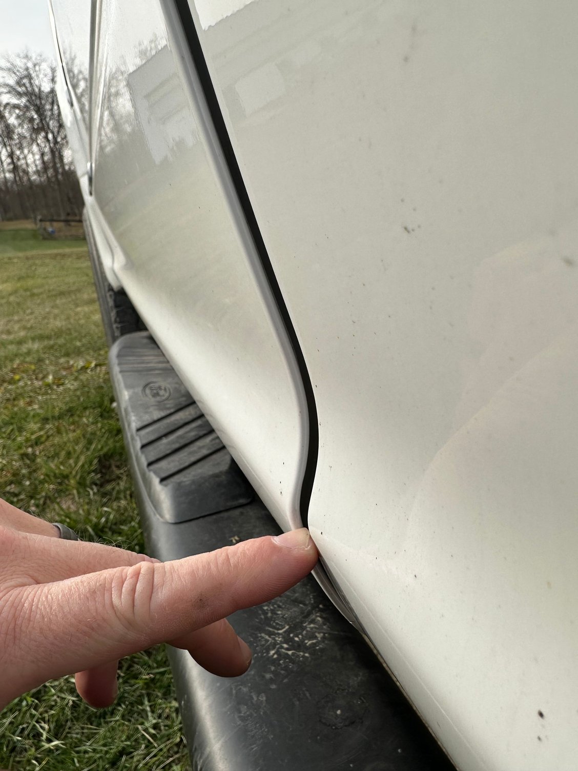

My 2018 f250 driver door isn’t flush. The rear part is out and the front part is recessed. Are there adjustments that can be made?
Driver rear
Driver front
Passenger rear
Passenger front

My doors don't all fit perfect either. The drivers side rear door would touch the front door when I opened it so I took it in to get adjusted. The way they adjusted it was to put a bar on the latch plate and lift up to bend the hinges. I guess there is pretty much no adjustment to the new style hinges.
This come from a friend that works in a Ford body shop so I don't think he'd lie to me.

2 bolts on the front hinges, 1 on the top of each. Loosen and the door will move in and out on the front. Adjust the latch on the handle side to tweak the closing depth. All super easy adjustments. Definitely don’t use pry bars and start bending things. If you can turn a wrench you can adjust the door, it really is easy.
