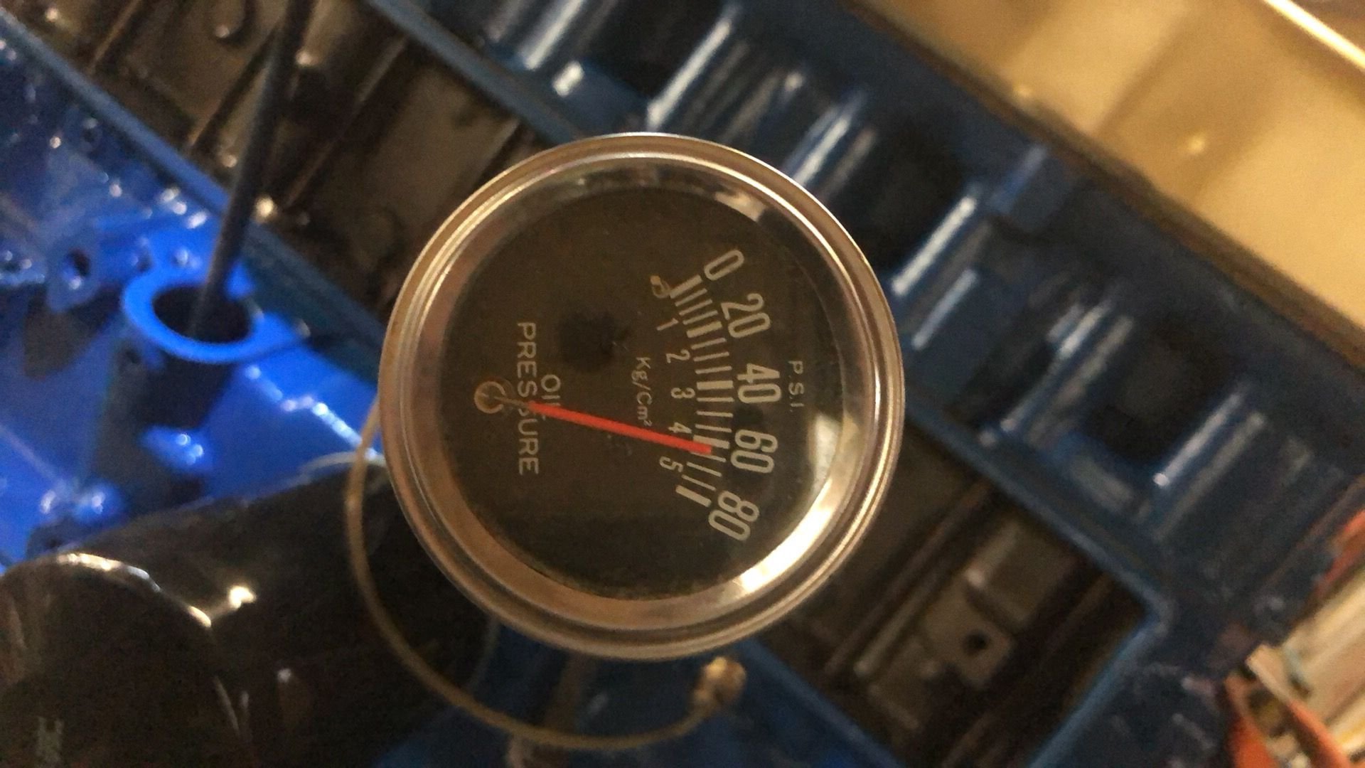

Oh God you are so awesome I do have the oil pressure switch wire. I just have it off to the side where I was stashing stuff while installing the engine!
I know my oil pressure is good before the break in. I took a measurement while I was priming the system. This is with my drill set at 500-550 rpm. So that’s basically 1100 rpm of the crank.
