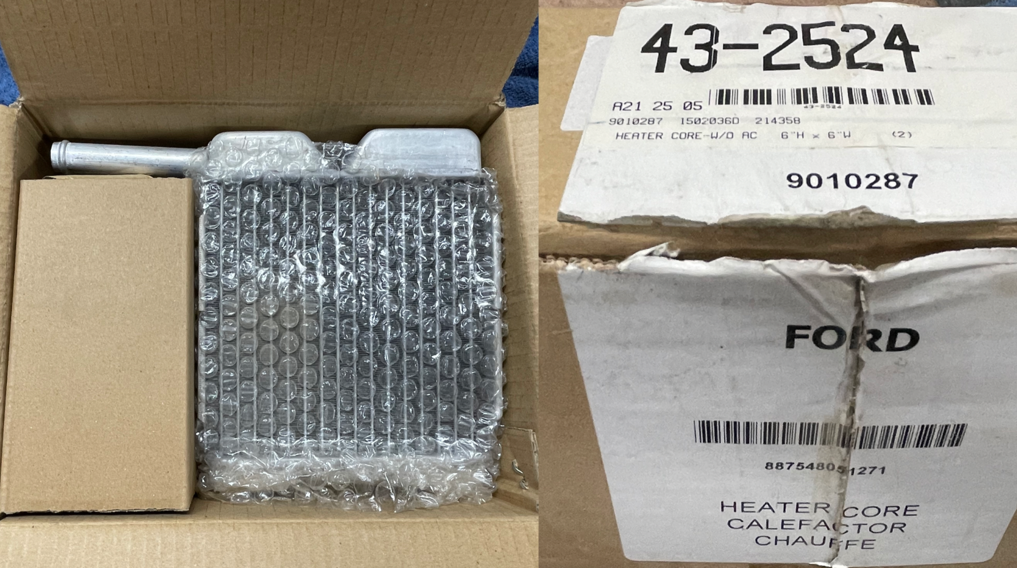

I have a new aluminum one in the original box.. I believe it fits 65-66 but not sure.
It came with the 64 I bought a year ago. I will send it to you if you just pay the shipping. I will never need it.....
Thank you but I got one before I saw this, like I said I've been very busy and haven't been on the forum much.
I am glad you got a copper brass one, much better. If anyone wants the aluminum one I have, its yours for the cost of shipping! Happy Thanksgiving Weekend all.
