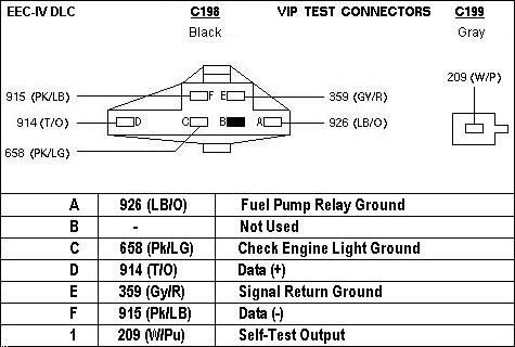

20604795[/url]]It's under the hood on the drivers side inner fender, it may be clipped to something or simply laying or hanging and looks like this...
Thanks for the diagram. I used the EEC when the CEL came on a few years ago, I remember now where that is.

Ok finally stopped raining and was able to get to the van. Jumped the EEC Fuel pump relay prong to ground, turned the key and measured 11.86 V at the fuel pump connection. Previously this was 6.something.
I understand that unless actually cranking the engine, the fuel pump will only get a 1 sec pulse of battery power when the key is turned on, and that the jump I made is what is needed to force the issue (to stay on at battery power.

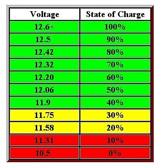

Your battery is at 50% charge. Batteries last longer if you keep them fully charged (12.6 volts +). I know it's been a while since it's been run but if you can, throw a charger on it.
Just for my understanding how can you tell ? I actually had the battery on a charger (to 100%) before I did the test (the test was NOT @crank, I did NOT try to start the engine as the whole fuel system is not intact). I know while cranking the battery should read 13 or 14V.
The alt. will put out 13-14v while running. While cranking the starter, voltage will drop.
How old is your battery?
If it only reads 12.0 volts after being charged, then something is amiss and you should have it load tested.
