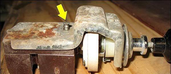

Replace the broken headlight switch and I bet it might fix the dash light problem. Replace the switch and then test the dash lights before you put it all back together. The arrows in the 1st pic are what I bet the problem is as far as the lights intermittently working. And the fact the shaft is turning all the way, ='s broken internal switch. Dash bezel removal and instrument cluster removal here.
