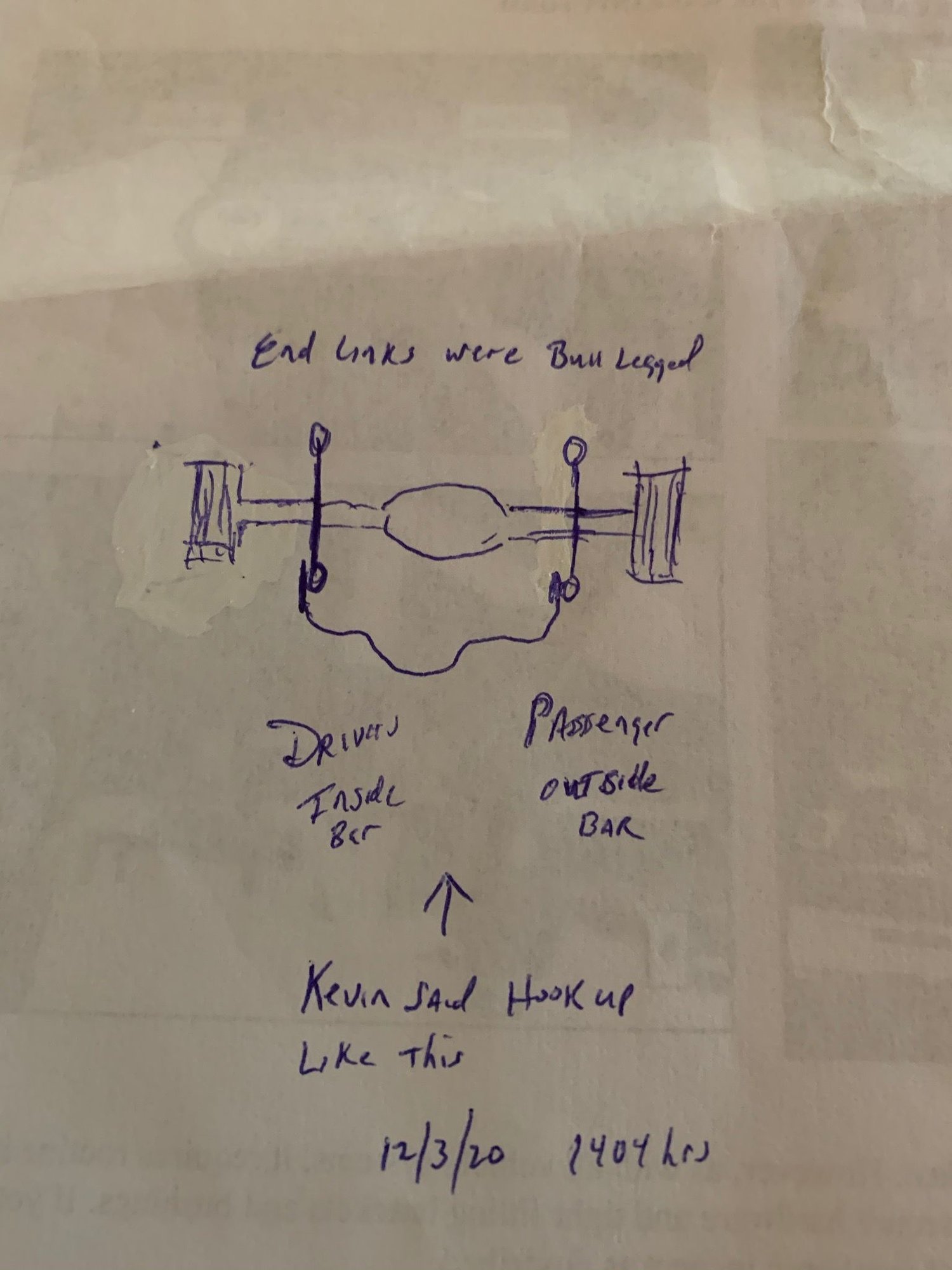

Interesting you said this.
I had the same issue.
I mentioned it to the Hellwig rep and he immediately told me that they get MANY calls on this SAME issue.
However he attributed it to Ford making trucks that were for whatever reason out of specification in so many ways, with stacking tolerances being such, that SOMETIMES the sway bar will bolt to BOTH links on the INSIDE of the sway bar, sometimes OUTSIDE, and sometimes as is the case with me, ONE IN and ONE OUT.
My first reaction was to nod and think, YEAH, ALWAYS BLAME SOMEONE ELSE......
Then I remembered how my tailgate hangs open, with one tailgate cable strap tight, and the other, inexplicably flaccid, indicating that something on the bed is not square and plumb. Or how my 2016 KR had some sort of wheel rub and service said "some of them do that". Perhaps Hellwig is right.

HellWig
I had the same problem. When I spoke to them about it they said most bolt up no problem and some have my issue. They said mine was the correct sway bar and made to specifications and was told to bolt it up just like you described. I bolted it up like that. My truck has many different problems that Ford calls within tolerances it’s pathetic. The sway bar does work fine bolted up like that but it is something I’m not comfortable with.

Yes that is exactly how mine is, and I also talked to "Kevin"....
