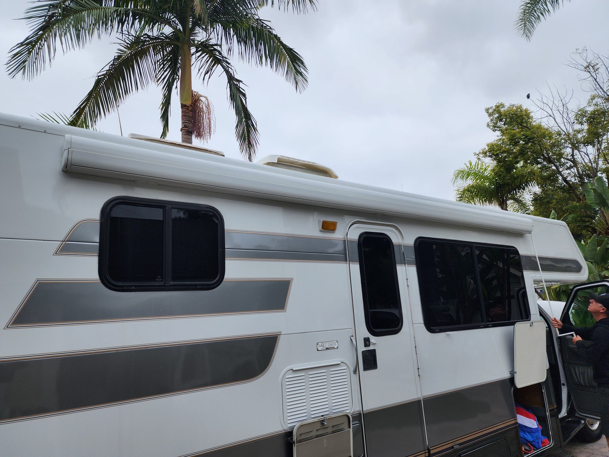

Thanks for all the info on this. I'll pass it all along to the owner and also have her look through all the service records to see if plugs have ever been changed out. The original owner was very good on maintenance and repairs and keeping paperwork so if it was done I'm sure she will find it. If not, considering the mileage and age I'll let her know it wouldn't hurt to have them replaced just for peace of mind sake if she cares.

No maintenance from me here. I'm just her friend who was local to the truck to check it out for her and then drive it up and deliver it to her. I told here I would check it out the best I could but no guarantees as I'm not doing a full PPI on it, just checking on the basics and overall worthiness. Luckily they had all the maintenance records and recent (within the last year) maintenance that was pretty thorough.
