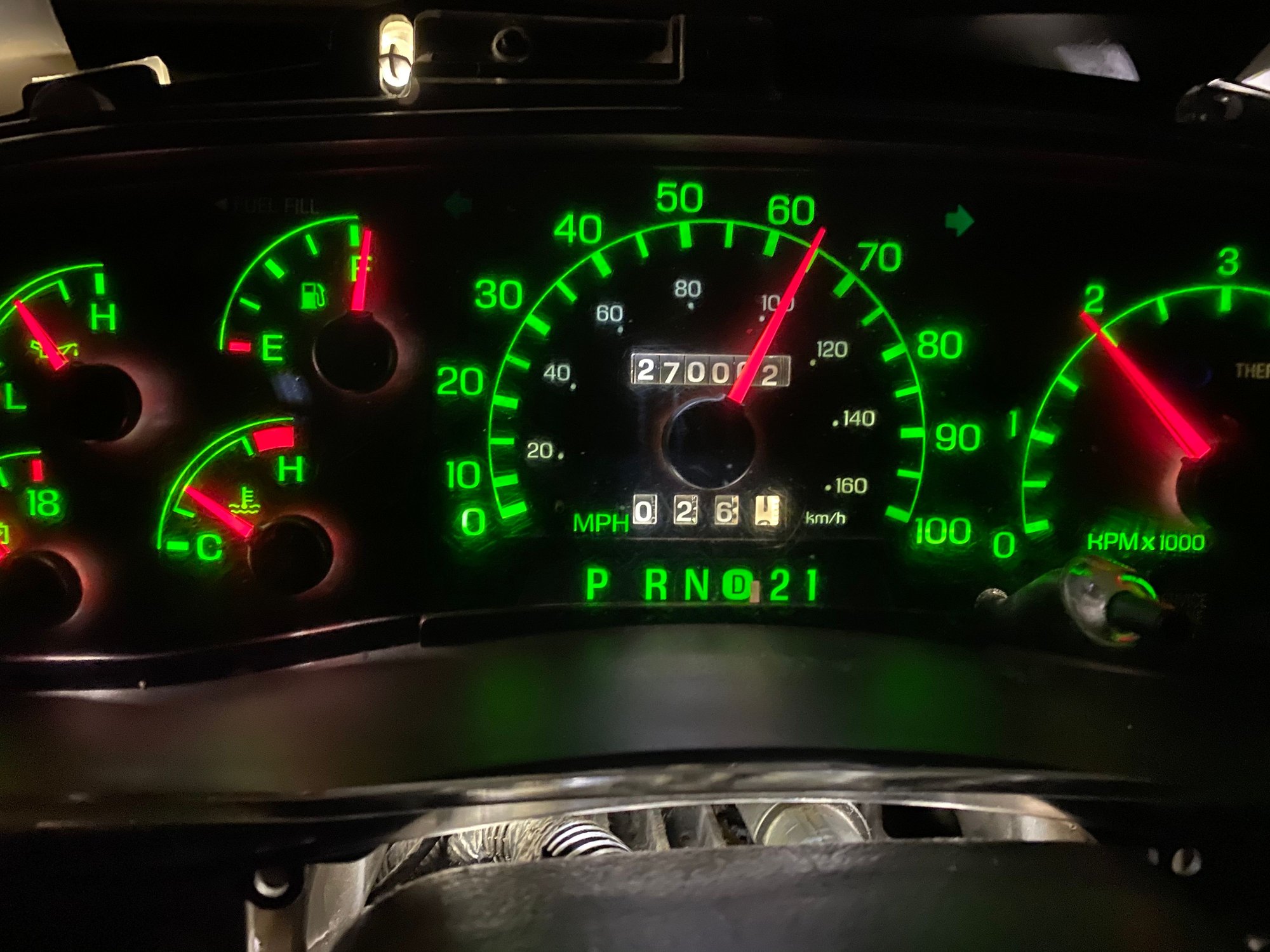

First, let's talk about the cluster. I had a bulb out, and the ones that were still in there were blackened, probably on the verge of burning out as well.
Looks pretty lousy, huh?
Let's make it look like this instead:
I did a little research and came across VLEDS. Practically everything I read gave them high praises. In natural form, I didn't bother reading the tech folder. No, I just dove in, pulled my cluster, and figured it out as I went. When you pull your cluster, this is sort of what you'll see:
Unfortunately, this is my after picture. I killed my iPhone the day after taking my before, and hadn't run a backup. Whoops...

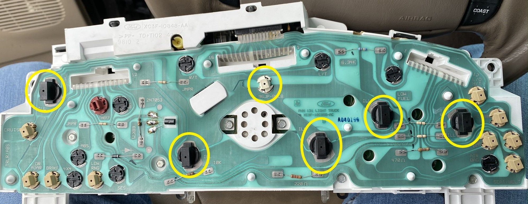

Anyway, what you're looking at is the back of a 2000 Excursion gauge cluster. @Rainmaker1 asked me to diagram it, so I'll give it my best go.
The bulbs circled in yellow are the cluster illumination. The 5 larger sockets are a 194 bulb. The smaller white one is a 74 bulb in the OEM holder; more on that in a moment. VLEDS offers different color temperatures, different colors altogether, and different output levels in many of their bulbs. For all of my illumination, I chose the 5000K color temperature. For the 194 style VLEDS in my dash, I chose the 14-LED.
I didn't circle them, but you'll notice most of my smaller indicators are still the brown OEM bulb holder. VLEDS offers a T5 bulb which replaces the OEM holder. You'll notice I replaced a handful of mine with it. My original intention was to replace them all, but the order got messed up and all of the reds they sent were T4, so with that dismay, I just stopped for the day with all but my reds done. "But Low Range is amber not red" Fact, but when I replaced that bulb with an LED, it stayed dimly lit all the time, and I thought that looked lousy so I swapped back in the OEM bulb.

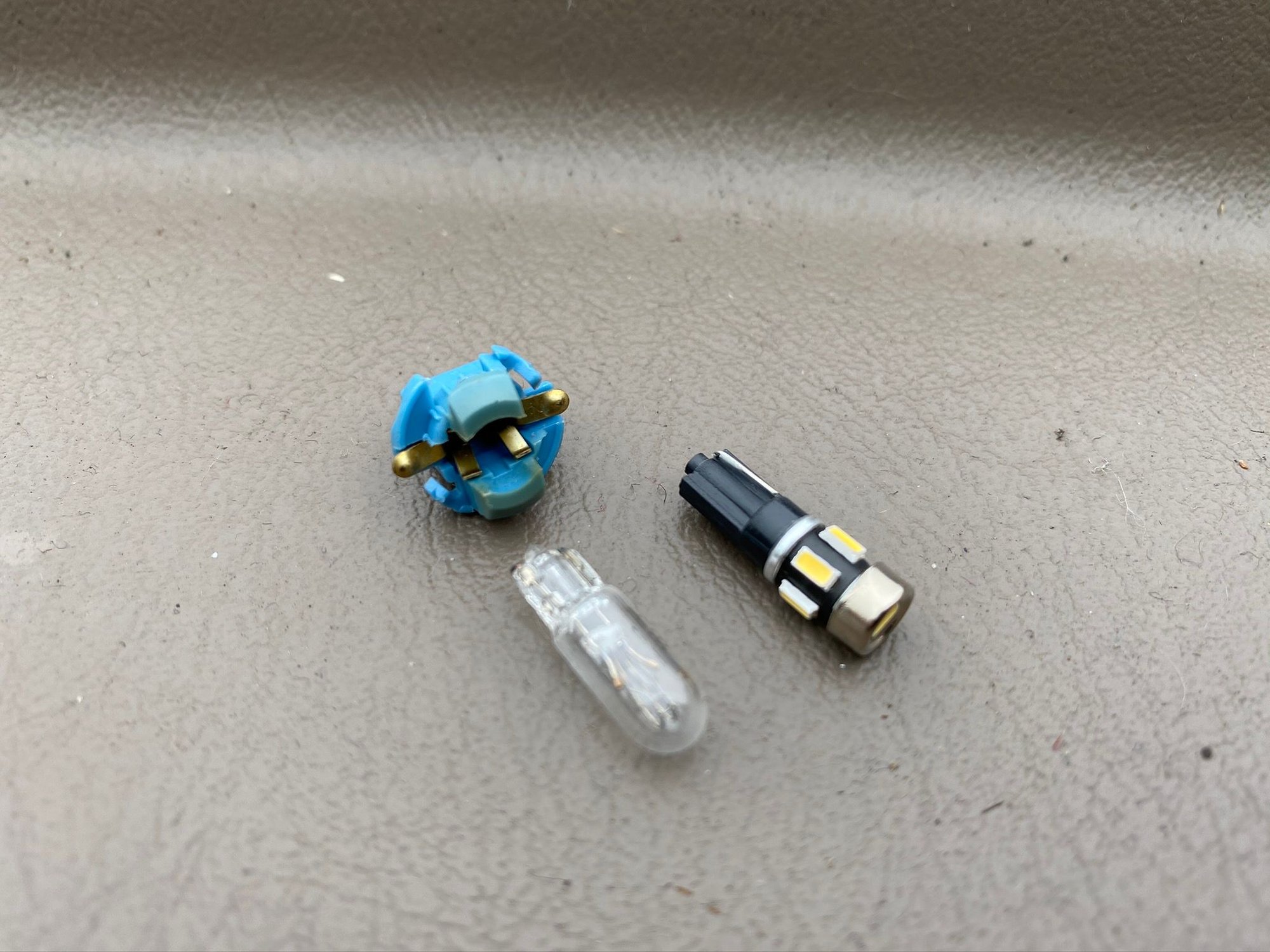

With that wonderful tangent completed, if you clicked on the T5 link, you'll see that it's just a straight-fire double-LED bulb. Not very useful in the instance of lighting up my speedo. So that little bulb smack-center in the cluster, I just bought a 74 and swapped it in. Here's a pic from when I did my front HVAC controls).
Now, should you find yourself in my shoes and you're debating between the T5 or 74, buy the 74. They're 1000x easier to install. VLEDS' T5 is pretty much the exact same size as the hole for the light, so it's a little tough to get in. The 74 puts out better light and shoots it everywhere.
Anyway, that's all I can cover tonight. Sorry if I missed any detail. It's a little past my bedtime! haha.

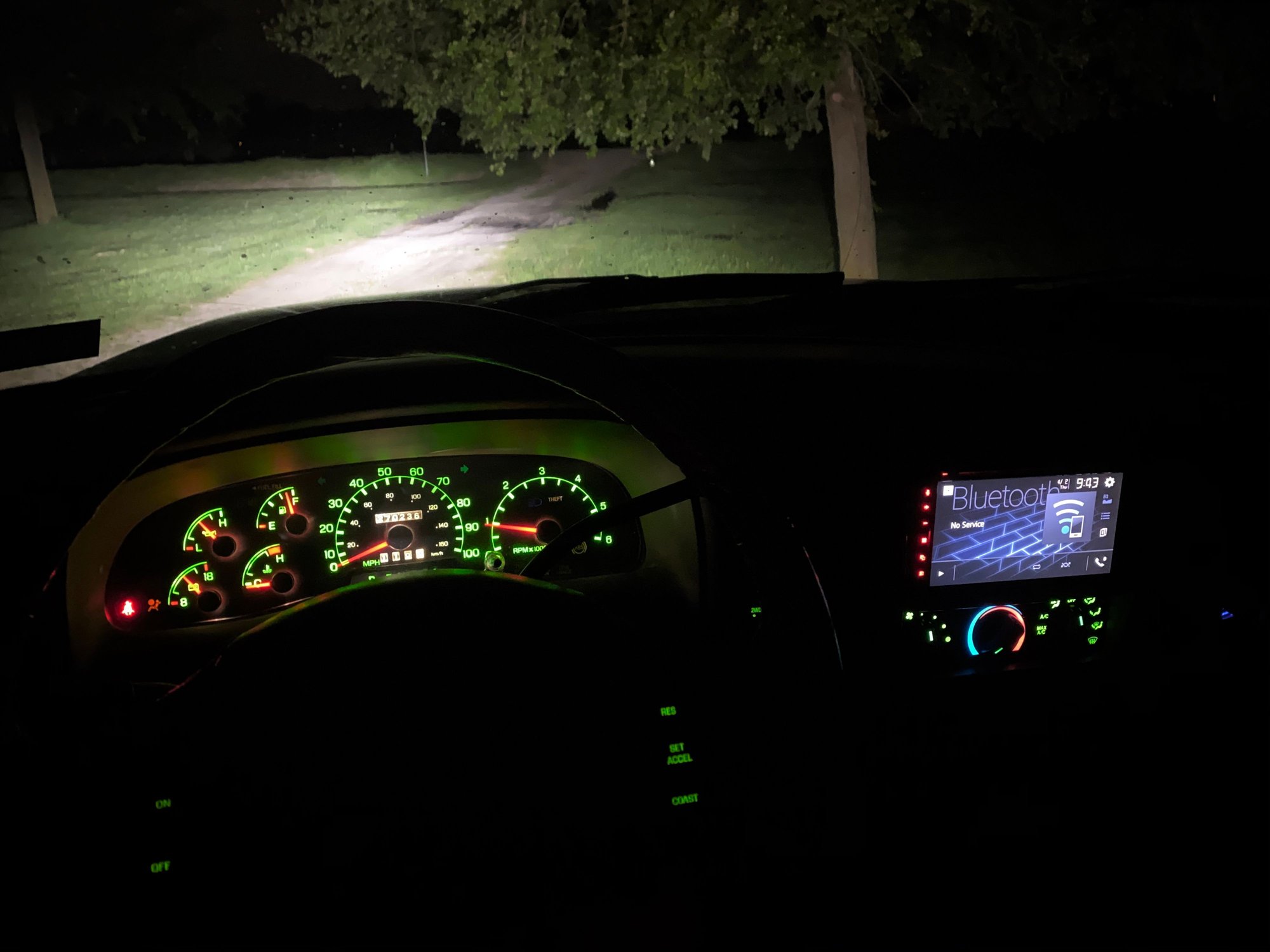

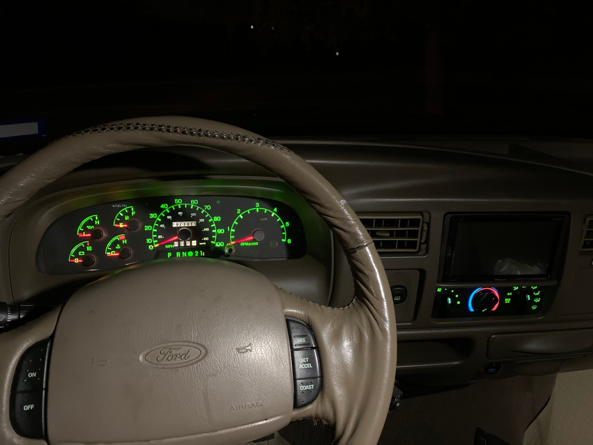

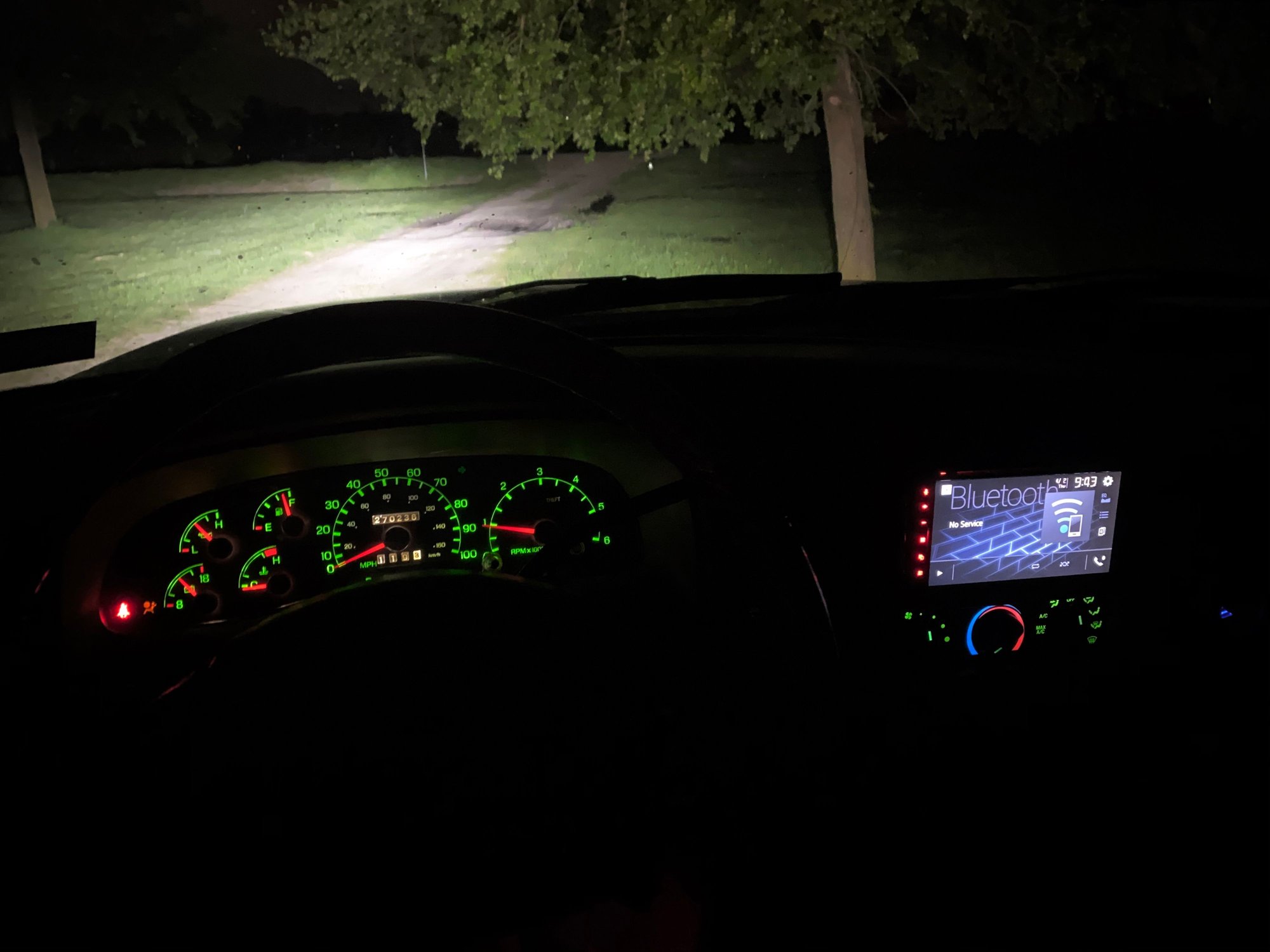

I have a dim spot around 70, but I believe that's an issue with my cluster, since it was there in my before pics.
I gave the Canon a shot tonight, but it has more controls than Bond's car, so I couldn't intuitively find a setting for these night shots. The settings I did find actually looked decent but required a mount to be effective.
So, here's the best I could muster with the iPhone 11. The first pair are with my domes on, so the camera wouldn't auto adjust the light balance. The second pair are typical night-time shots with "night mode" disabled (you'd be shocked at what that mode/setting is capable of, for the record), and I reduced the brilliance setting to -55 on both to more accurately portray the output and not look overly saturated, as phone photos sometimes do.
Hopefully this helps. Cheers

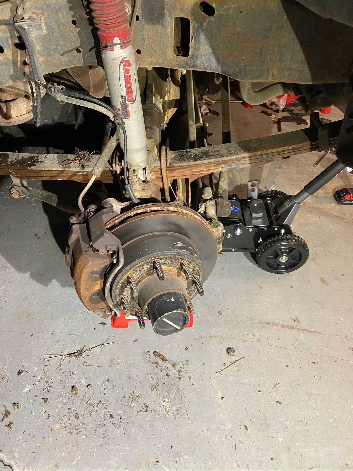

Most of my content for the time being is going to be old stuff that I may or may not have already posted in the What'd You Do thread, but I want to repost it here for the sake of showing my build as I've gone along.

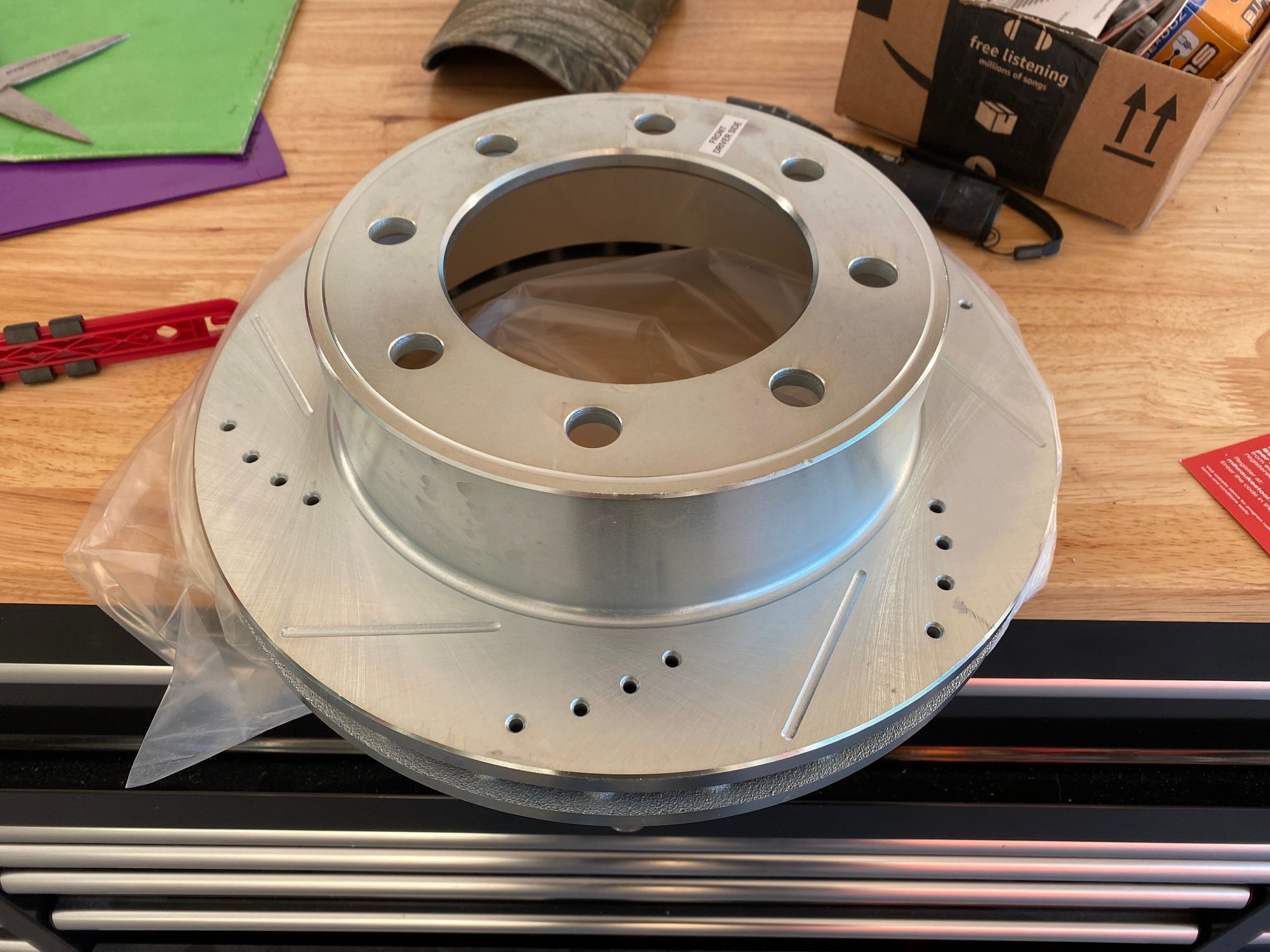

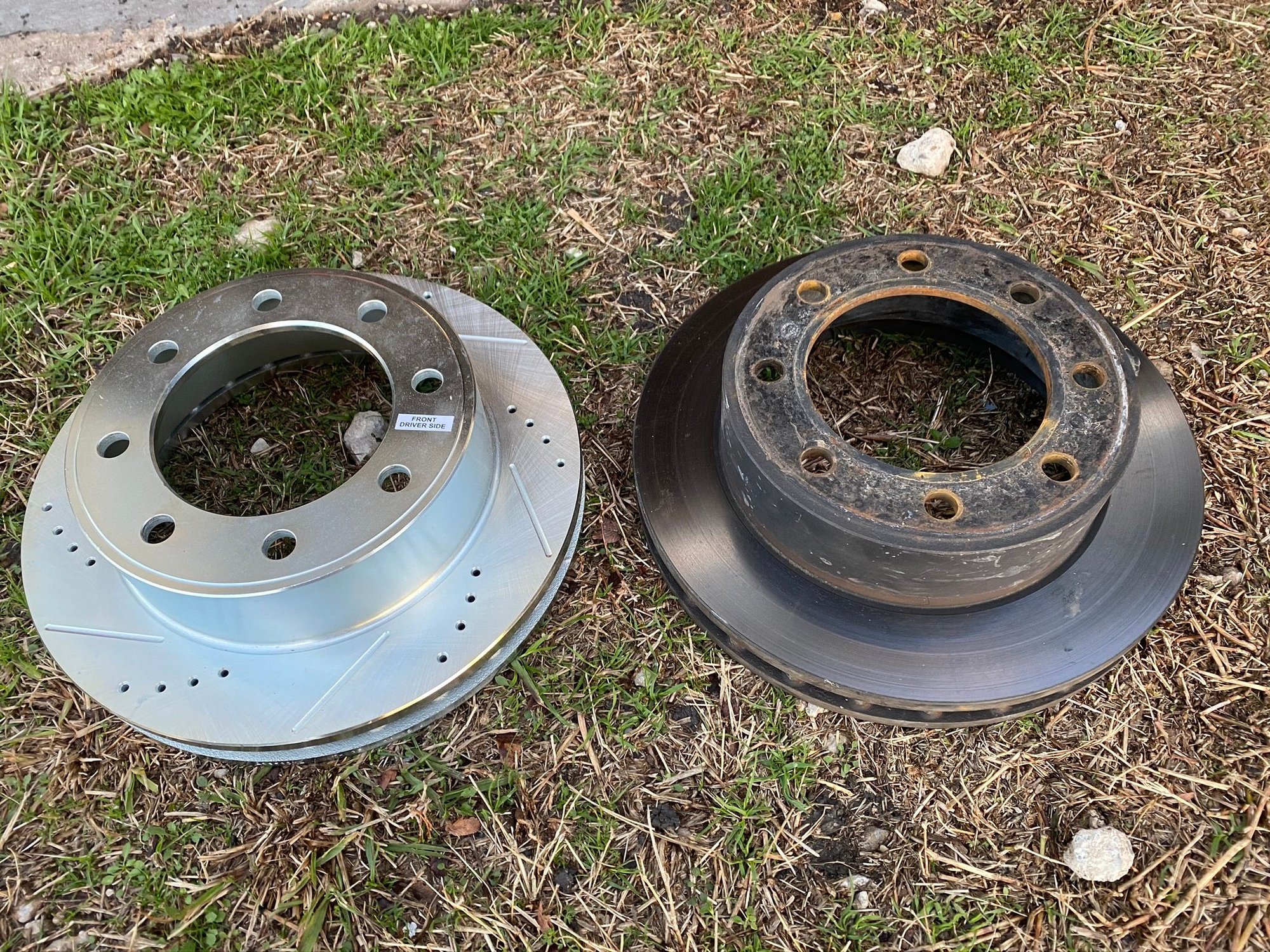

I picked up some Power Stop Z36 brakes on sale from Summit, then they sat in a drawer while life got hectic. When I got around to putting them on, I only took a few pictures.
Wheel off
New rotor on my work bench
Side by side of the two
Backlit through the Eagles.
I still have a bit of a soft pedal in the first half of my travel, so I know I am probably do for a flush/bleed, etc. but I'll tell you what, these babies BITE when you get past the dead zone. I'm on the interstate in and out of Dallas for my work, and with the traffic good brakes is a must-have. I had a few close moments with my original setup, but these new ones can bring my Excursion to a standstill at the snap of a finger. I highly recommend them to anyone needing to redo their brakes.
I still haven't done my rears. I just hate the idea of jacking that back end up on my gravel/dirt driveway. At least I can nose the front in to my garage.
