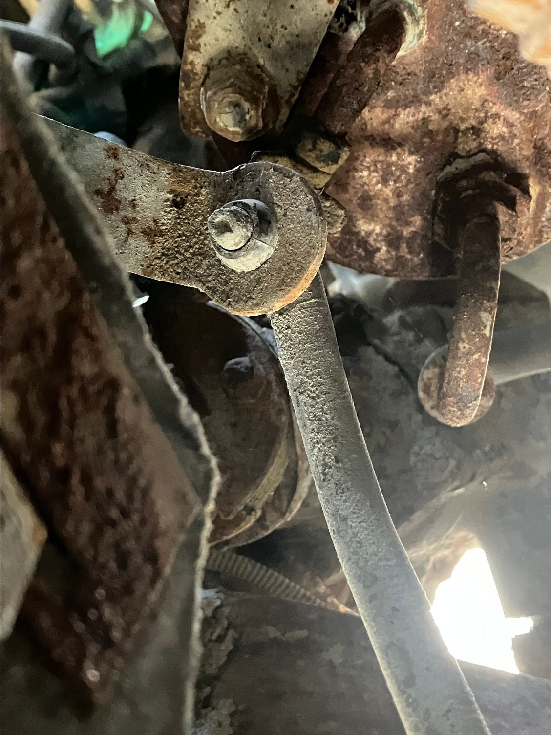

so my first issue is disconnecting the transmission shifting arm from the tie rod. Once I do that, I’m not sure if the steering will disconnect and everything will come out freely or not, but that is clearly necessary.
As suggested, pix:
This is a view of the arm on the column attached to a tie rod. Unfortunately it is awful access but I snuck my phone in to get a pic.

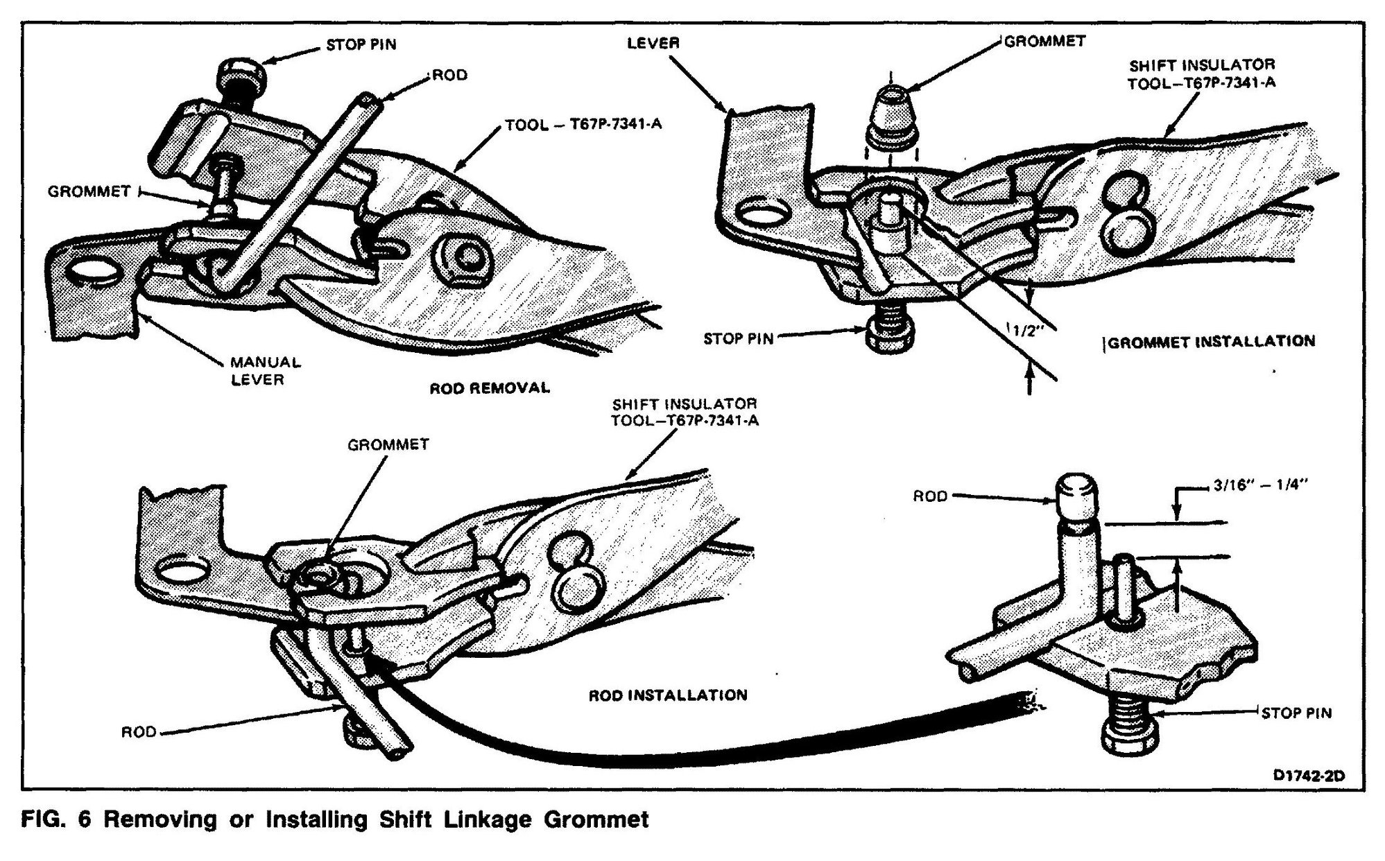

I looked through my 88 service manual and it doesn't give detailed instructions except to "remove the shiftier rod".
In my experience you should be able to use a long screw driver or small pry bar between the rod and lever arm (green arrow) and pop the rod out of the grommet. Another way would be to use a long handle pair of needle noise pliers, maybe even bent noise pliers, on the rod at the red arrow and backside of the lever arm to pop the rod out.
Try a little spray cleaner followed by some lubricant first. There are replacement bushings also.
My manual being for a 88 econoline only shows the AOD linkage and the instructions again are vague. It says nothing about removing the snifter lever arm but just to pull the column out once you have everything loose.
Ah. farther down the page was a diagram showing a special tool for the shifter arm removal and instillation. I have seen other similar tools. Do a search on shifter grommet tool. BUT I believe you can do it without the tool. It's just a bit more work!

Use some lube and a big screwdriver. It just pops off with mighty force
Going back together you need lube and big channel locks
