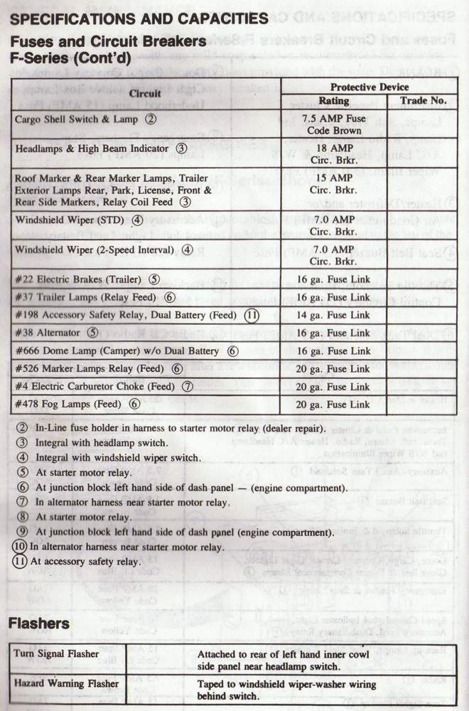

I am going to say it because you earned it. That is why they are color coded. And the is why the positive is closest to the starter solenoid, hence the RED short wire. So OK NO red cable, get some red duct tape and wrap the + cable. And get the color coded plastic battery connection covers and install them. Then check the fusible link just down stream of the starter solenoid in the main harness, orange and says Fusible link. Even it it LOOKS good, is the wire up stream or down stream of the link stretchy or bubbled?? Then check all the fuses under the dash.
https://www.ford-trucks.com/forums/1...ble-links.html
