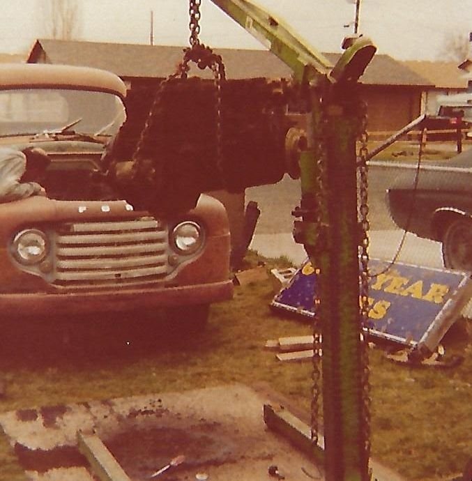

It can be done. Like Ross said, it does have to go up a ways. Back before I knew anything, that's how I did it on my first truck. I was 15 and that's my Dad's head poking in the hole. Held the trans up with a chain. Rented a large tow behind cherry picker from the local rental store to make it happen.

Can I just acknowledge how much "awesome" is in this picture?
