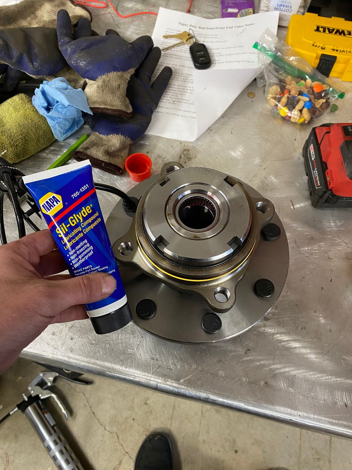

Get some O-rings grease and lube the O-rings on the back of the Timken Bearing that most fail to mention. This helps insure
that you don't pinch it and it seats properly during install.

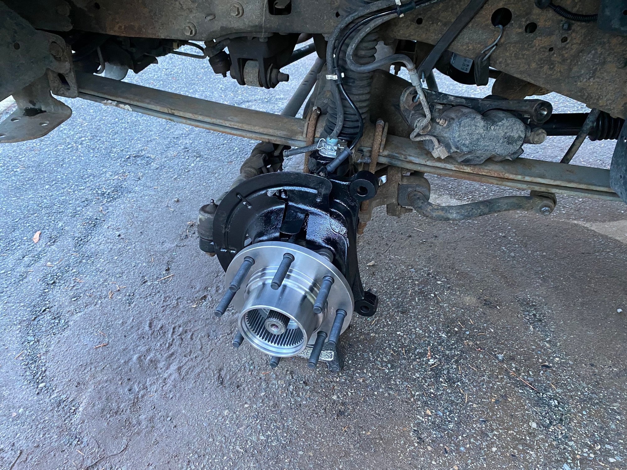

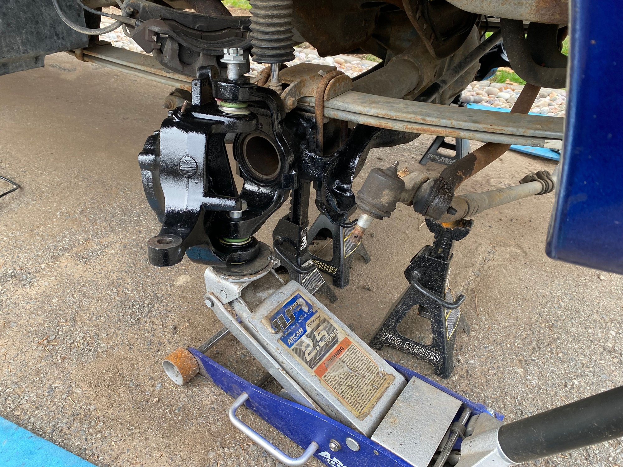

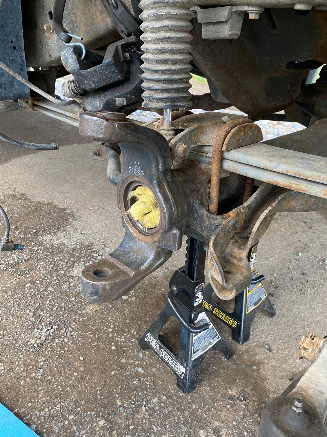

Here's some pics, have a lot as alot of guys I work with ask how to do it themselves so I snap pics as I go usually.
Hub Puller,
Hub Removed
New Ball Joints Installed, Paint Prep
Wire Wheeled off A TON of dirt.
Looks good! Ball Joints feel nice and solid.
Painted
New U-Joints installed
Installing, used a floor jack to hold it in place. Tighten in the correct order!
O-Ring lube
All together.
Hub cleaning, repacking.
