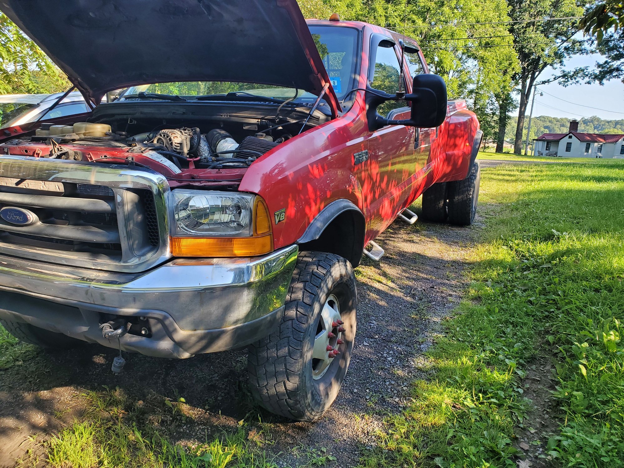

Early 1999 (8/98) F350 4x4 Crew, 7.3 Power Stroke turbo, 4R100, 243k
I replaced the downpipe on my truck and now have a constant SES light. I installed a Diamond Eye 4" aluminized downpipe from Riffraff. Truck seems to be running well enough, lots quieter.
All connections removed were properly replaced. I did disconnect the batteries. I removed the passenger side intercooler pipe and replaced it as I found it. I've only put about 12 miles on it thus far.
Any thoughts as to why this is happening?
