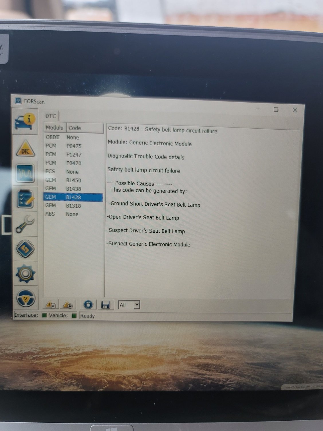

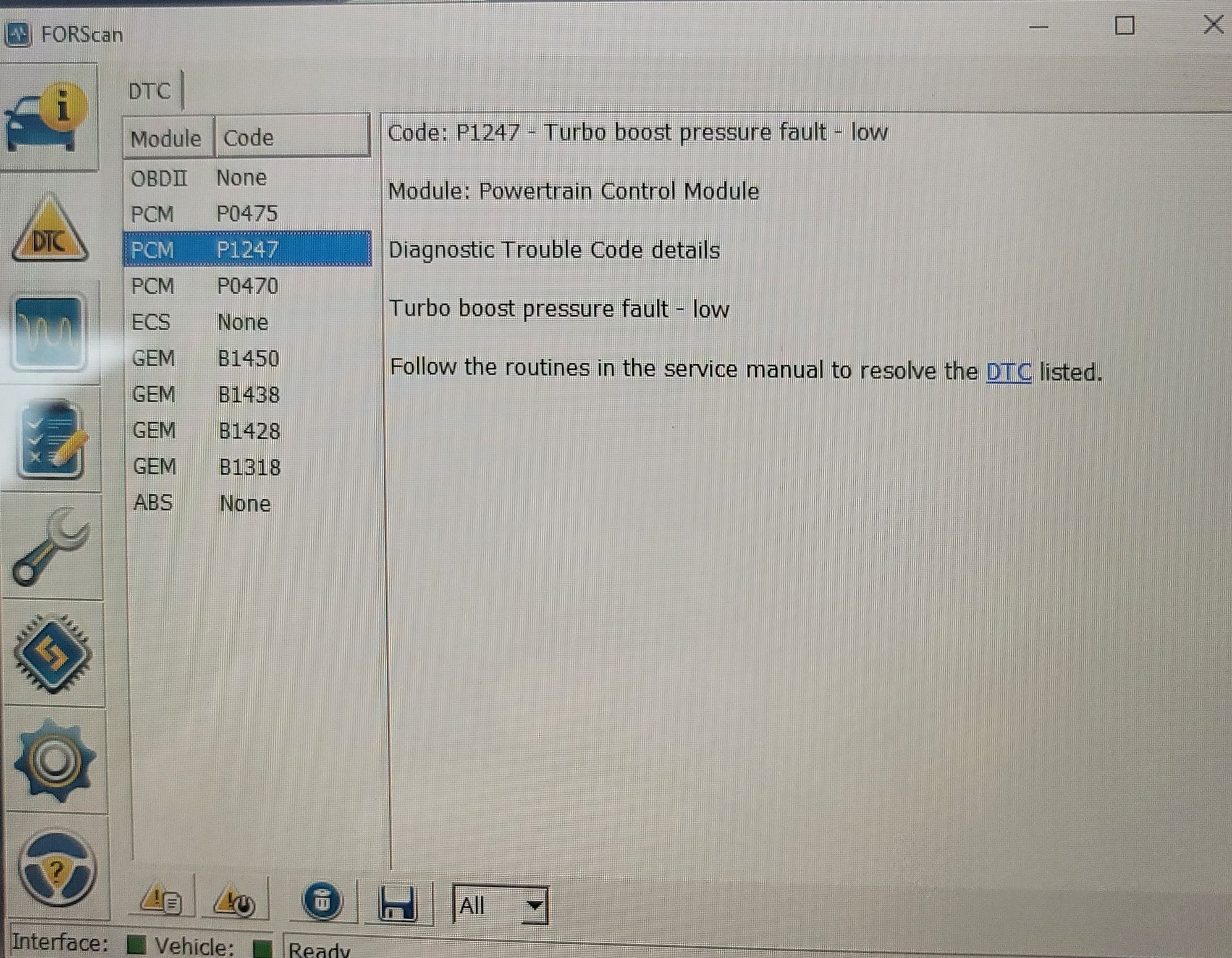

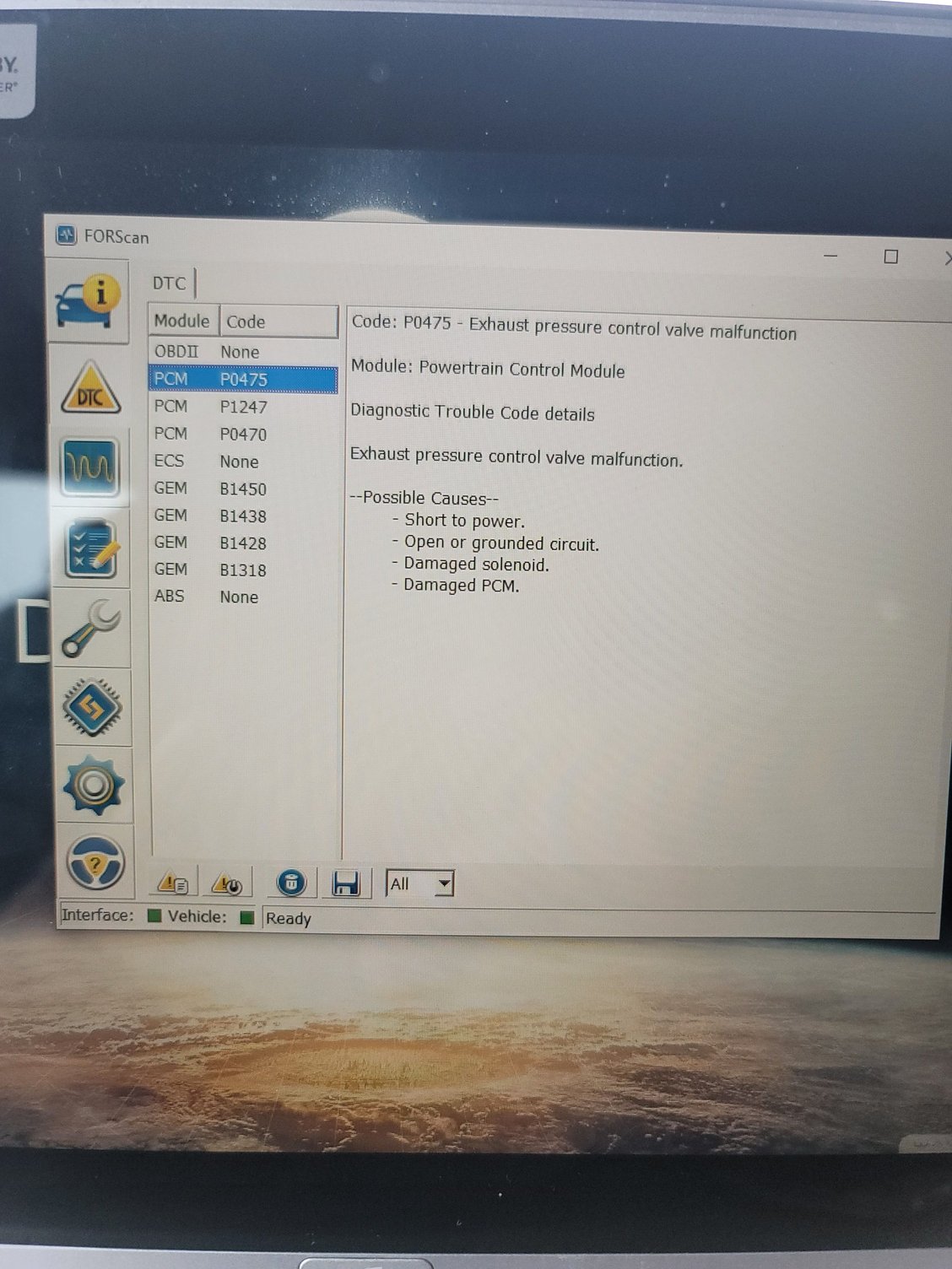

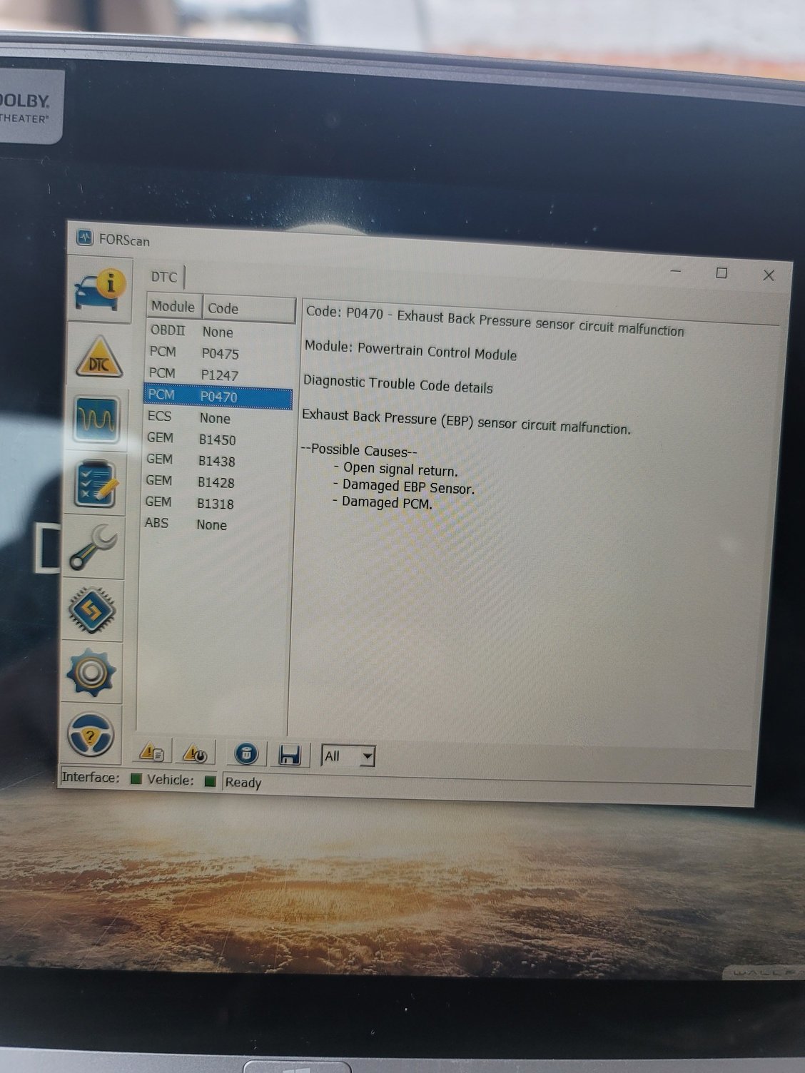

Here all all the dtc im getting, engine running. Did have low battery before start, but that one dropped off.

This is the only result of the key on, engine running, on demand self test.
start up this morning, about 42 degrees, heater plugged in, took 4 looong cranks. Cloud of light grey/white smoke, that was present less than 30 seconds.

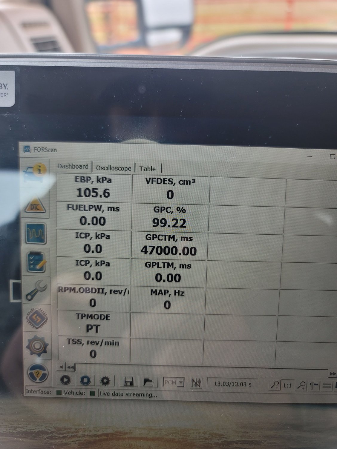

Since this actually got started with questions about the glow plugs.....
lamp time never came on, for whatever reason. The other two glow plug monitors, read as the picture states. now, if i understand correctly, this still doesnt mean the relay or glowplugs themselves are good, just that the truck is calling for, amd semding power for that purpose?

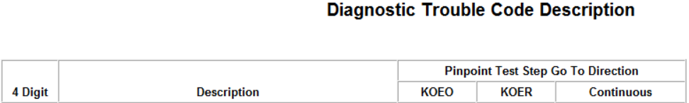

This is the result of the key on, engine off self test.

The GEM (B - DTC's) are pretty self explanatory. Although, the portions of the manual describing those areas that need attention can be uploaded as well.
The GP PID's you are monitoring may be for a GPCM (Glow Plug Control Module), which you don't have in a F-250. Change your measurements from kpa to PSI on things like the EBP sensor to make them easier to read. MAP, BARO and EBP should be within .5 PSI of each other on a cold engine with the engine off, but the ignition on.
