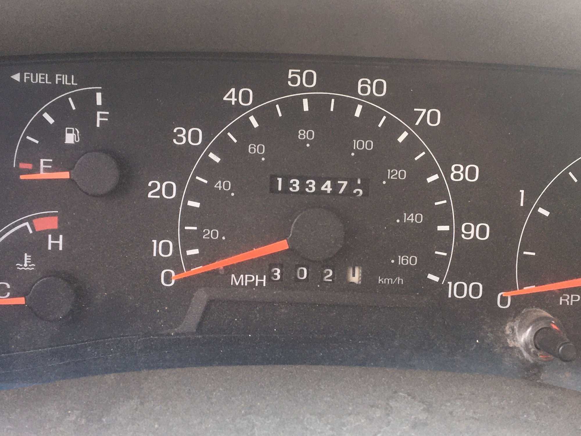

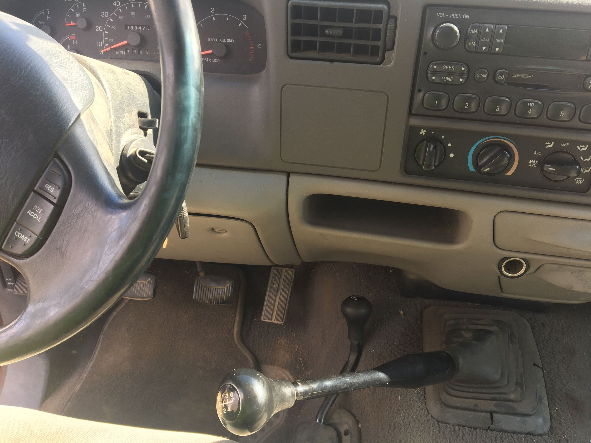

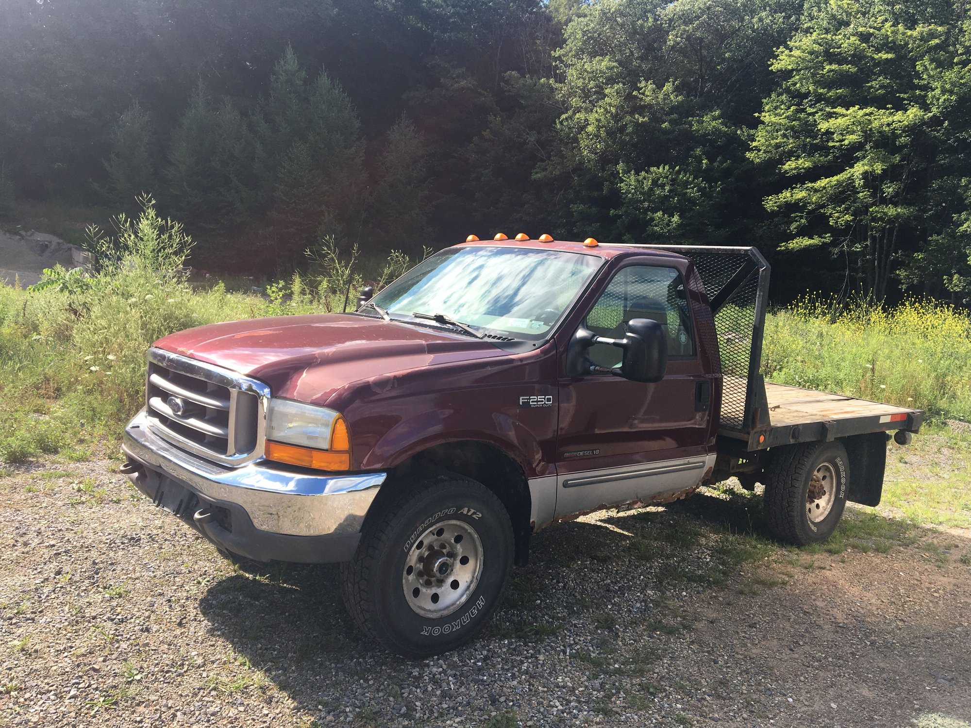

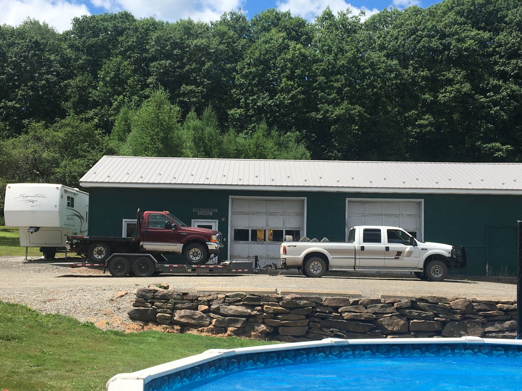

I am officially done messing around. I picked up a parts truck today, L99 zf6 with a manual t case and 133k on the clock. It fires right up and runs/idles smooth and shifts well. It has a new clutch, and oil pan, but I will redo the pan as it is somewhat leaking because someone did it in the truck with the cross member cut out, it didn't seal well with oil running down on sealer as it set. The truck will retain the stock injectors in the engine and stay almost entirely stock.
Initial observations of the engine are good. I will be doing a compression test and a thorough evaluation of the engine before removal.
The flatbed is useable, but a bit light duty for my use on my other truck for plowing. Tue cab and frame are rotted junk. Axles are useable(sellable)
Rims and tires are good, 4 spare aluminum rims came with it too.
All in all, not a bad deal for $2,500

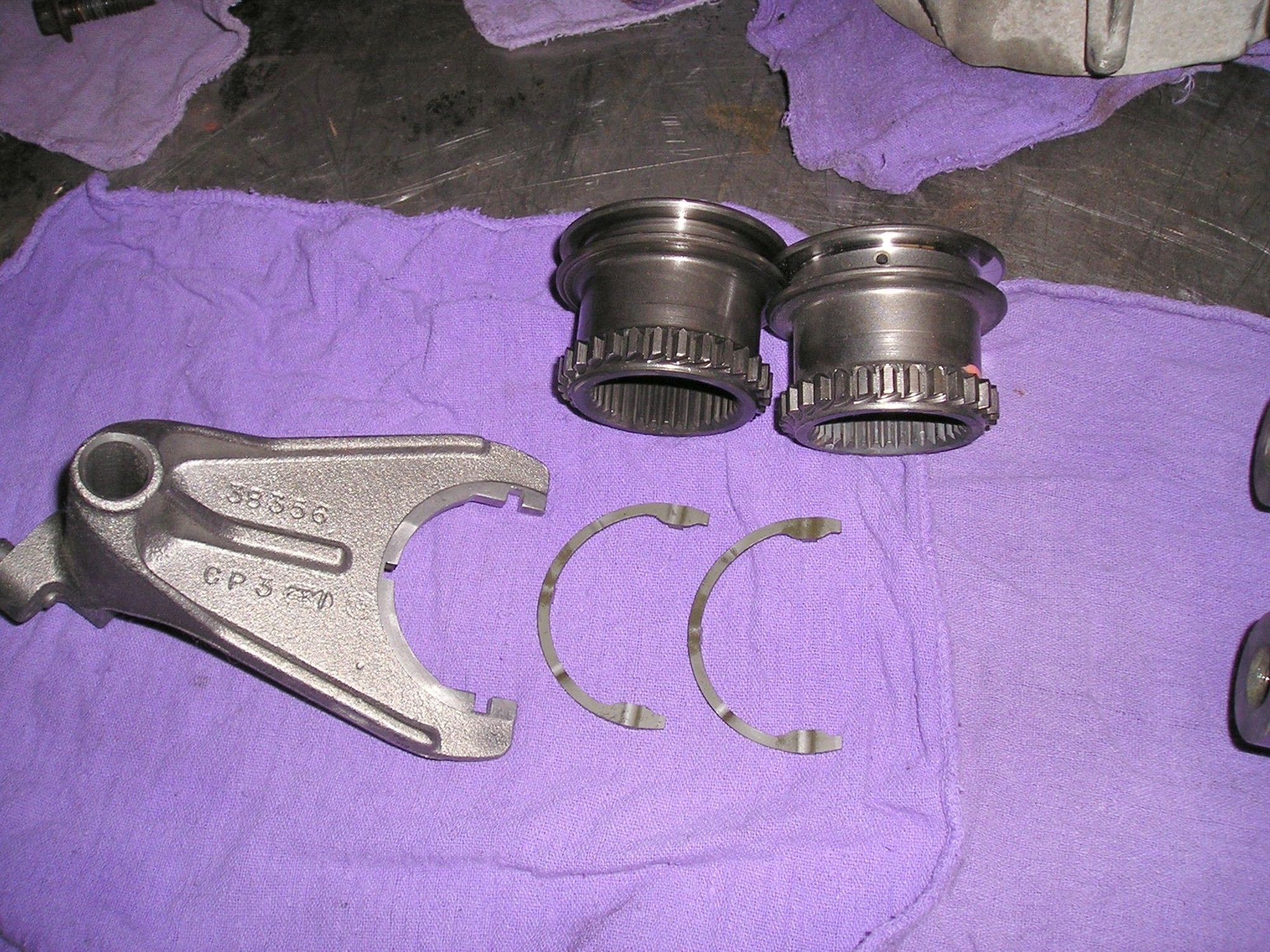

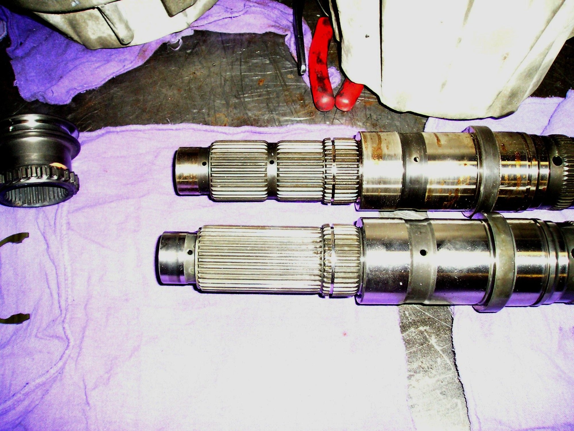

May I offer some voice of experience here, please? I have the exact same model year as yours. Same drivetrain as well. Mechanical transfer case, etc. There was a design flaw in the transfer case that will leave you stranded without any warning due to the fact that the mainshaft wasn't manufactured with an oiling passage to lubricate the shift fork. End result is that the splashing that the engineers were relying upon to keep everything lubed up was inadequate. I was left stranded on the top of Mount Rainier, WA with a truck that wouldn't move under it's own power, period. Had to tow it back home and leave the RV in the campsite where I had just booked a few nights as a maiden voyage.
Recommend you drain the transfer case ATF and look for ANY sign of melted plastic. What that is, is the ends of the shift fork and mine were ground away to nothing. And there was ZERO warning signs.

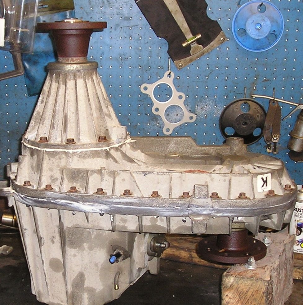

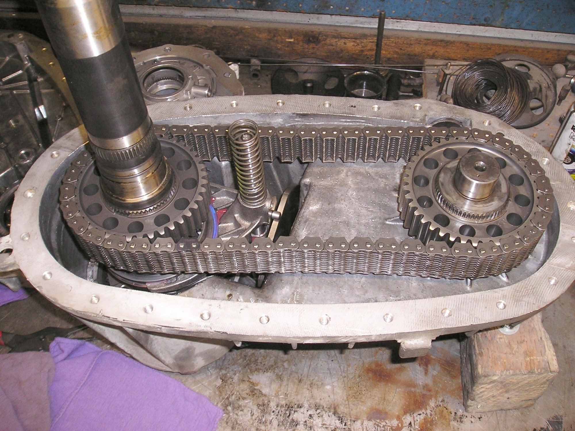

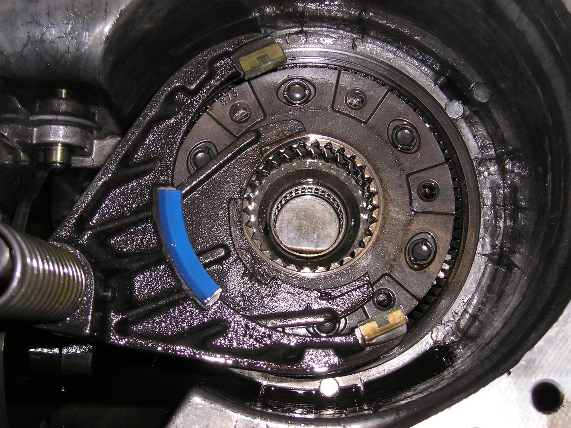

I was sent a link to a rebuild kit that contained a mainshaft with an oiler passage machined into the assembly. It was a fairly easy job, once I got it apart. I have diagrams for the job saved to my computer, if you are interested send me a PM and I will email them to you.
Pictures of the job that I found that were still on my hard drive.
EDIT. It took me a couple of minutes to pick it out, but the shift fork that failed is in the first picture, sticking out below the larger shift fork that still appears to be ok. Kind hiding in plain sight and it doesn't look much like a shift fork because it's missing all it's teeth.
Compare the old shift fork with the new, and much more robust design. It's the smaller of the two shift forks and there are no teeth left..
Upper shaft is the one with the oiling passage.
Updated shift fork. Note the metal thrust bearings now, and gear with oiling passage, instead of plastic little ears.

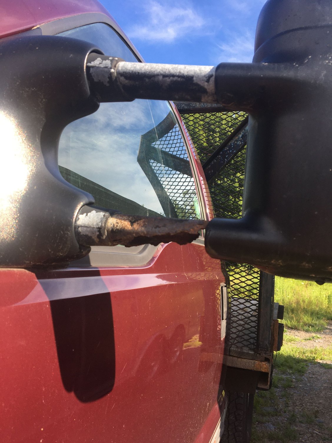

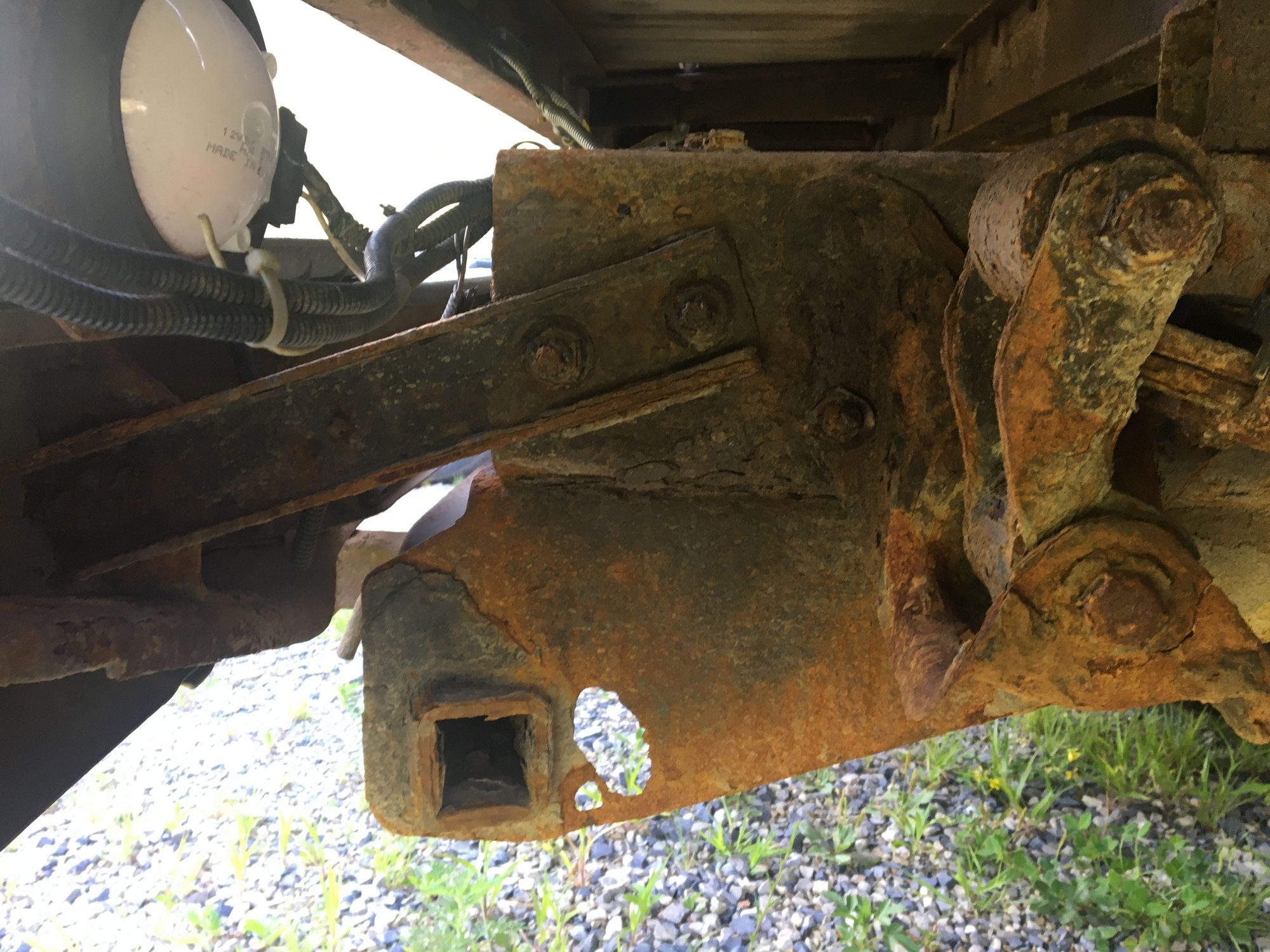

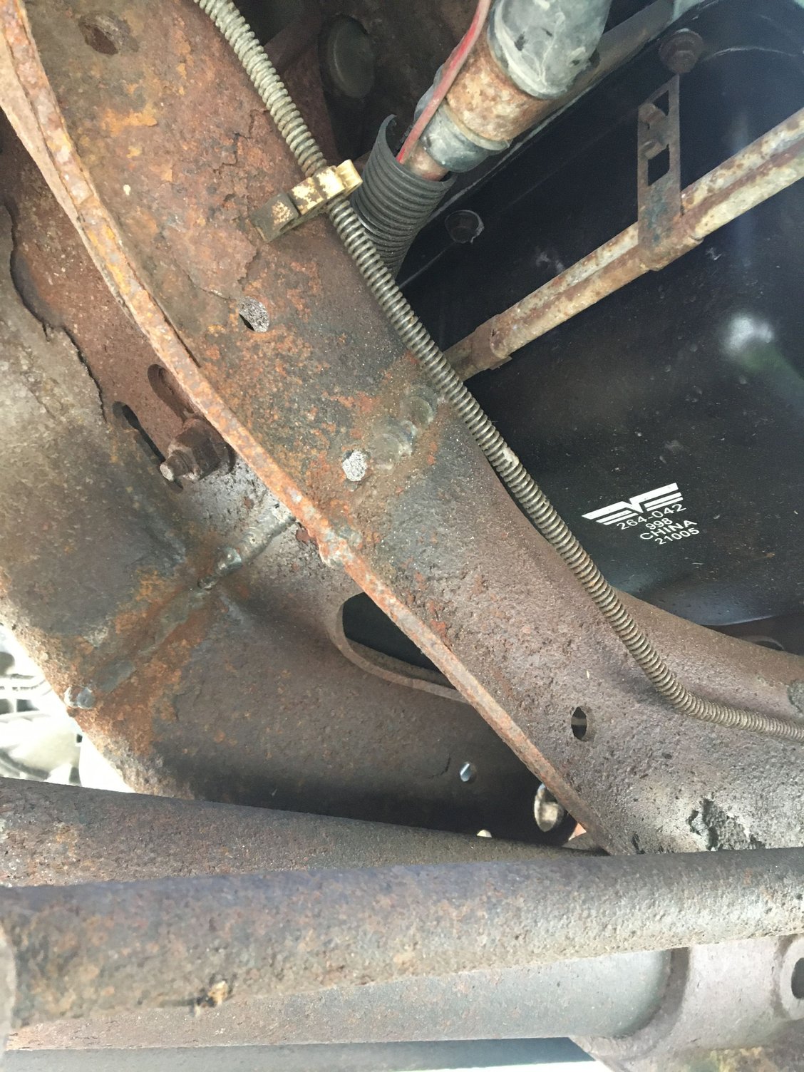

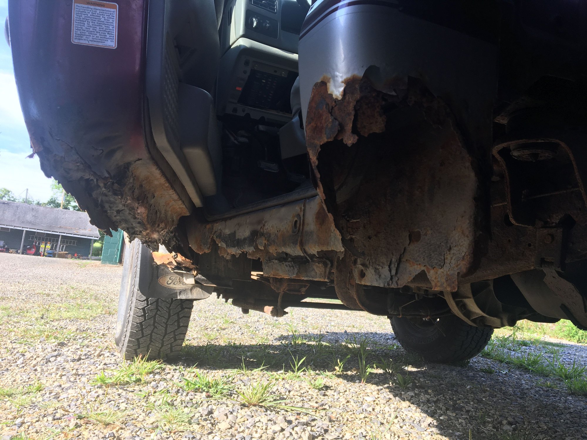

It’s a shame what NY winters did to this parts truck

Oh come on Eric, that'll buff out

That is one rotted out truck. Very grateful I don't live in the rust belt.
It's a shame that residents of states like that ALLOW the D.O.T. to do that to privately-owned vehicles.
