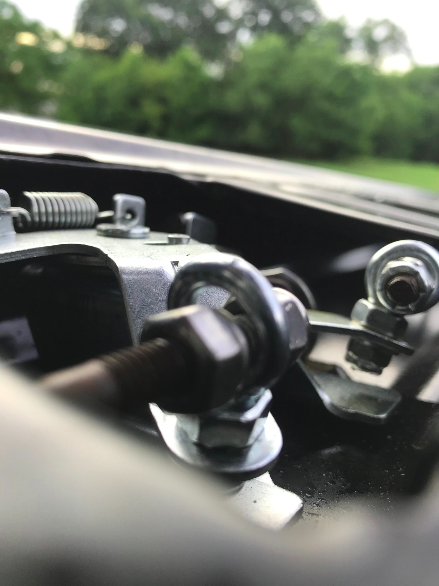

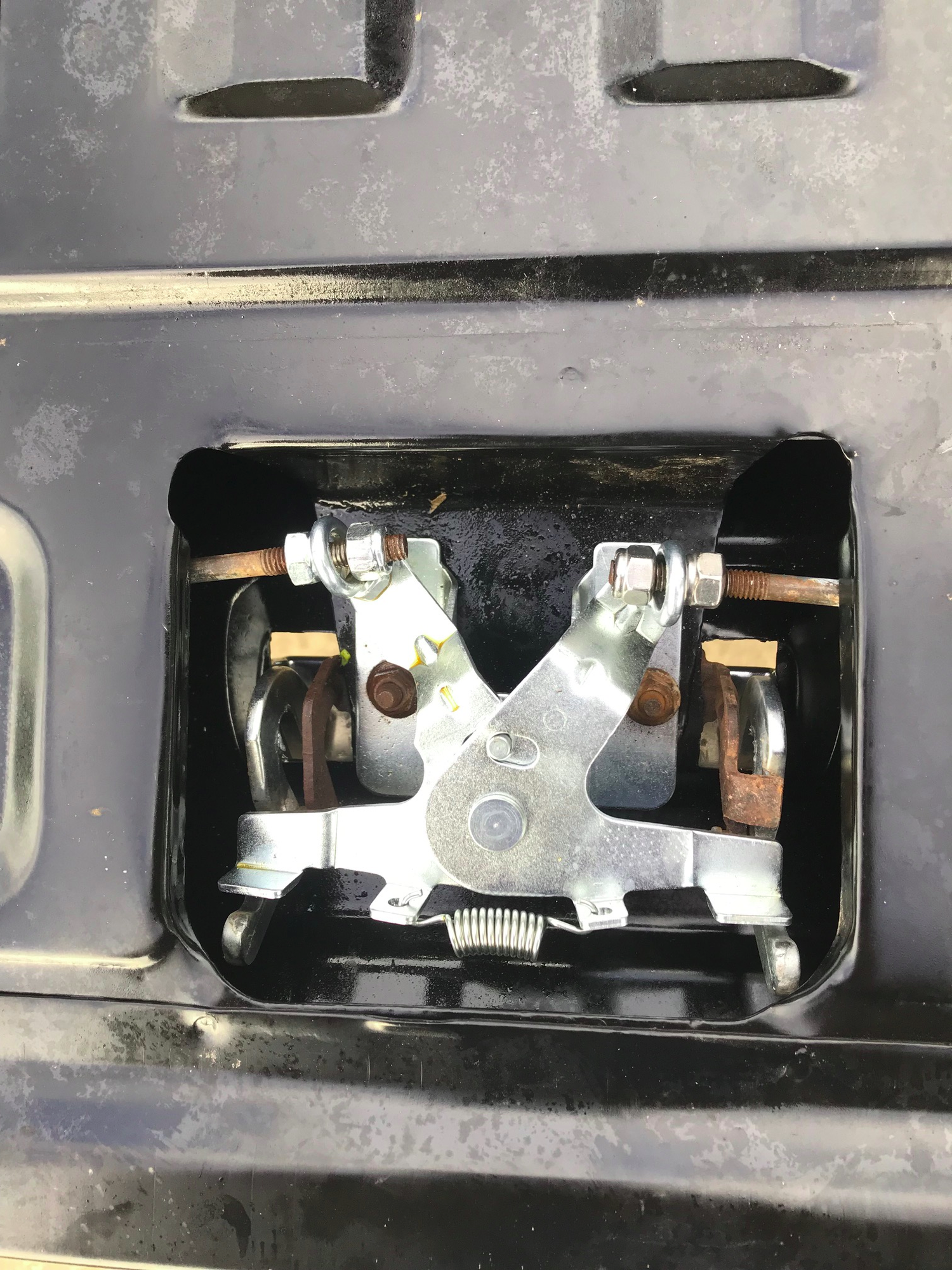

My tailgate would not open again today. Seems like I have to replace those clips every year. I fixed it with metal hardware this time and thought I would share.
I took the latch off and put the arms in a vise. I put an eye bolt 10-24 machine threads through the latch arm, I had to use a 1/4 nut as a spacer because it had a small shank. 10-24 nylock nut on the back side, tightened and then cut the threads off that extended past the nylock nut.
The rods are 1/4-28 thread and I put a nylock nut on either side of the eye bolt.
No more broken plastic clips.

I didn't know about adjusting the plastic clips, but where they fold over the tip and clip to themselves is where I have been breaking them. That top flap breaks off.
