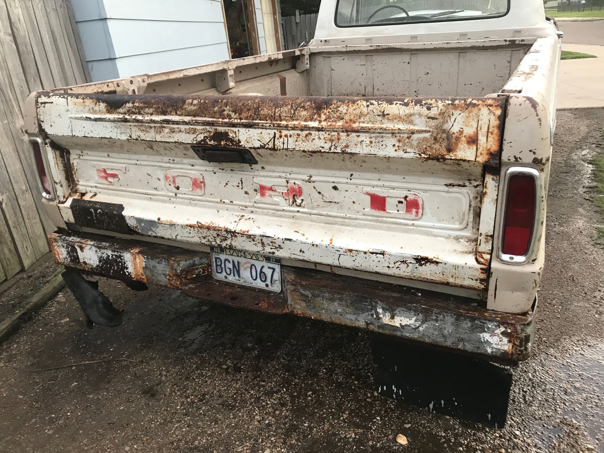

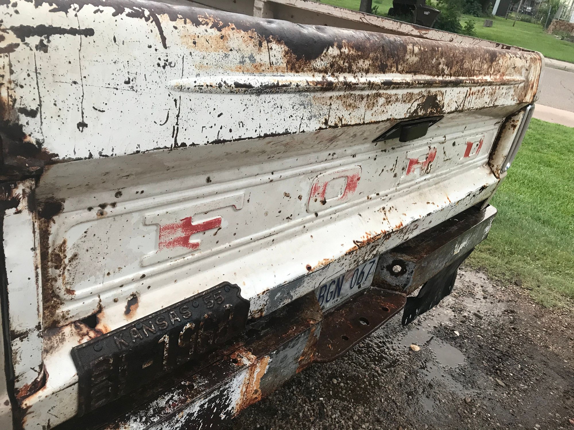

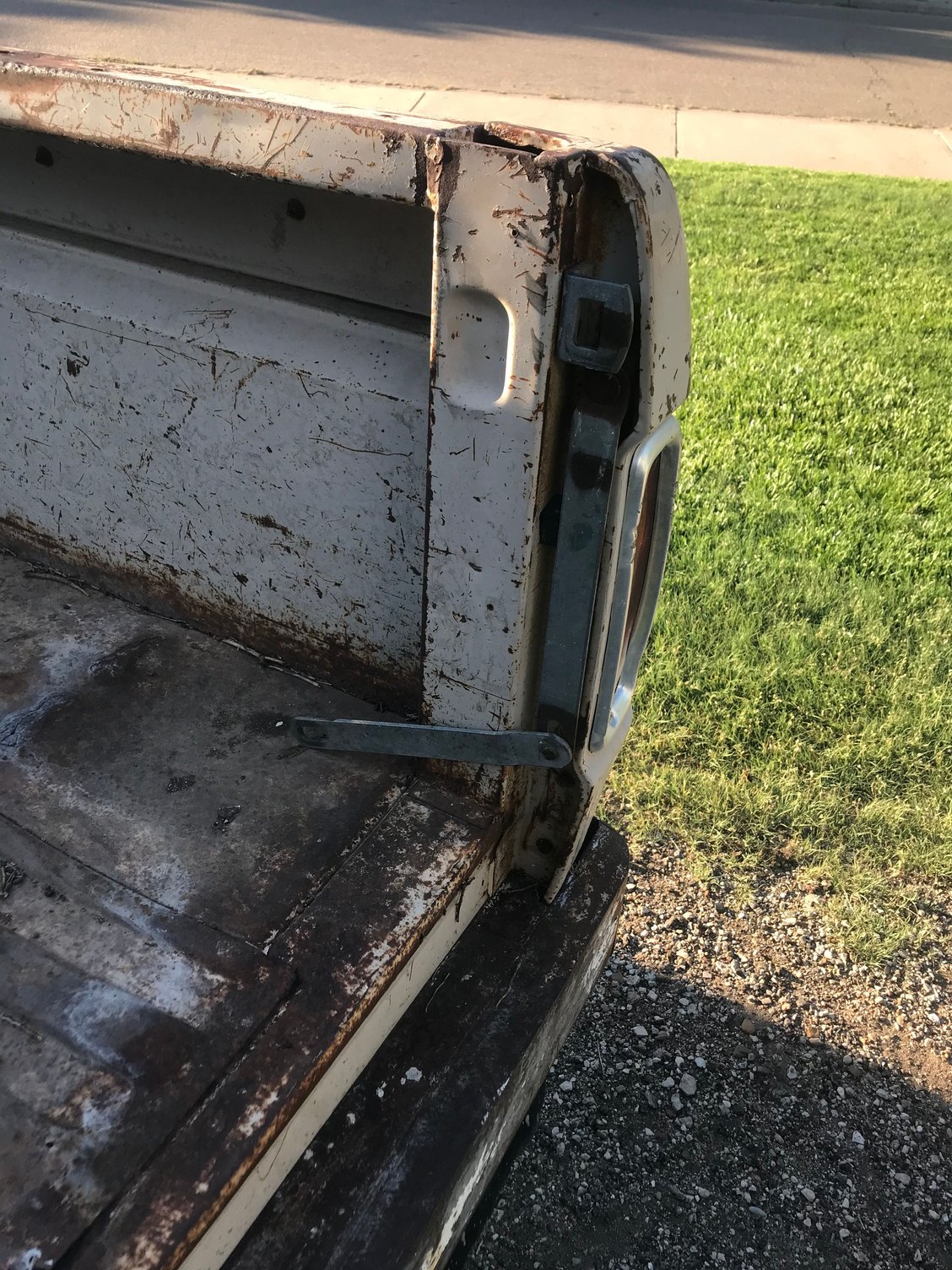

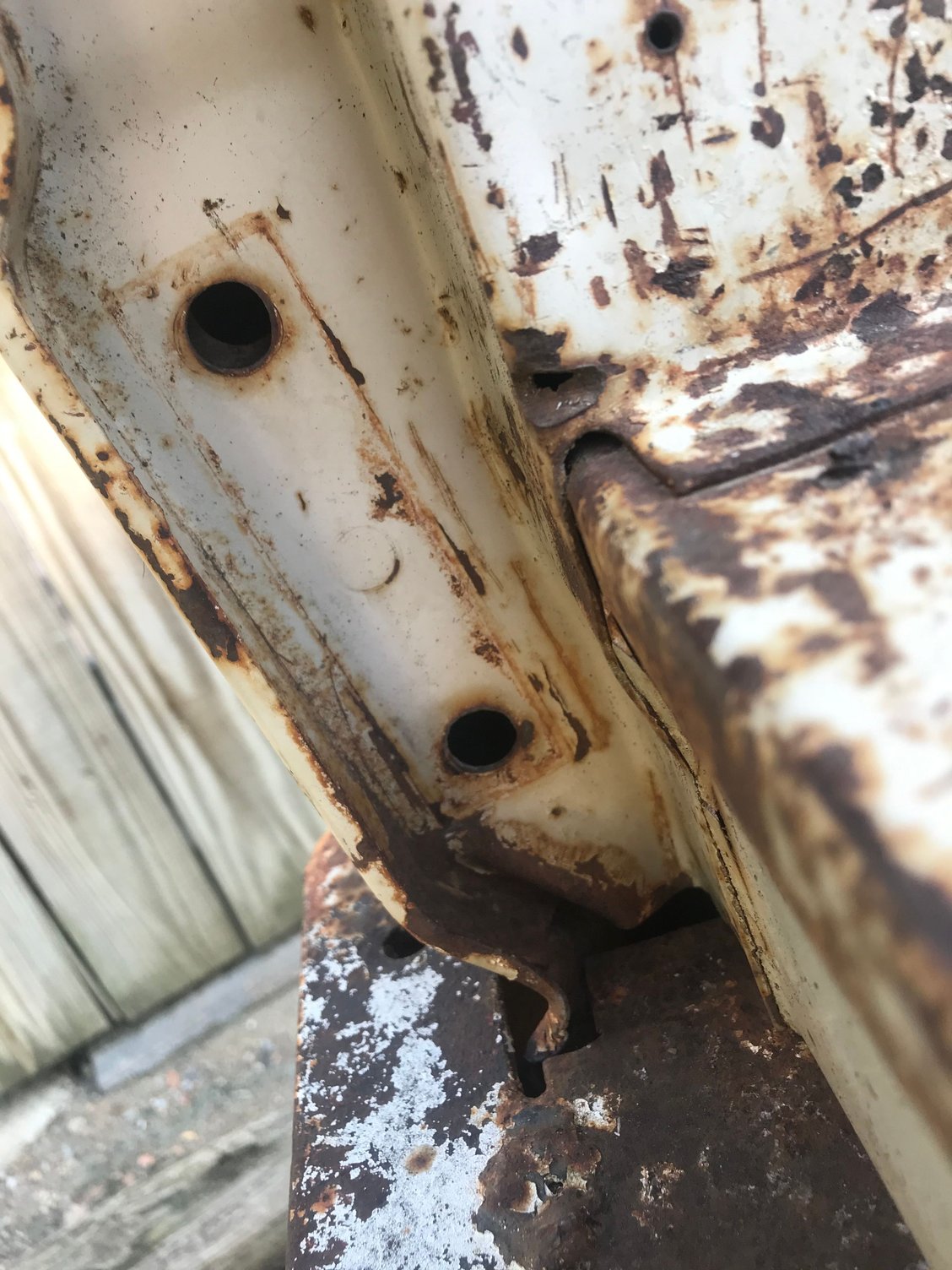

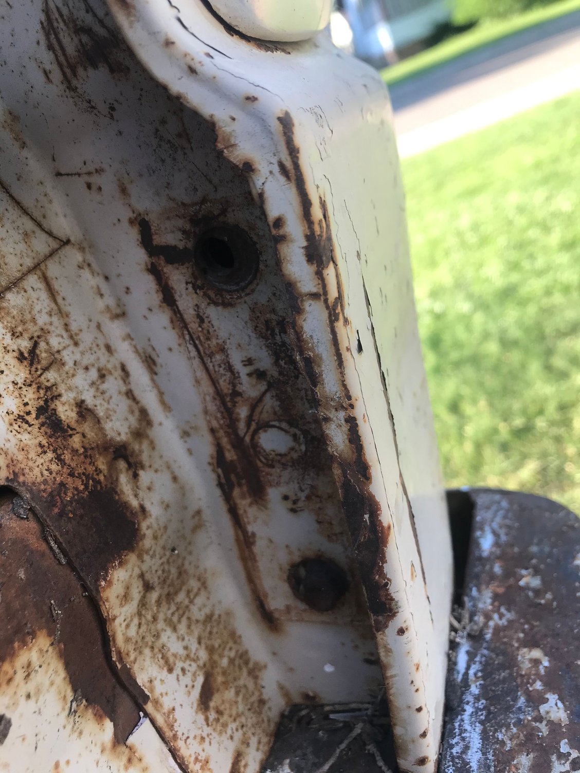

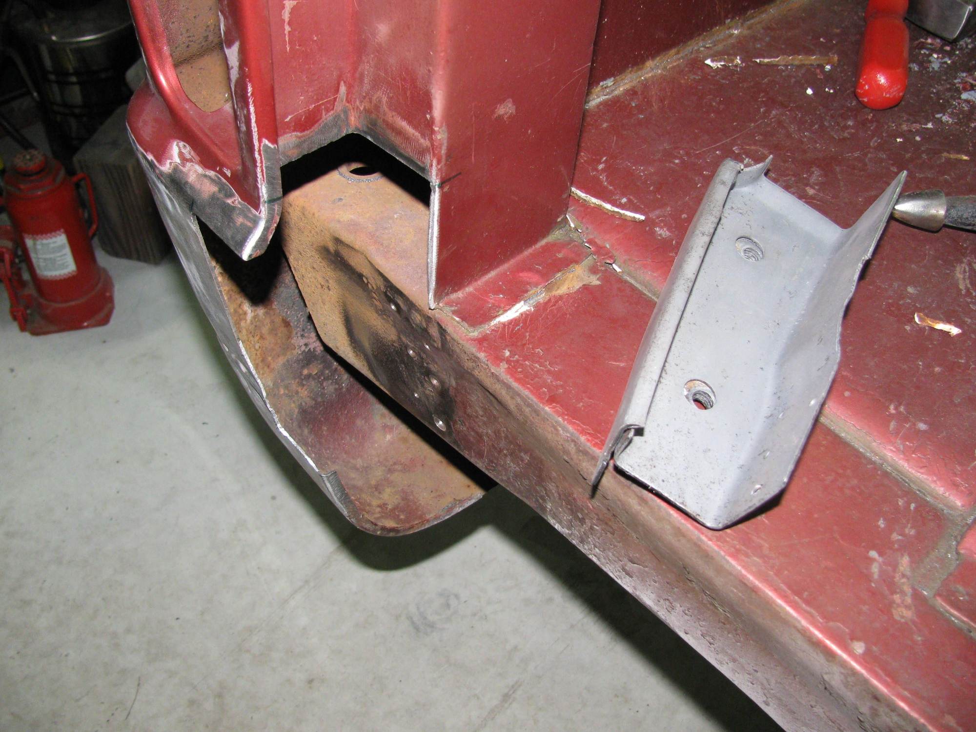

How should I mount my tailgate the bottom pieces where the bolts thread to one is gone and the other has a stuck bolt so how should I go about mounting it thanks

Sounds like its time for a couple new nut plates. I’m not sure what is the easiest way to cut her open and get em in there. Some may suggest nutserts or other substitutes, but you need the backing plate in a “cage” so that you can adjust the mounting position of the tailgate.

I think your only hope without major surgery on that is to take the taillights out and the bumper off. Find a couple of helpers with small hands and try to get it on with regular nuts and washers. Good Luck.
My truck bed had been hit hard in the left corner and I had to cut that part out and weld in a piece from a donor truck. Not to mention a lot of hydraulic persuasion to get it all back plum, level and square.

For the stuck bolt, I would apply heat and penetrating oil

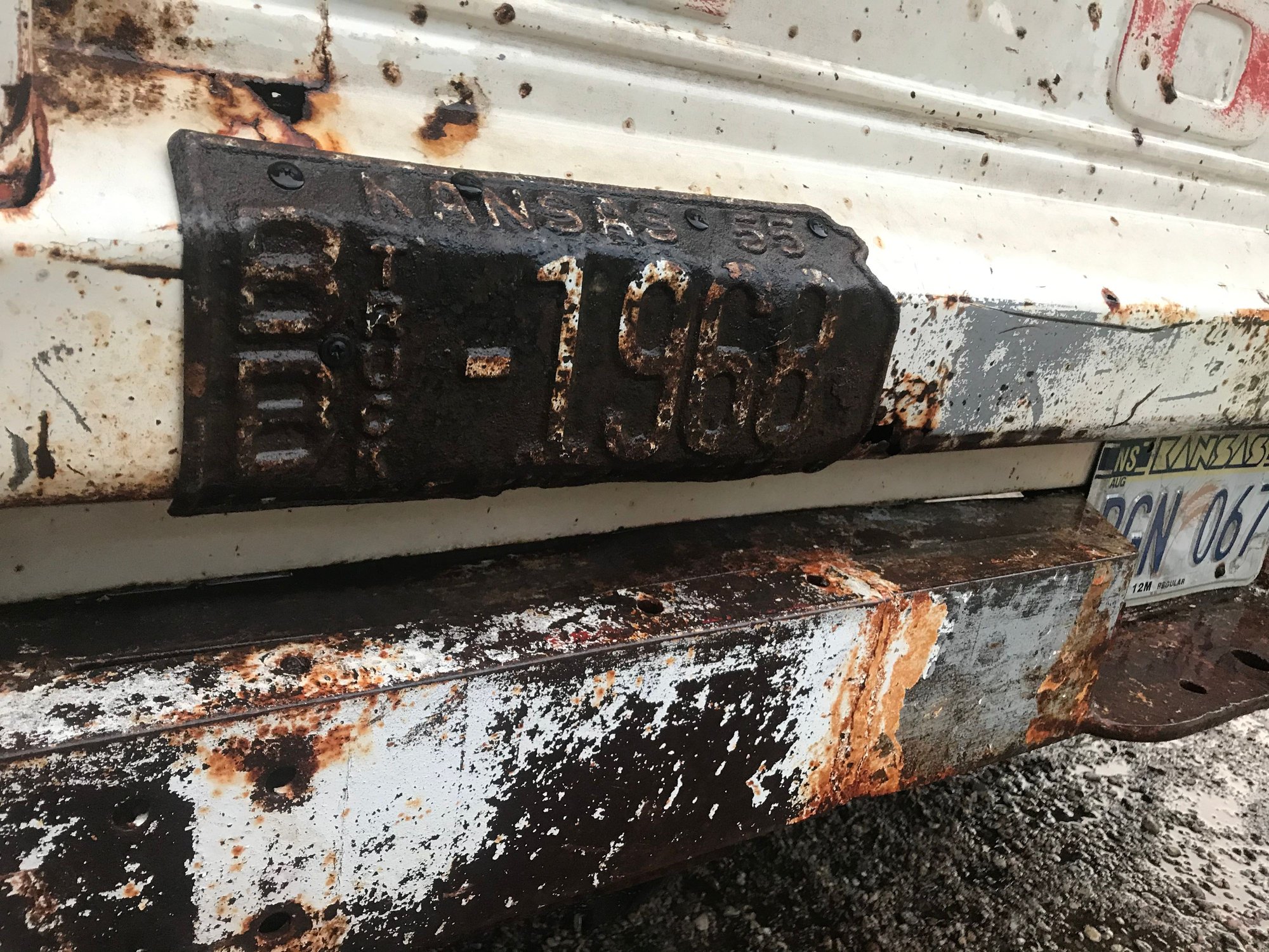

Tailgate is on
It was a pain the *** but it’s on and working I even patched the hole in the tailgate with a 1955 Kansas license plate
