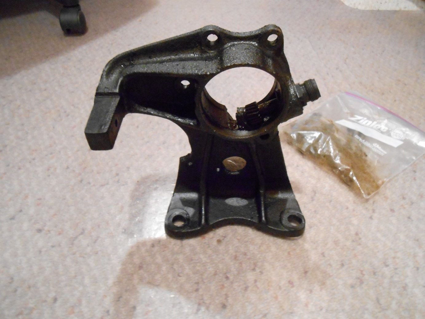

I have this available. Pretty sure it is for the T-98. There is also the driveshaft flange and a bag of misc. bolts. For the driveshaft flange: U-joint cap diameter holes are 1 1/8" for a 4" wide U-joint. Mount hole is 2.5" by 2 7/8"
The carrier mount has no apparent cracks or damage but is used of course. Can take more measurements of each, if needed.

Tom, that's the crashbox bearing retainer. It's easily identified by the foot facing rearward from the trans. The T98 gearbox is longer, so the foot faces forward. You can see the difference in the parts book drawings I posted. The T98 exploded view shows a good look at the foot of the retainer with the bolt holes ahead of the retainer. The mount view below it shows the orientation of the foot, with bolt holes behind the mounting face, as is all the other trans designs. The T98 retainer may also be marked with the part number prefix, 8MTH. Markings on a crashbox part may be 01T if for a F4-6, or 01Y or 8 D if for a F2-3.

Oh, thanks Wayne - I see the difference now. You are right - what I have here is not for the T-98. Well, that mount is still free if anyone could use it. Tom
