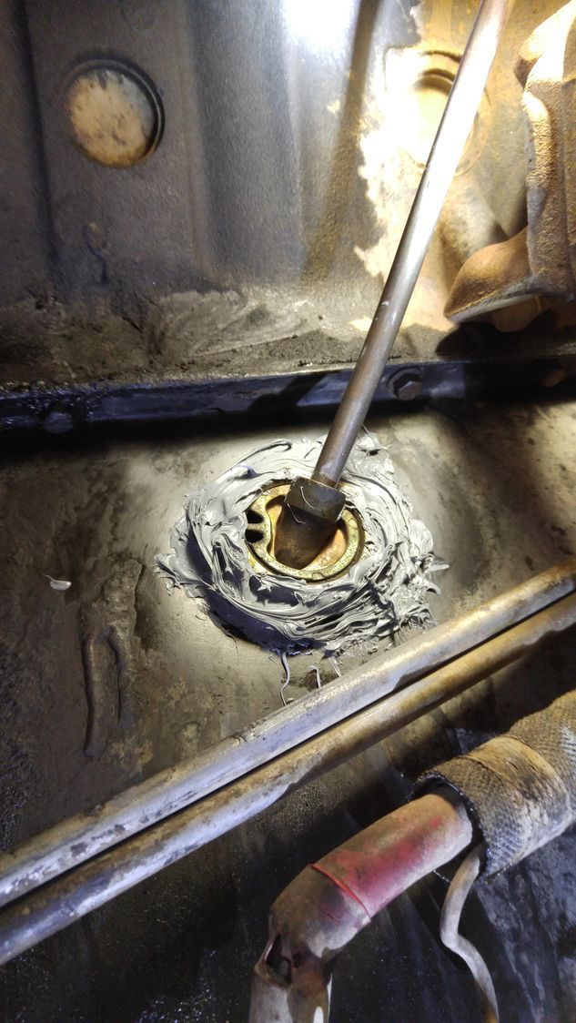

not sure where the dipstick adapter is located.. is that the area the dipstick goes into the pan on the passenger side area?? any pictures of this area.

Yes. It is where the dipstick goes into the pan. It is a common potential leak point. It is on the passenger's side of the oil pan tucked "behind" the starter (picture is with the starter removed):

nice.. thanks.. I did not notice any oil from the dip stick to pan area when I was looking before.. saw more oil on area below the valve cover gasket on rear of passenger head onto the exhaust manifold.. but not thinking it would leak that much. I do know the hoses at the engine for the bypass filter have some drips on them but will have to get under with motor running to see how much. Would not think that much could leak that fricken much... .
