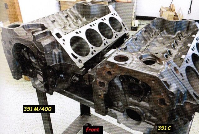

Howdy all. Got a 63 galaxie with a non stock engine in it. Guy I got it from said it was a 351c but I’ve had a few people cast doubt on that.
Any help would be appreciated confirming the identity of this motor. Thank you

I don't see a raised rib in the timing cover part of casting, without that it would identify as a C. Are your block motor mount bolts going straight up like a small block? That would say it's a C. Thermostat opening flush with block would make it a C. Many ways to tell. Intake width is another.

Looks like a C. I will post a link in a bit.
EDIT: SEE POST 5 for what I would have posted if I had found it!

It's at least in the 335 family. 351C/351M/400. I don't know enough about them to identify a C from a 400 or M.

Looks like a C.
