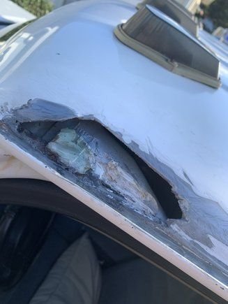

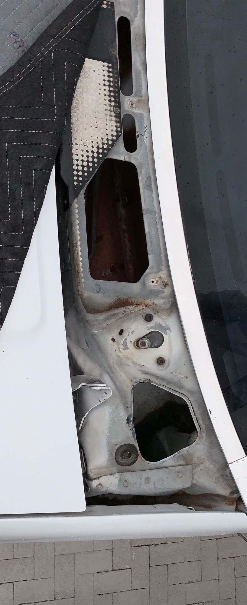

Hello all. I usually post in the diesel section as I have an old f350 but I figured I would post this here since it is a body work question. To start off I’ve got a 1996 Ford F-350 crew cab long bed. I have had some rust issues over the past 7 years I have owned the truck and it is something I would like to get handled as quick as possible. The main areas I am concerned about are the cowl drain area and the roof. It has some bad rust/rot in the drip rails, under the 3rd brake light and around the cab lights. In the cowl drain it is actually rotted through and has caused a leak into the floor of my cab. As I am sure you guys know, this is a very hard area to access as there is no way to really get to it or see it without putting a phone in there and taking pictures or feeling it. So to get to the question, would I be wasting time and money to have this cab fixed the right way when I could swap out the whole cab? I am only leaning away from cab swapping because the floor on my cab is immaculate and has no rust down low plus it is very hard to come by a clean crew cab these days as these trucks are becoming rare and it is a lot of work and I do not have a lift to lift the cab properly. I have temporarily fixed the roof by scraping all the old seam sealer out and wire wheeling/sanding to someone hood metal and re sealing. I also used metal reinforced bondo to fix that hole, which is once again very temporary so don’t make fun of me haha. Anyway I will attach some photos if you guys could give me an honest answer and some direction on what to do next that would be great. I have labeled each photo so you can tell each area.

3rd brake light
Drip rails
Rust hole I grinded down to good metal
Cowl
Cowl drain
Cowl drain

The truck visually overall looks to be nice...... IMHO, if there was a need/reason to have to gut the cab (electrical, etc.) then yes, I would replace but otherwise IMHO I would swag it would take less time to repair versus doing a cab replacement

Thank you for the reply man. That is what is so unfortunate because it really is a clean truck overall and the lower end on the cab is in great shape such as the floor, cab corners etc. I do eventually plan on getting the interior though to do all black interior with a set of either king ranch seats or black superduty seats. Another idea I had was to cut a roof off of a crew cab that has a good roof and having the body shop fab the new roof on. The roof on these old trucks is actually a roof skin/panel that is tig welded on. Ford used to sell the whole roof panel but it is now discontinued.
