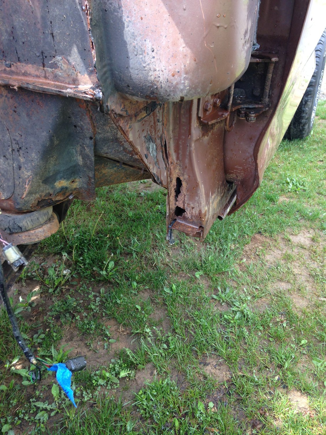

THIS CAB IS RUFF the one good thing is that it has good cab corners but besides that its a loss I think.
removed the fenders to find this lovely hole
same on this side

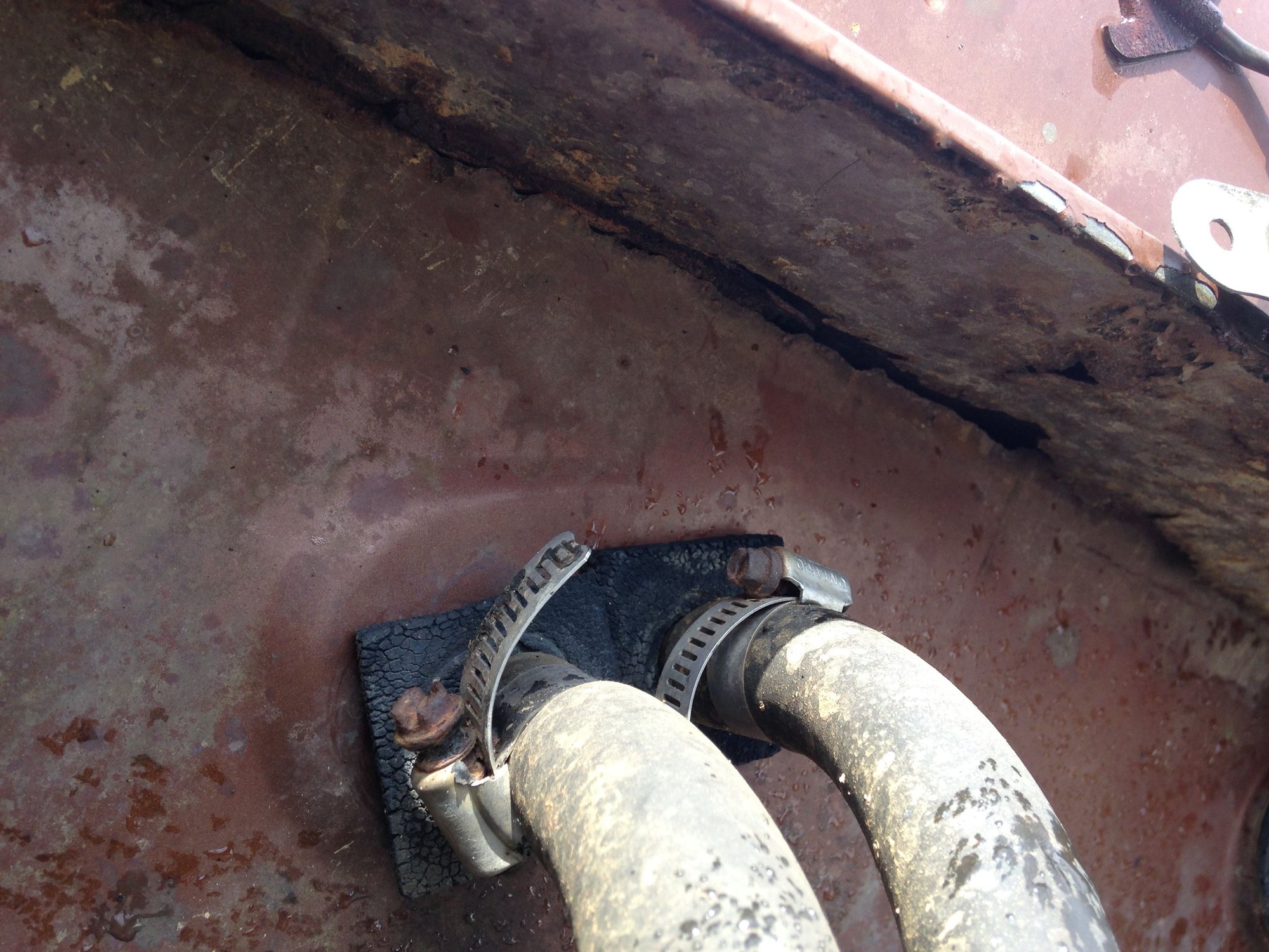

this is under the cowl beside the brake booster.
this is on the other side and its rusted the whole way from one side to the other like this.

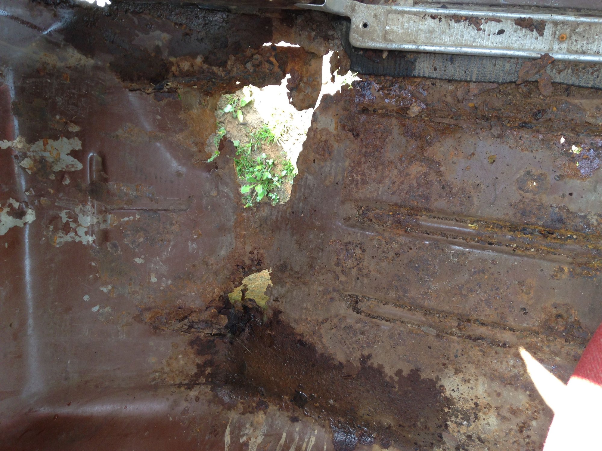

passanger side floor, yes its a big whole ik I was ticked and shoved a size 12 boot through it. it will also need both cab mounts

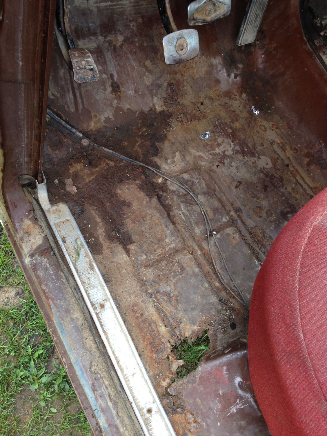

a few small holes in the driver side

Options for the cab: buy any reproduction metal you can, but the old out put new in. Then add sheet metal in where you couldn't buy reproduction/patch panels. Jeffs Bronco Graveyard, LMC truck, RockAuto, Dennis Carpenter all have replacement panels.
Option 2: Pull cab and find a replacement. Make sure t(if you're not reusing your doors) to pull the vin tag off original cab and install it on new cab. Fix what rust the new cab has, install with new body mount bushings connect everything and enjoy.
That cab is pretty rough, it can be saved but its a lot of cutting and welding. With allllll that rust I would check the roof right around the drip rails and windshield with a metal pick and see if it will puncture the metal. That's another bad spot for rust.
With time and work it can be fixed.
