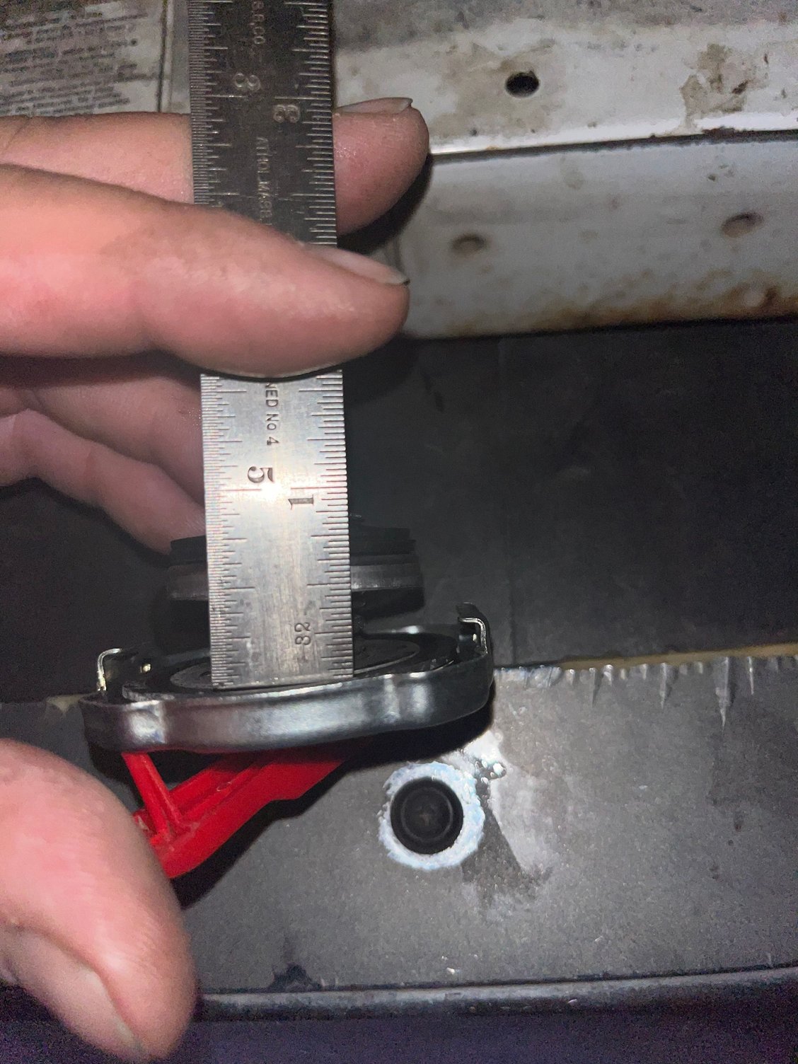

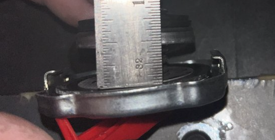

ok. Sorry for no pics, it was dark out last night when I was working on the truck, so no pics. The issue is that the seal to seal distance on the caps is 3/4 inch, yet the seal to seal distance on the neck is 13/16 or so. Just for ****s and giggles, I put 2 lower gaskets (that seal the pressure spring assy to the neck) and lo and behold the system pressurizes as designed. IOW, the neck is about 1/16 too tall for the caps. I dont really want to run it like this long term, as the small valve in the center that allows coolant to return to the radiator as the system cools is not able to properly function. This however seems a smaller issue than boiling over due to not pressurizing at all.
I have verified that the reservior is attached to the neck between the two sealing surfaces. there is a bypass hose that goes to the "lower" port below the sealing surface that leads to one of my heater hoses.
The radiator was advertized as "new" when I bought the truck, and as clean as it is, I have to believe this. there is no abnormal wear on the neck, either internally or externally, and the upper gasket seats and seals just fine. the only issue is that the radiator cap (as designed) does not properly seal the system below the upper gasket, allowing pressure to build.

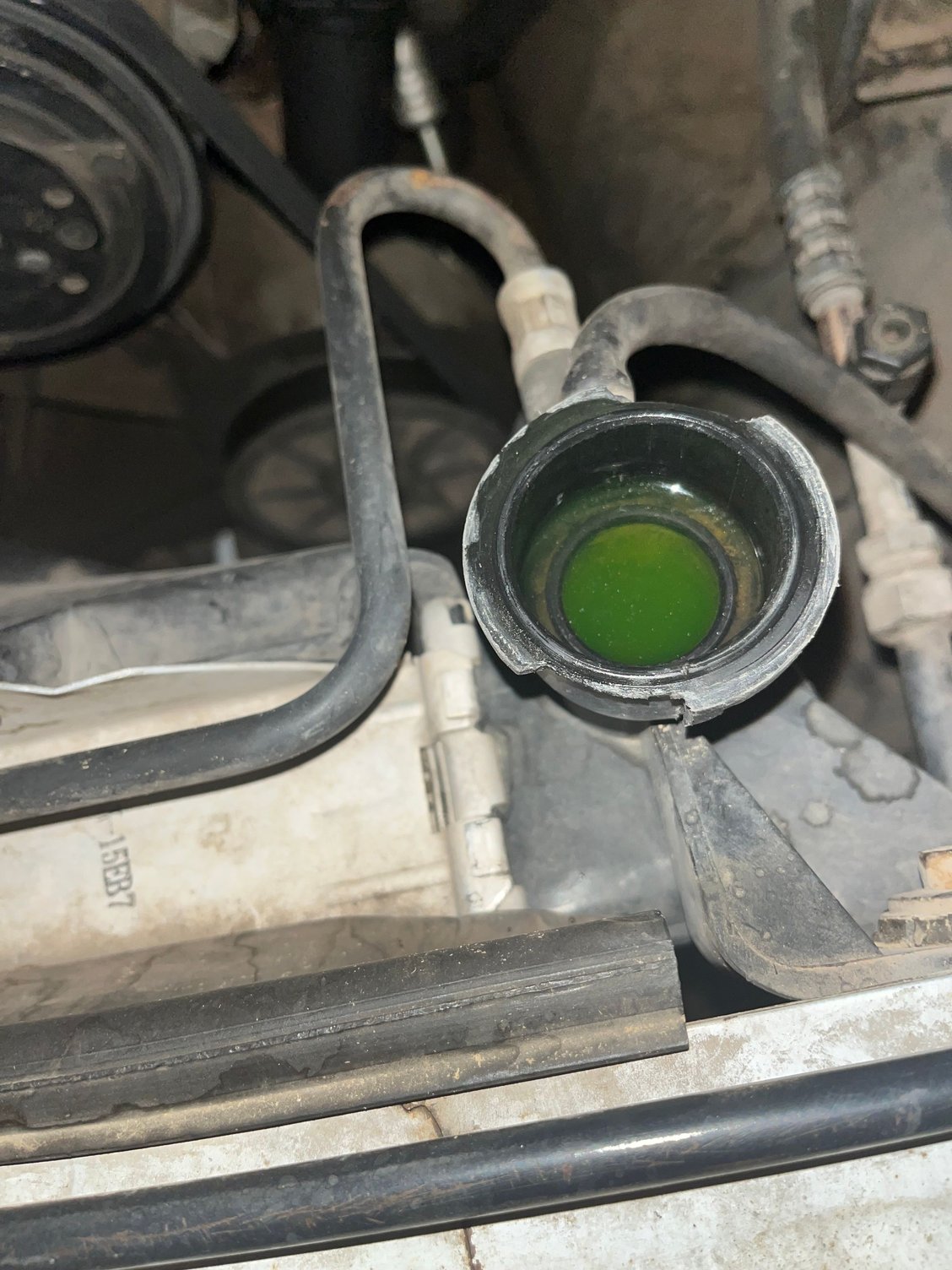

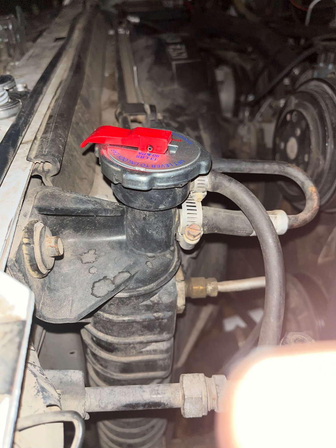

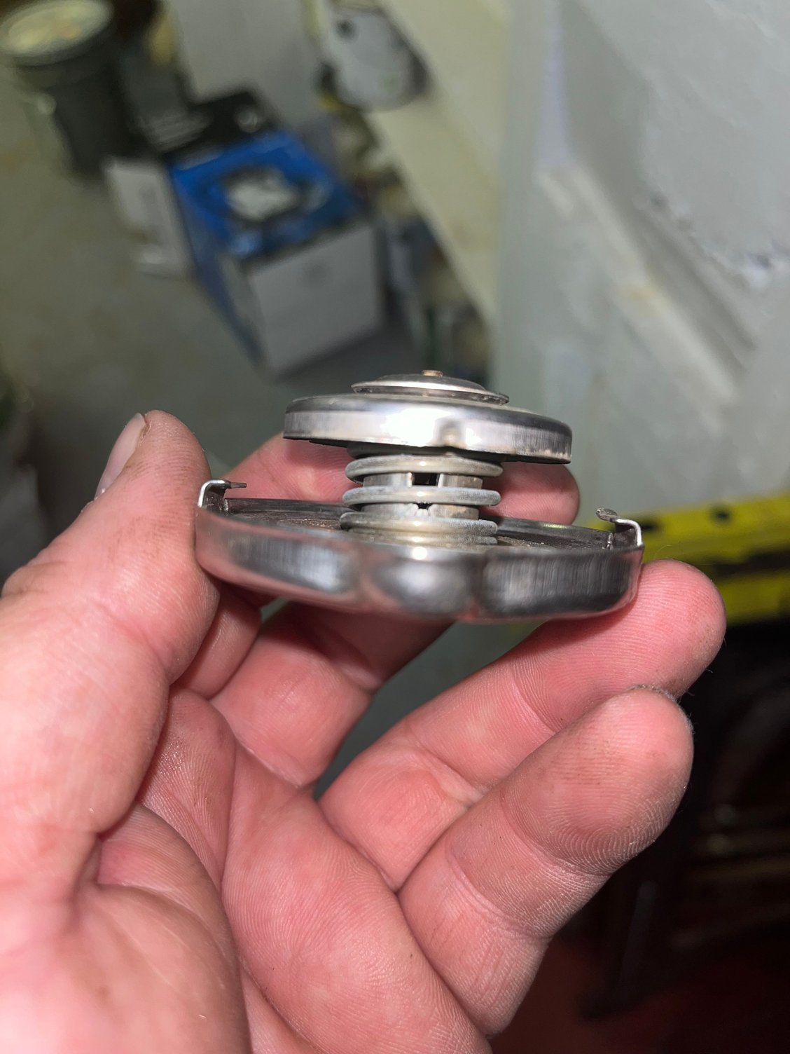

Ok, Sorry it took so long to get back to you, been busy in Court all day (freaking jury duty....). Radiator neck ridges are good. The tabs on the cap are good, its just that the neck is made too long it seems. Here are a few pics, dont know how well the ruler pics are going to turn out, but the distance on the cap from seal surface to seal surface is 3/4 inch, while the neck depth is about 13/16 inch. The cap I was replacing was about 3 months old, and there is no sign that the gasket was touching the inner neck sealing surface...
upper hose on neck to overflow, lower to heater hose
doubled gasket on lower surface. In this configuration, IT WORKS. the coolant from the overflow even returned when the engine cooled last night. I think Ill leave this well enough alone for right now, until I figure out why the seal surfaces are so far off
inner neck, no damage.
seal to seal height on the new cap. set up like this, it works great. its a bodge, but it works....
this is the cap I robbed the extra gasket from. Its about 3 months old, so shouldnt have issues. The tabs on this look proper, even bending them wouldnt help, it would just tighten up the upper gasket surface.

why does it look like there is an entire build up on one half of the flange of the neck? I use the same cap(presumably same on my engine as same overall size, same psi)
And Did you follow the caps instructions to install it with the lever up

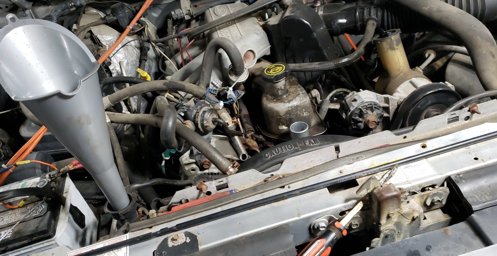

much older pic to see the inside of the neck a bit

cap installed lever up. as for the buildup, its likely just my crappy iphone camera with low light...... water level is right to the top of the neck, and the overflow is about 3/4 full from its little overheating temper tantrum a few weeks ago. When running with the cap off, there are NO bubbles coming to the surface, just expansion of the coolant as it warms up. I need to put a manual water temp gauge in this thing though, even when boiling over, the temp never went above the "N" on the idiot gauge..... if I hadnt stopped for fuel, I never would have known it was cooking off....

See the stuff on the rim? Under the ledge, across the very top of rim, on the outside perimeter. All I see is a clear as hell neck that your cap should fit in if you clean those parts up and check out your cap being distorted.
