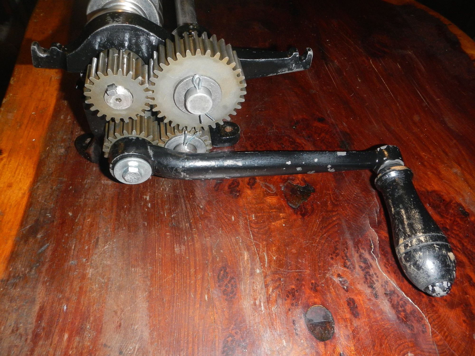

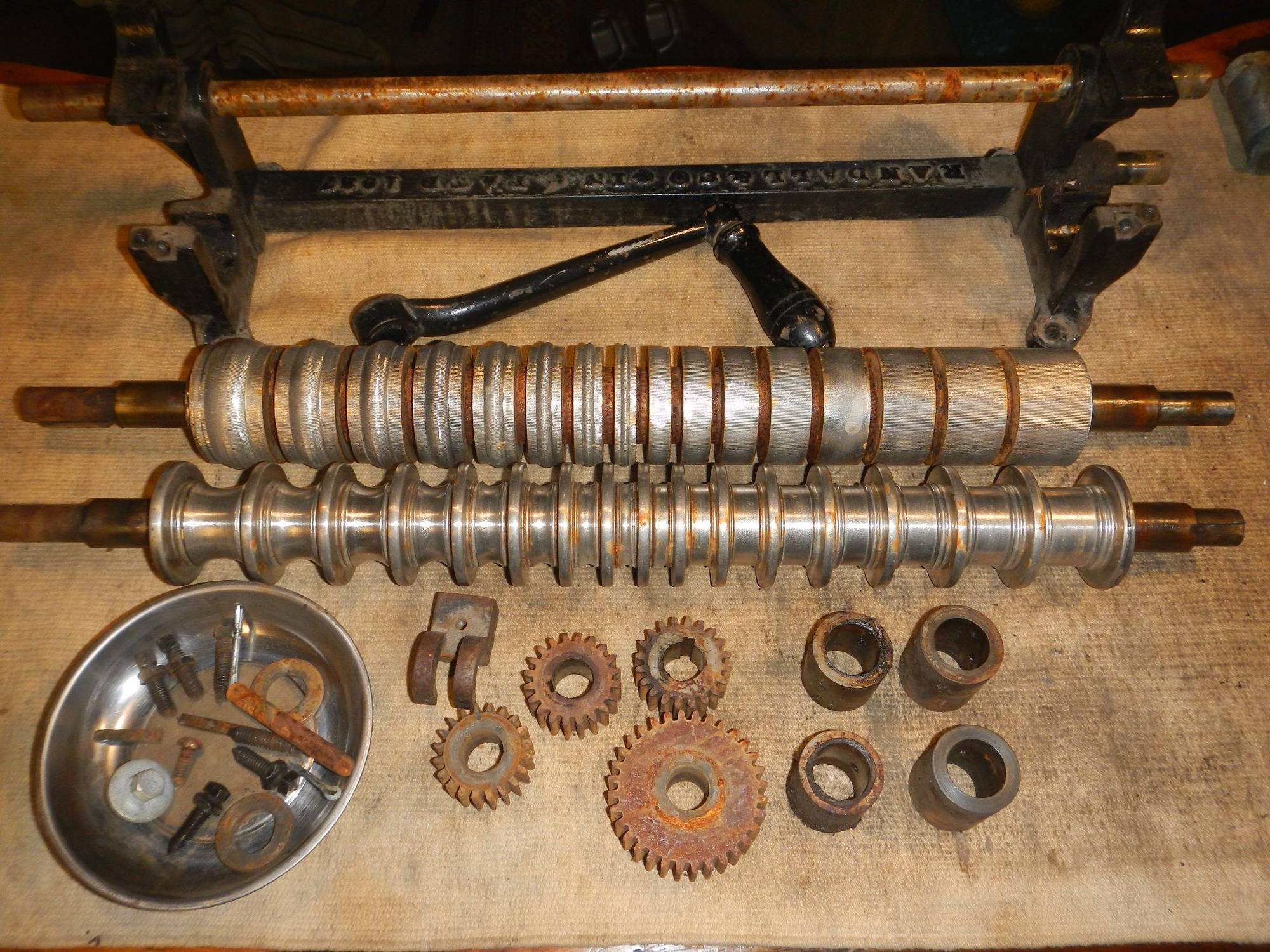

If you have rust under the chrome or paint don't expect it to stay attached. Other than that, I have not had any problems. After you rinse and dry you will need to either paint or oil to stop further rust. Here is a piece I recently did. Soaked all the parts overnight, no sanding or wirewheels.
