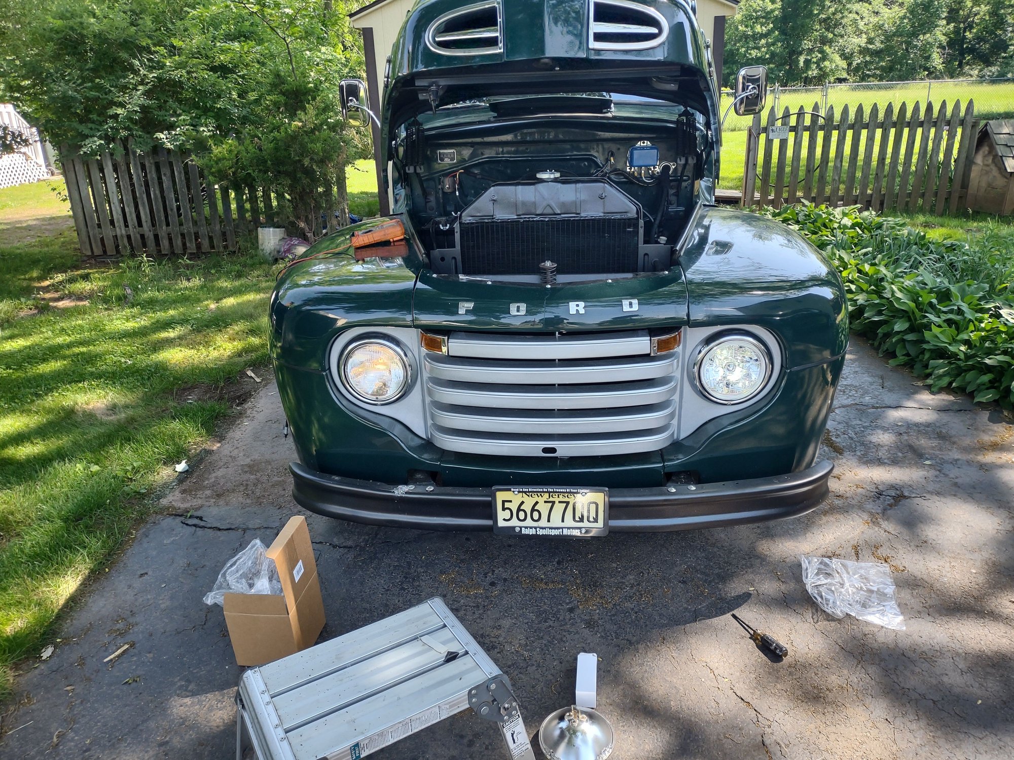

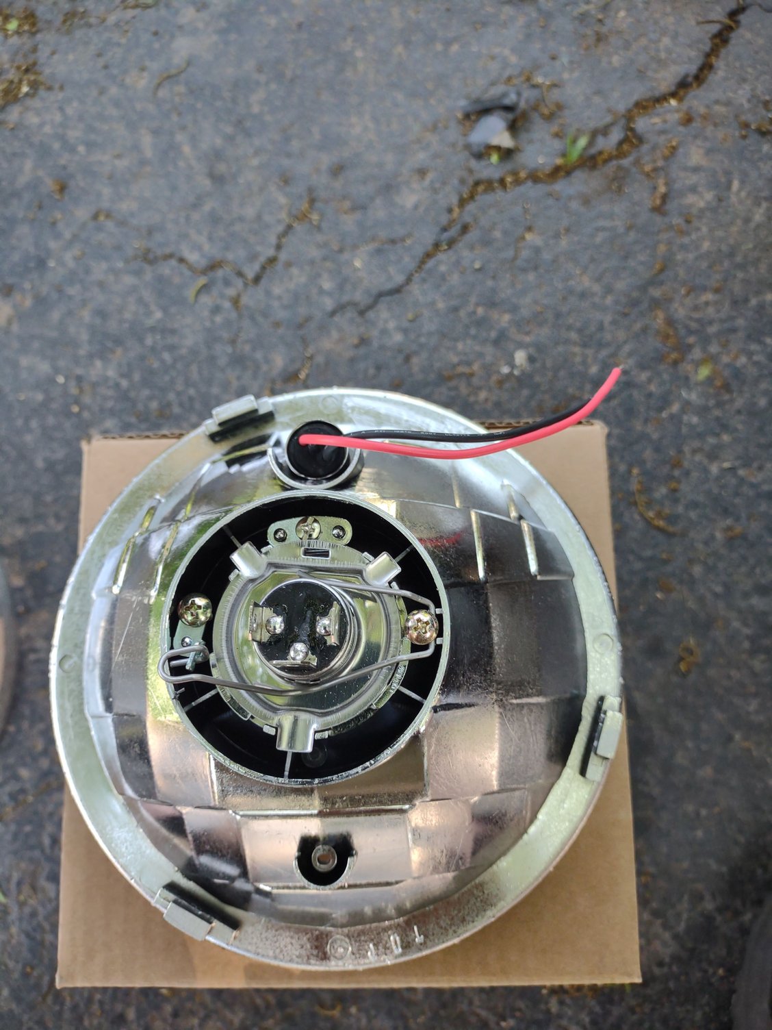

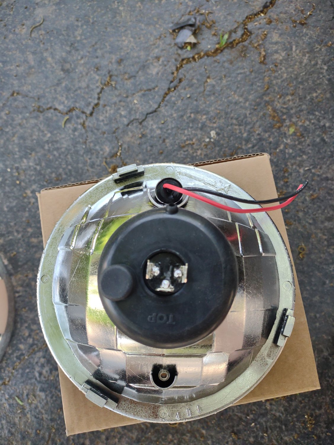

Some pics…
Empty housing
LED installed
Rubber gasket installed
One halogen and one LED
Both LEDs
