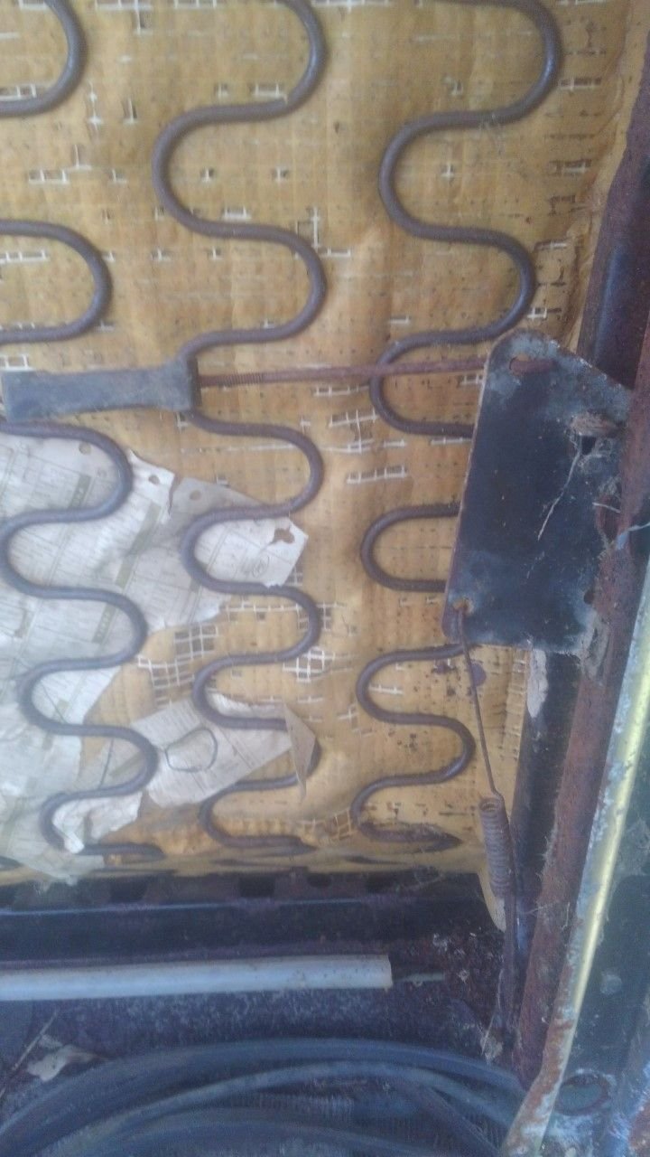

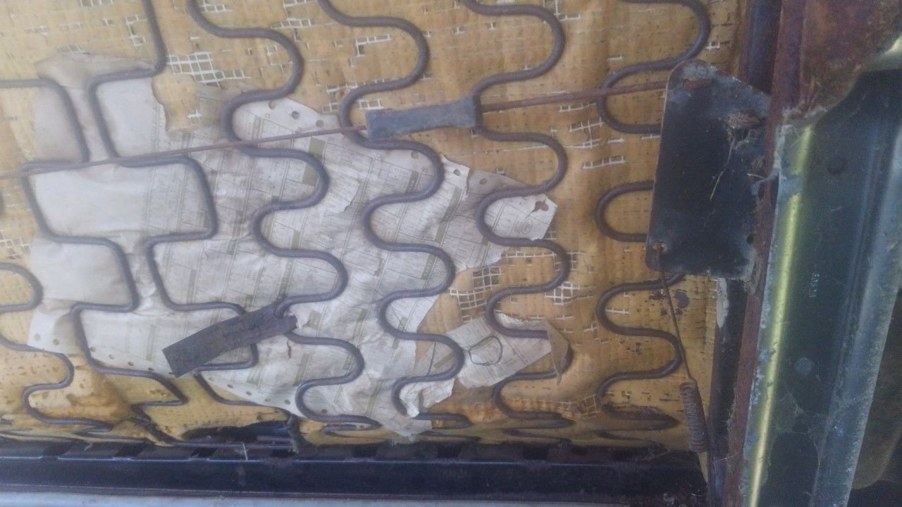

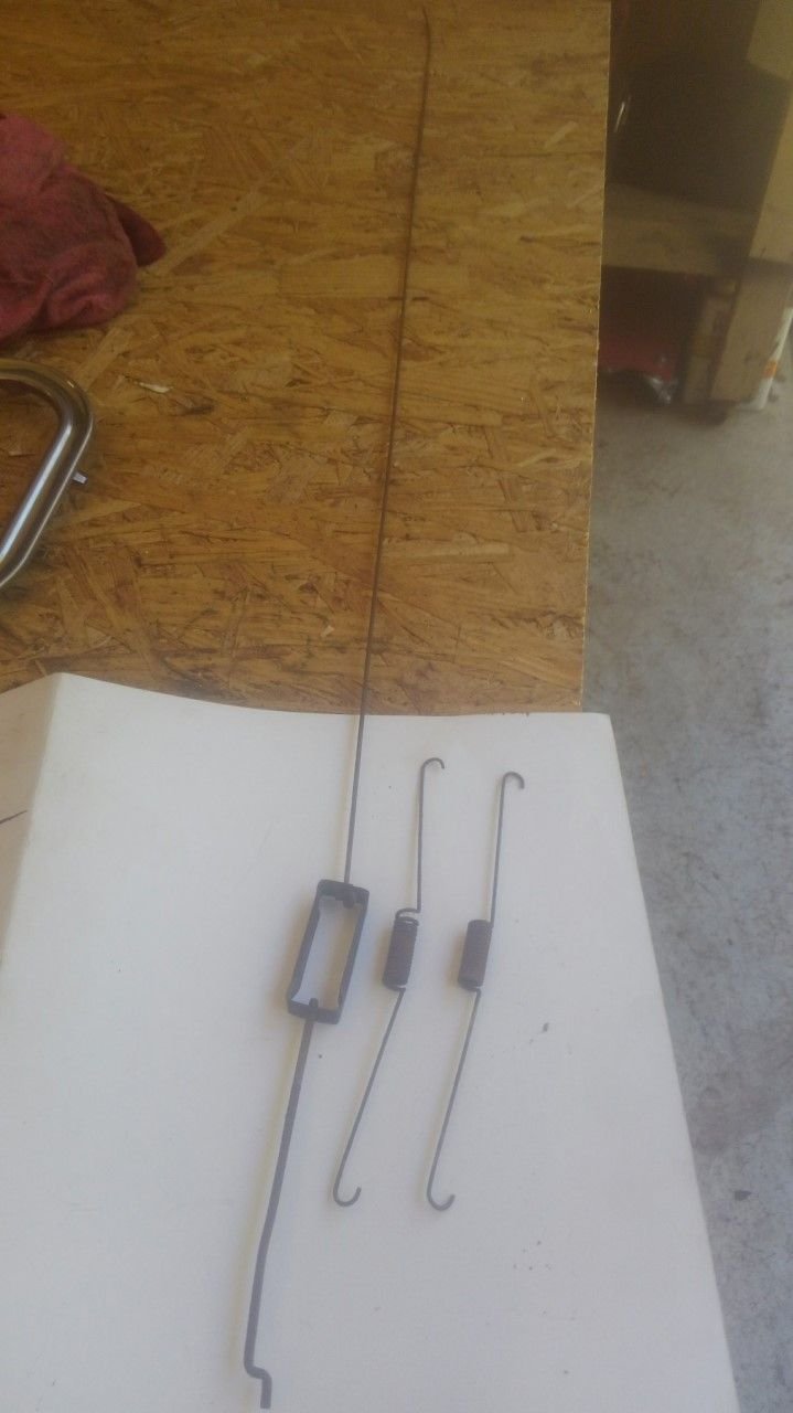

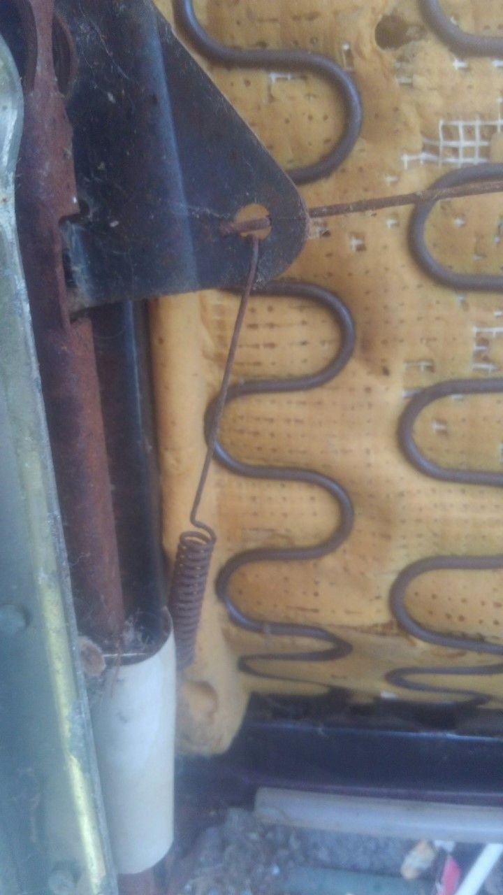

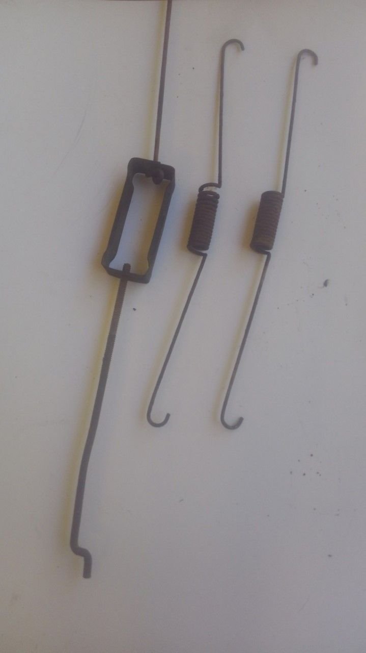

Old May 27, 2022 | 02:56 PM
77&79F250's Avatar
77&79F250
Moderator & parts slinger
Posts: 50,193
Likes: 5,793
Parts truck for pics and parts. And the build sheet and buck tag....Dvrs side
Close up of dvrs side
Passenger side
The whole shebang
A aerial of the whole shebang

Looks like what I'd likely need!
